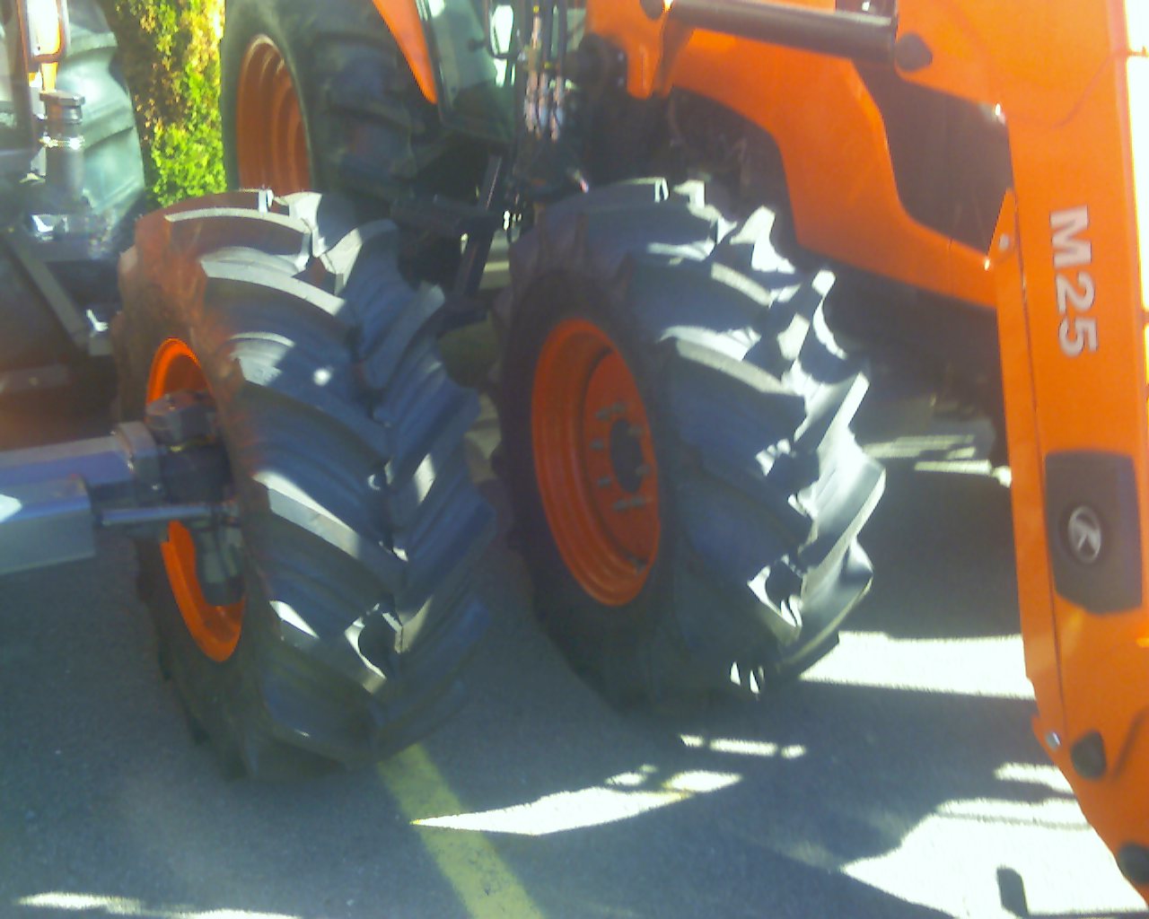

How common is to get R1 radial tires in the US? What's the main reason for the diagonal R1, other than the cost?
We get them in every tractor from SCUT up to big AG tractors. Besides giving a very cool look to the tractors, they also provide better ride and traction with less compaction.
43672058_2103734393024194_940488028395143168_o.jpg44787264_2103734349690865_3711948961859239936_o.jpg

Radials are very common. Actually, might be more common than bias ply. Especially on AG tractors.
I have Radials on my M9540. I really like them. Better ride. Better traction.
Canada has been using R1W tires for a few years now. They are just beginning to show up in U.S. I replaced the 12.4Rx24 front tires with R1W tires last Summer. Gained 1.5" section width.

R1 radial tires are used on this side of the pond on tractors starting at 25 hp and hp. HP is not an issue. It's just not common in the US to use Radials on tractors smaller than 75hp or so.
Here are a couple of Kubotas on radials:
And a Kioti:

Being that we drive the tractors a lot on the roads, these radials last longer and provide a better ride. Along with all the other advantages of radials, like better flotation, traction, better resistance to punctures, etc.
