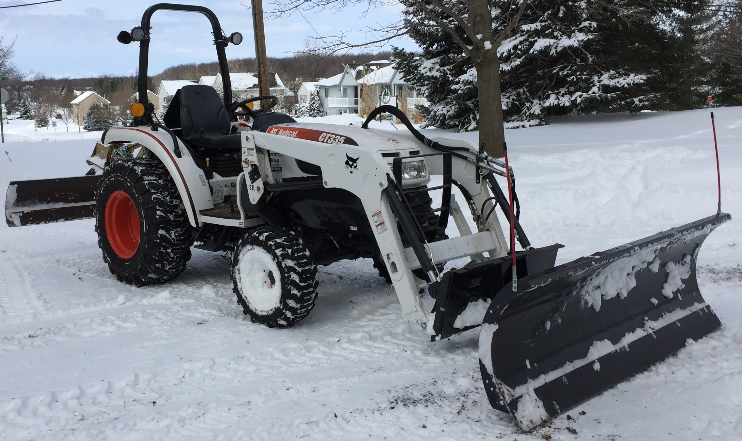

Trig will tell you that a 7 foot blade, angled 30 degrees, will cover 6 feet. A 6 foot blade will cover 62 inches.
   / Width of Snow Plow to Buy? #23
It's seeming pretty clear to go with the 7' over the 6'. Would you go any wider???
It depends some on usage. But, the 7' is the minimum to keep from driving over the white stuff that's spilling off the side of the blade.
With my previous 53 hp tractor I ran an 8' wide blade and it worked well. I could clear a wide path in 2 passes on my 600' driveway at our last house and never felt underpowered for the blade. On our current place the smaller blade suits me better because I'm working in more confined space and maneuverability is important. Sometimes a wider blade can also be a curse when you're around stuff, or pulling in and out of where you park it. Overall I think the 7' is a real good match for these machines though.

I forget the actual numbers, but I believe a 7' plow angled at 30 degrees is 6' wide. Wide enough to clear your footprint by 5.5" per side.
I run 7' front and rear plows on my L4060 that is 72" wide at the rear tires. I am rarely at a 30 degree angle though... Generally just barely angled
   / Width of Snow Plow to Buy? #25
I too do not normally run my blade at the full angle. Half angle gives me more width and doesn't want to steer the tractor as much.

Not sure what the area your looking at plowing or your snow falls but here are my thoughts. A 6' blade at a 30 degree angle will clear 62" so you might not run it at full angle, an 7' blade will clear 72". If your planning on leaving the blade on with the blower I would get the narrower blade as it will be easier to run with a rear blower. However if your just looking at cleaning up light snows then I would look at a 7' or larger. One method with lighter snows is to plow one way then reverse back with the blower getting rid of the snow berm you just made and finishing clearing the drive to full width if possible in two passes. If you have open areas such as parking pads I would consider an 8' as it will clear 83" at full angle or 8' if straight. However it will reduce the depth of snow you can move with it.

FYI to figure out the track width of an angled blade:
Cos(angle) x blade length
The angle should be in degrees, and make sure the calculator is set for degrees, not radians.
To use an example from this thread:
A 7 foot blade angled at 30˚
Cos(30˚)= 0.8660
0.8660 X 7 = 6.062 ft or just a shade under 73 inches
