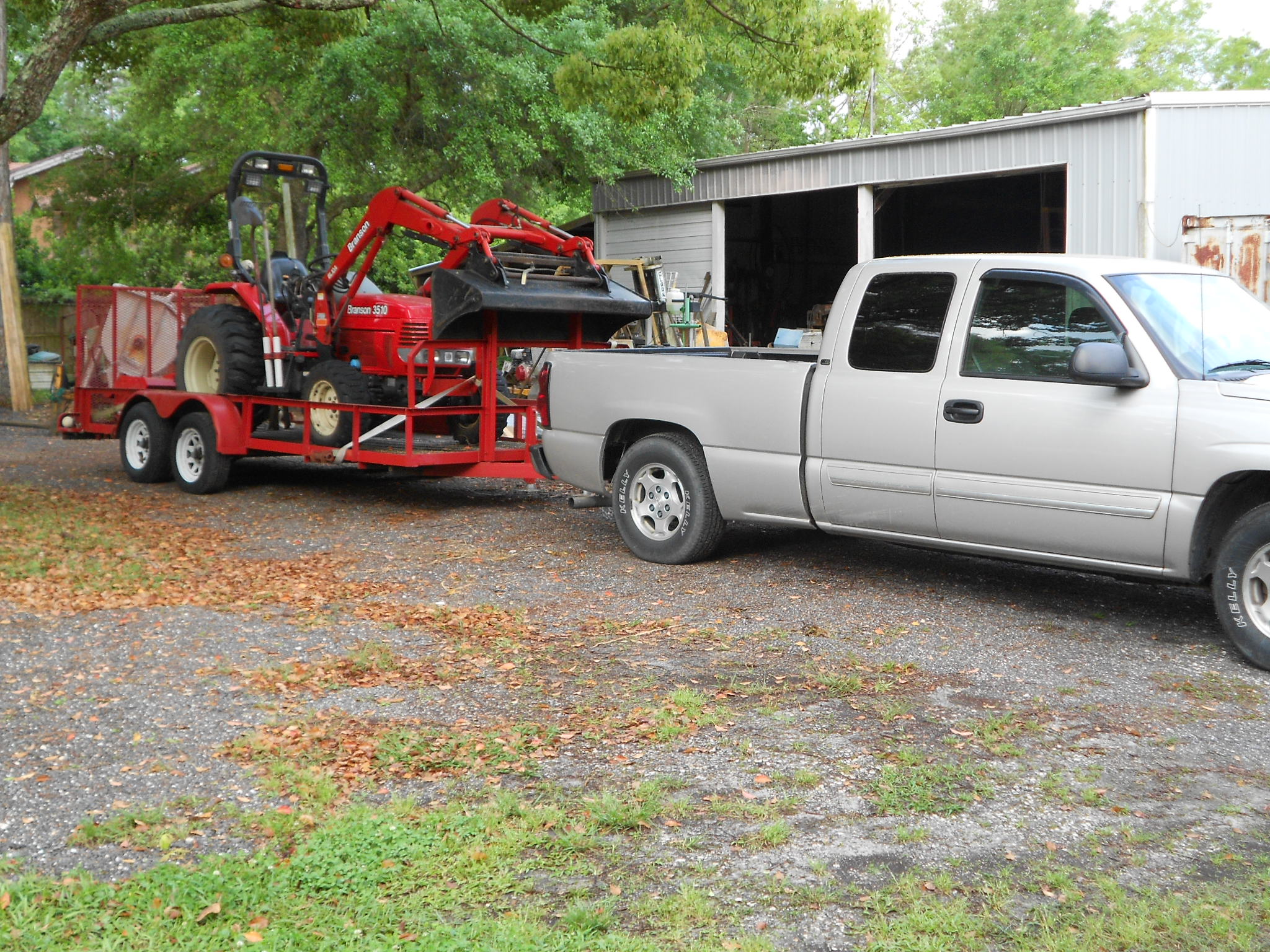

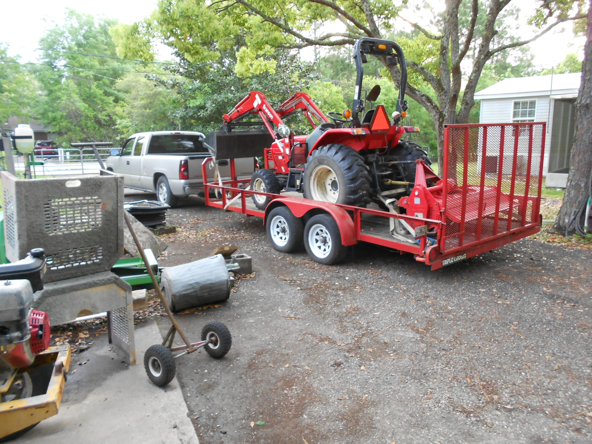

Here is how I loaded my 3510 Branson on my 16' trailer.
This trip I put the bucket on the bulkhead and had the tiller on the rear.
I have a Backhoe Attachment for my tractor and when hauling the tractor with it on I hang the hoe bucket over the tail gate with no problems.
