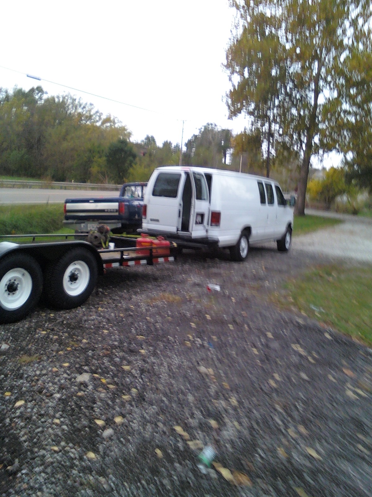

You guys will laugh but local rental place rents ford E250's with hitch for under 100 per day unlimited mileage they all have the v6. I make runs to Georgia, TN, Texas, MO, IA, and where ever in these all the time as cheaper than running my trucks. I ussually pull my tandem axle trailer it is equiped with 2 6k axles and brakes on both I bought a plug in for the control that will hook in rentals wiring(hope they don't follow this). More than once I have put 1400 miles and had it back in less than 24hrs. The lady at the desk always goes back and checks the mileage and comes in with a puzzled look on her face.:confused: Most of the time its a small load of ebay tresures or burned up insurance claims.
I would not hesitate to use your van with your tractor and trailer unless you have big hills in your area.
Yes saftey police I have 2 drivers on long trips and alway read the speed limit signs:D
