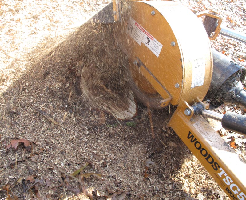

hey i dont have an actual list of what i ordered. i didn't keep that info. i can tell you i got a prince 2 spool valve assy with the power beyond sleeve. elbow fittings for the cylinders, all the hoses and reducing bushing. basically all the plumbing. also needed a few quick disconnects. instead of mounting the valve assy to my tractor as a rear remote i welded a mounting plate to the frame of the grinder and mounted the valve to it which puts it just under chest height with it dropped down on the ground for use. i just did the hyd as part of the grinder rather than the tractor. here is a good pic of it in action. this particular stump, at ground level, was about 24". i took it from 8" above ground to 4" below in under 5 minutes with only a bx24 for power.
