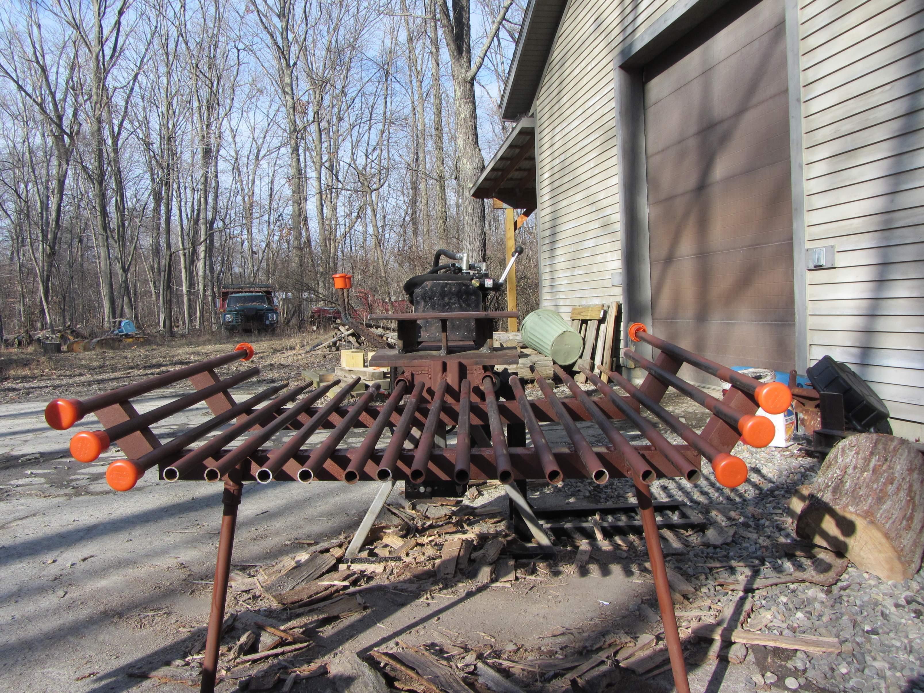

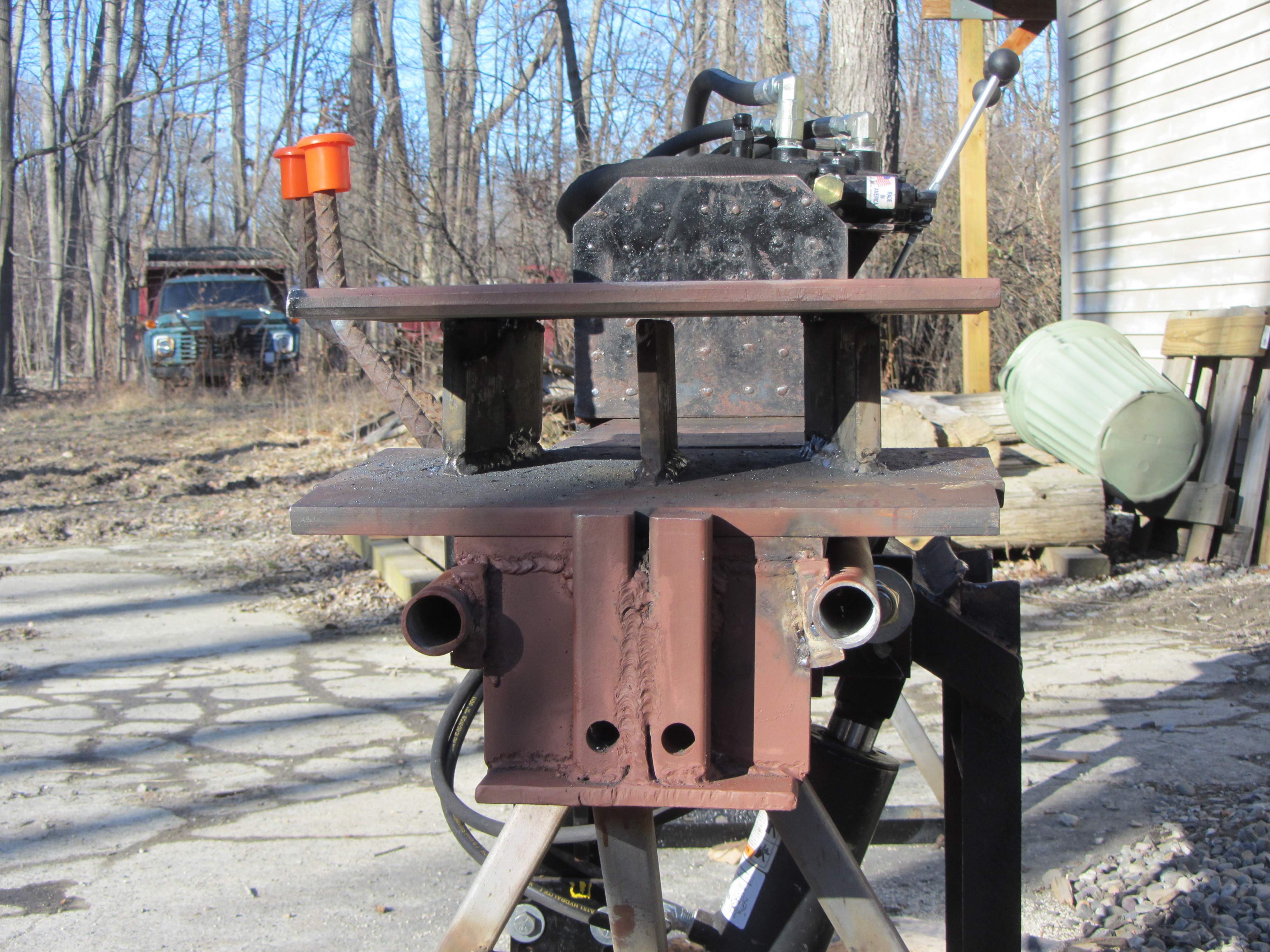

yup outside wedges tapered on outside only. Middle both sides.
I turned my scrap piles upside down looking for a piece of 3/8 plate. Not one piece. Plenty of 1/4 and 1/2. So I made the center wedge from 1/2. Probably better anyway.
I welded the wedges to the bottom and tacked the top. Let it cool till tomorrow and unbolt it , turn it over so I can weld down. It does not look pretty but I got some bevel on the wedges and used 5/32 6011 at 165 A. I know it got right down into the root. The first passes looked good. The follow on passes look terrible but there are less blow holes than I have ever had . Some under cut but in 3/4 plate I don't think it matters much. I was almost going to take this someplace to get it welded but then that's why I have a welder. If this one blows up I will take it someplace. I think there is a lot less stress on the wedges with this design.

I think you might be a bit high on amperage for your 6011?
How many passes are you running for your cap? Id probably run 3 to give a nice, fat, smooth weld to keep the wood from hanging.
Have you tried 7018AC on your machine?

I only have a rotary switch 145 or 165. 145 does not seem to give enough penetration on the 3/4 plates. Probably just my technique. I was trying for 3 passes but it kinda ended up two. Maybe I should go back to 1/8 for the overpasses. I can always grind to smooth it out. I had some 7018 but it did not work well. Maybe it was dc rod. Box does not say. This is the first time i have welded 3/4 plate.
Usually 1/4-1/2 and structural shapes. lot of people have mentioned 7018. When I was down at the welding supply place at the beginning of this project I told him what I was doing and mentioned 7018. He said it was not really necessary. I should look for some and try it. The box is really heavy . I handled it with a chain falls when it was inside. Now I will have to use the FEL.
Tomorrow I will unbolt it and turn it over to weld the top. Always hard with one person. I never mentioned this before but I have done all of this by my self except picking up the beam , the first day. I only have a Subaru. That's another long story.

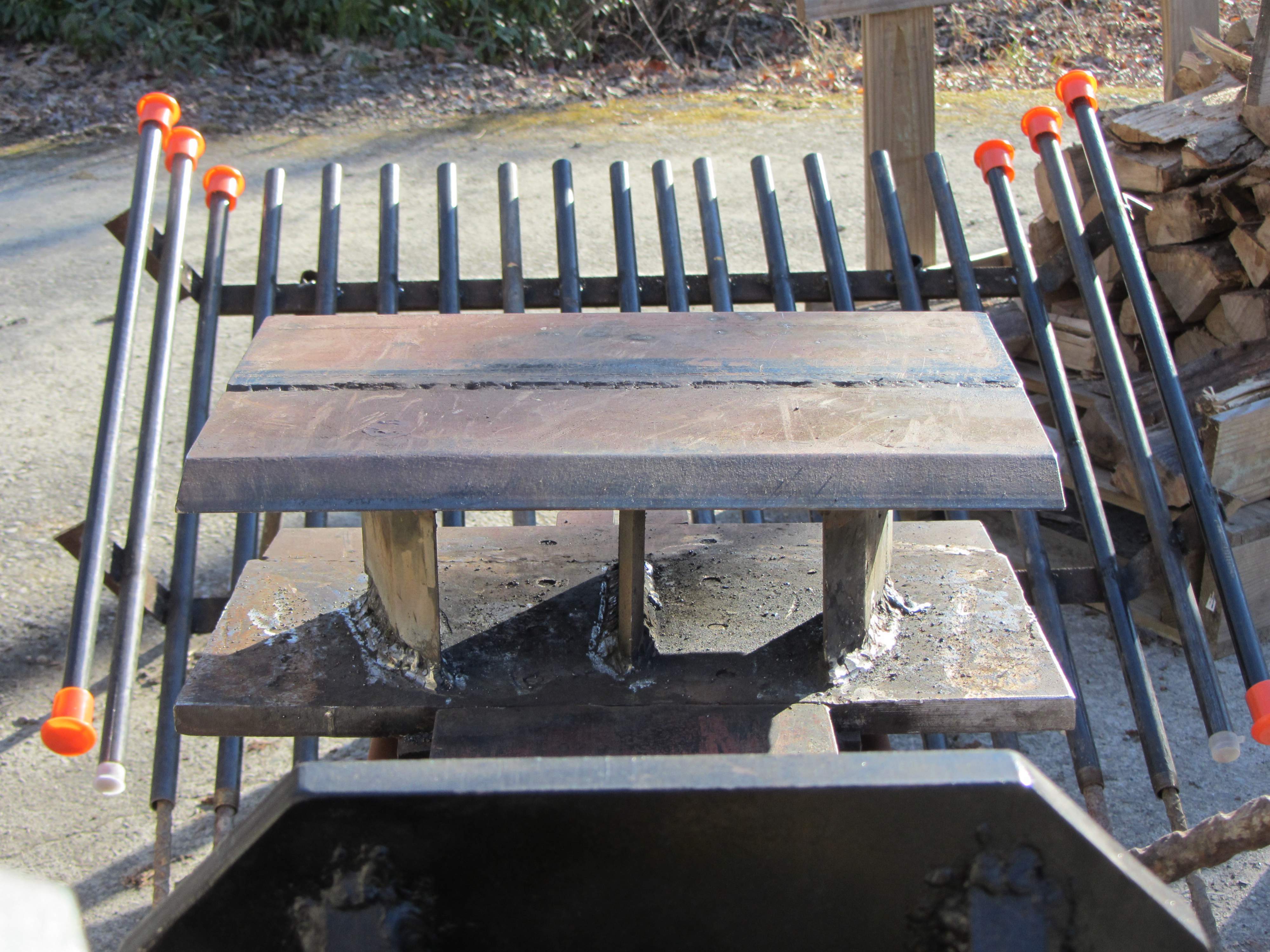

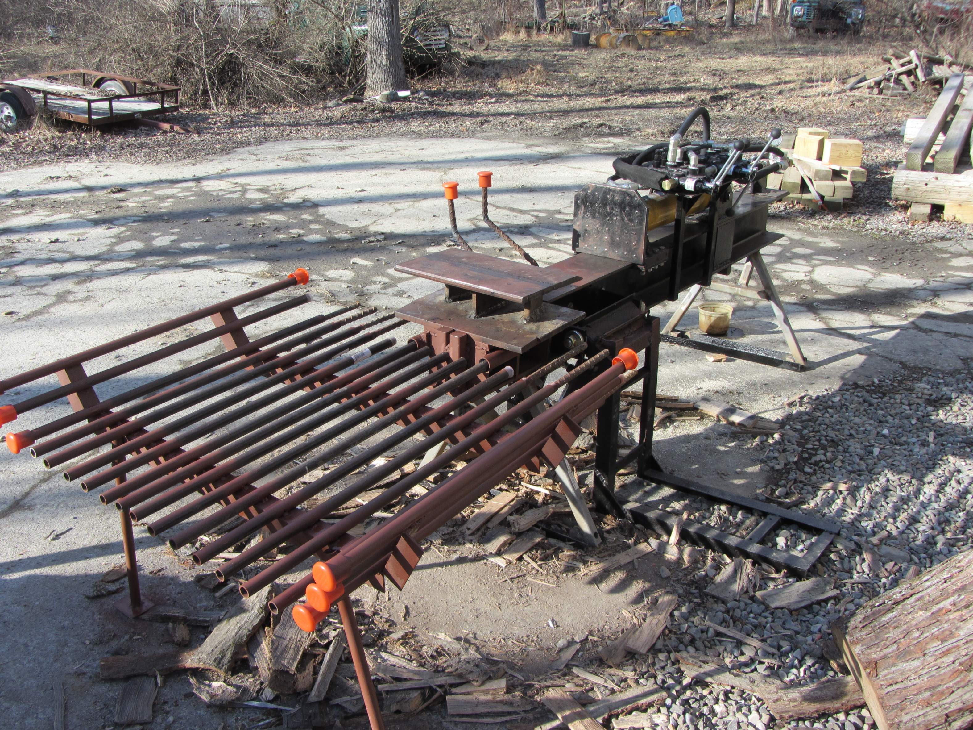

It's all ready to go again. I beveled the wedges, used 6011 5/32 at 145 A for the root weld. 160 was too hot. I think that really worked well. The over passes I started with 6011 but then said What the heck and tried the 1/8 7018 at 100A . It's a little different. Sticks a little sometimes. But lays down really nice and less porosity. I tried to fill under cuts and get 3 passes over the root. Funny I practiced on bottom plate which I had welded together with bevel joints at the beginning of this project. I filled in the top of the weld with 7018. IT worked really well nice dimes . But I still have trouble in the corners with the fillet welds. Very hard to keep an even fillet. So I have less porosity but lots of bumps .
Well, the proof is in the splitting. Tomorrow afternoon I think.

Sounds like its coming together.
There is a reason that almost everybody loves 7018.. with a little more practice, you likely will too.
