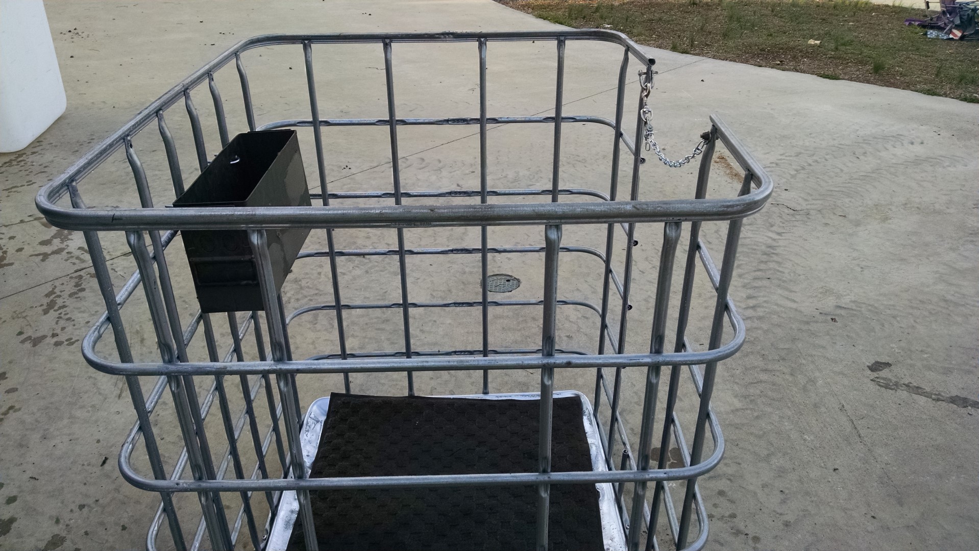

In most cases OSHA requires you to have a safety harness attached to the lift as falling out of the lift is a much bigger threat than hydraulic failure. The simple fact is that most common cause of injury and death from falling involves ladders. I understand other people have different experiences and concerns but a hydraulic hose failure is no more sudden or dangerous than a ladder footing giving way.
   / Work platform for the loader. #24

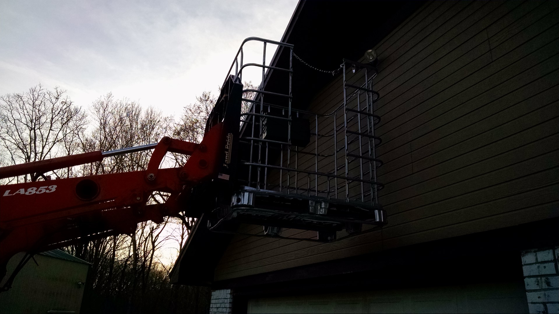

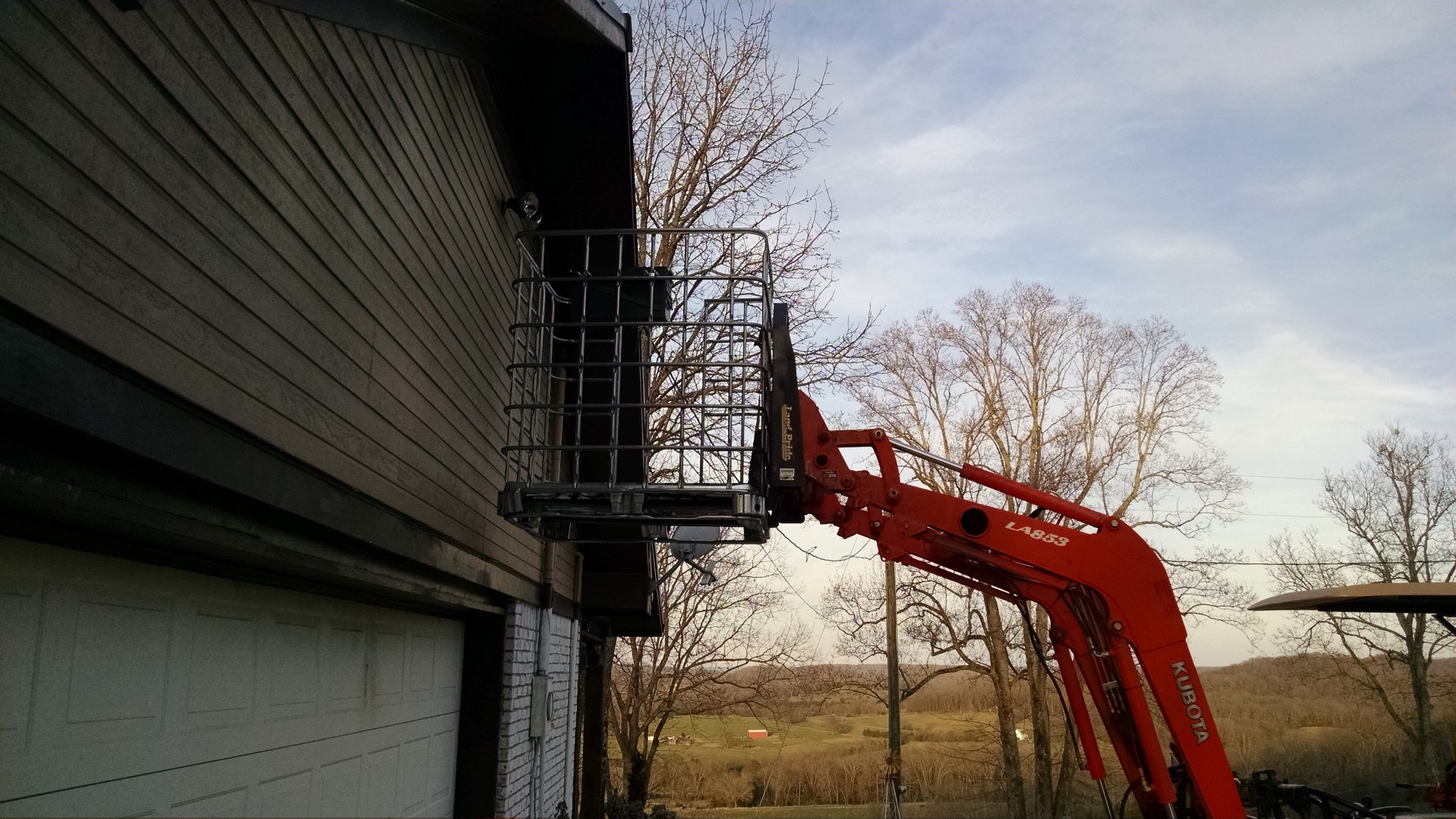

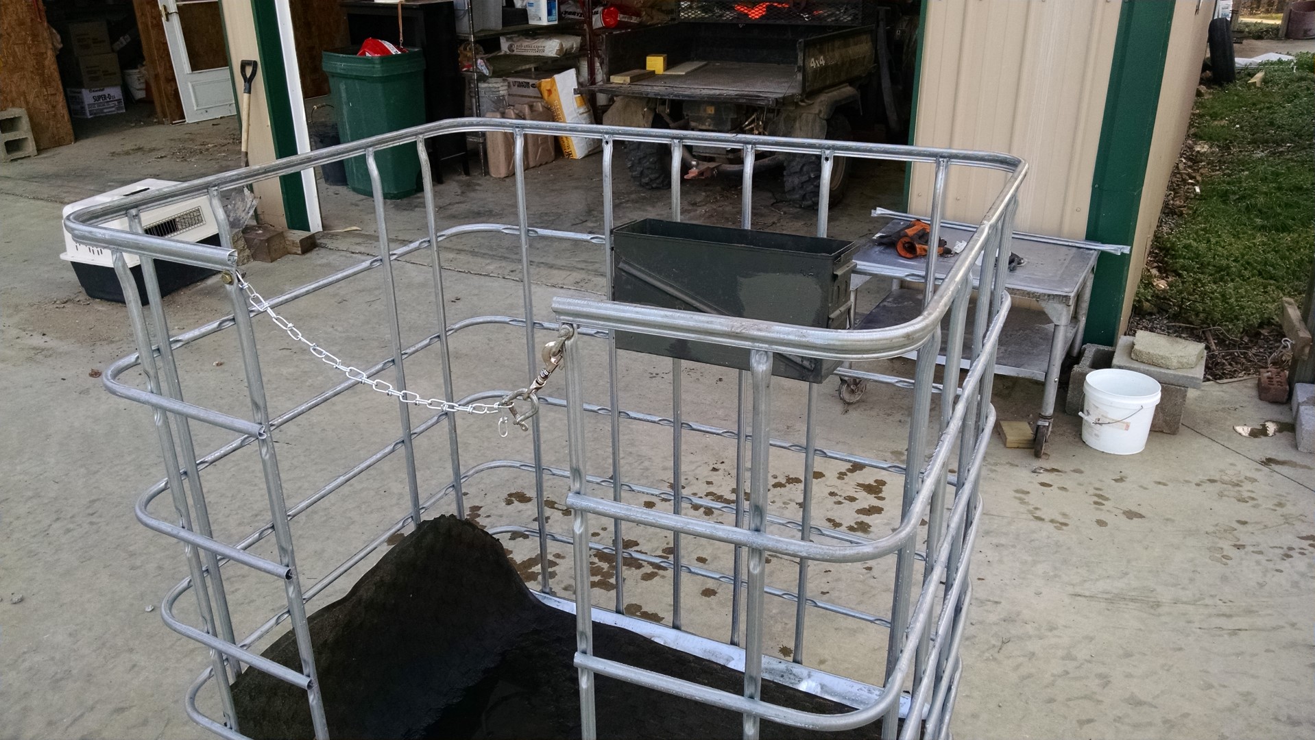

And that's why I built my work platform. To mitigate the hydraulic failure issue, I put a 4x4 timber under one of the lift arms; the same one I use when I need to lift the FEL to service my tractor.
Pics:
IMG_20170304_165917131 (Large).jpgIMG_20170304_165923801 (Large).jpgIMG_20170304_170650113 (Large).jpgIMG_20170304_170706935 (Large).jpg

A lot of those manlifts are considered mobile scaffolds. If they have the proper height railing all the way around, OSHA does not require a harness, though your company can require one.
Hydraulic cylinders for personnel lifting also have orifices screwed directly in the cylinder to control the fall speed if a hose does fail. But that is not going to stop a mechanical failure, which is what sounds like happened in the previous story of the guy hanging on the conduit. If the lift was "in pieces" below him.
   / Work platform for the loader. #26
Try not to hit the end of the lift stroke when someone is on the loader platform. The spike in pressure would be the most likely cause of a hose failure.
   / Work platform for the loader. #27
Pallet forks with a matching grapple, it does everything two separate tools will do. Add a apple box and you have a GREAT platform to work from,
The grapple locks it into place so it's safe, it get's used for a lot of jobs around here...

My variation on a familiar theme. This one is held together with c clamps because it offers me another level. I can run it with just the bottom basket or the top basket fastened to the bottom. It works just great for us. I hold it fast to my forks with either straps or chain and binder. It is so handy for everything including a cleaning of the owl box at the end of fledging.
