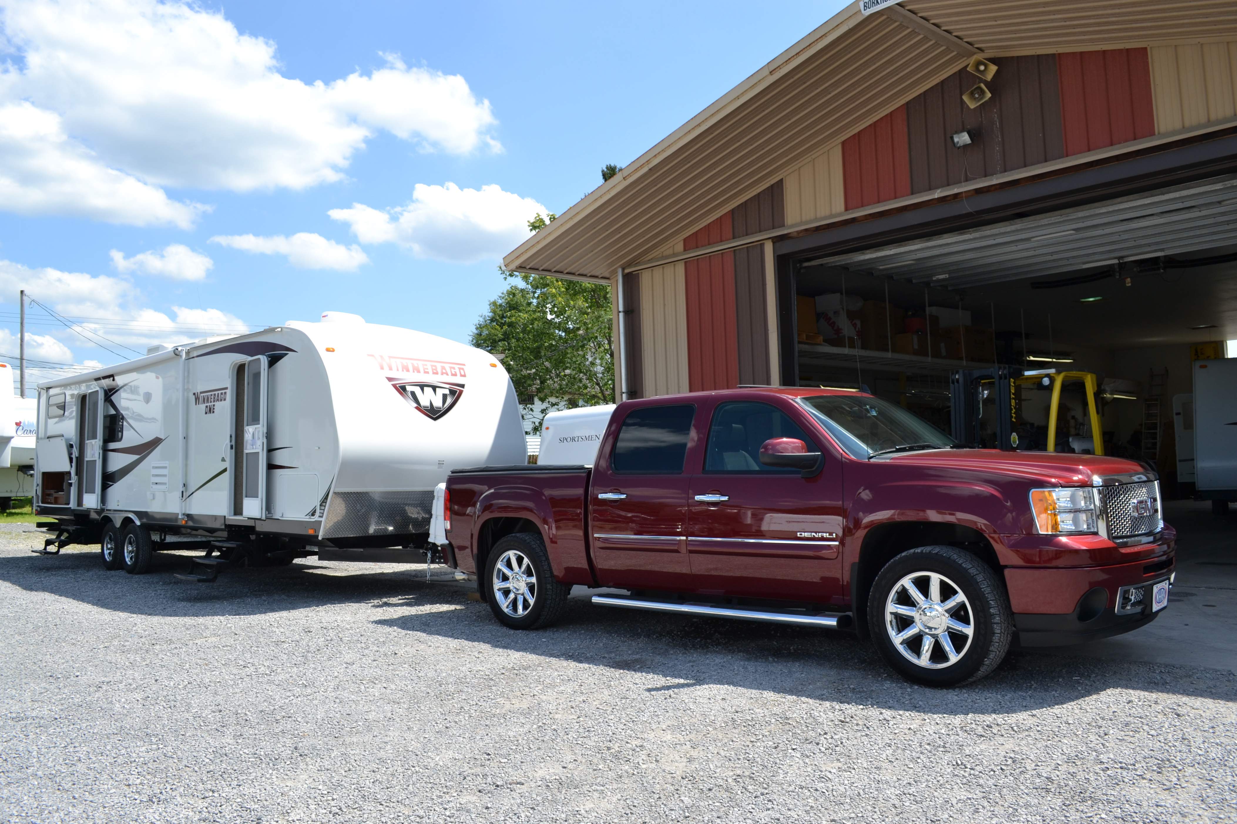

Do you really need the added expense of a diesel with a 5500# trailer? I pull a 7800# (dry) trailer with a 6.2 1500 4x4 GMC Denali and it pulls great...I'm a huge diesel fan, but the gassers are something else nowadays...
I have 3:42's and a 6 speed..Get 16 on average driving like an adult..14 with a heavy foot. Will do 18 empty on the interstate at 65mph...For the HP and performance, I really can't complain.
My last truck was a 6.2 GMC but not a Denali...not sure if your hitch would fit into a 6.5 bed which is what they had pre '13 on the extended cab..An 8' was available but that makes a tough multi-purpose vehicle.
So you know what I'm towing..32' BP TT as I was ready to head into the PA mountains from the RV dealer.
