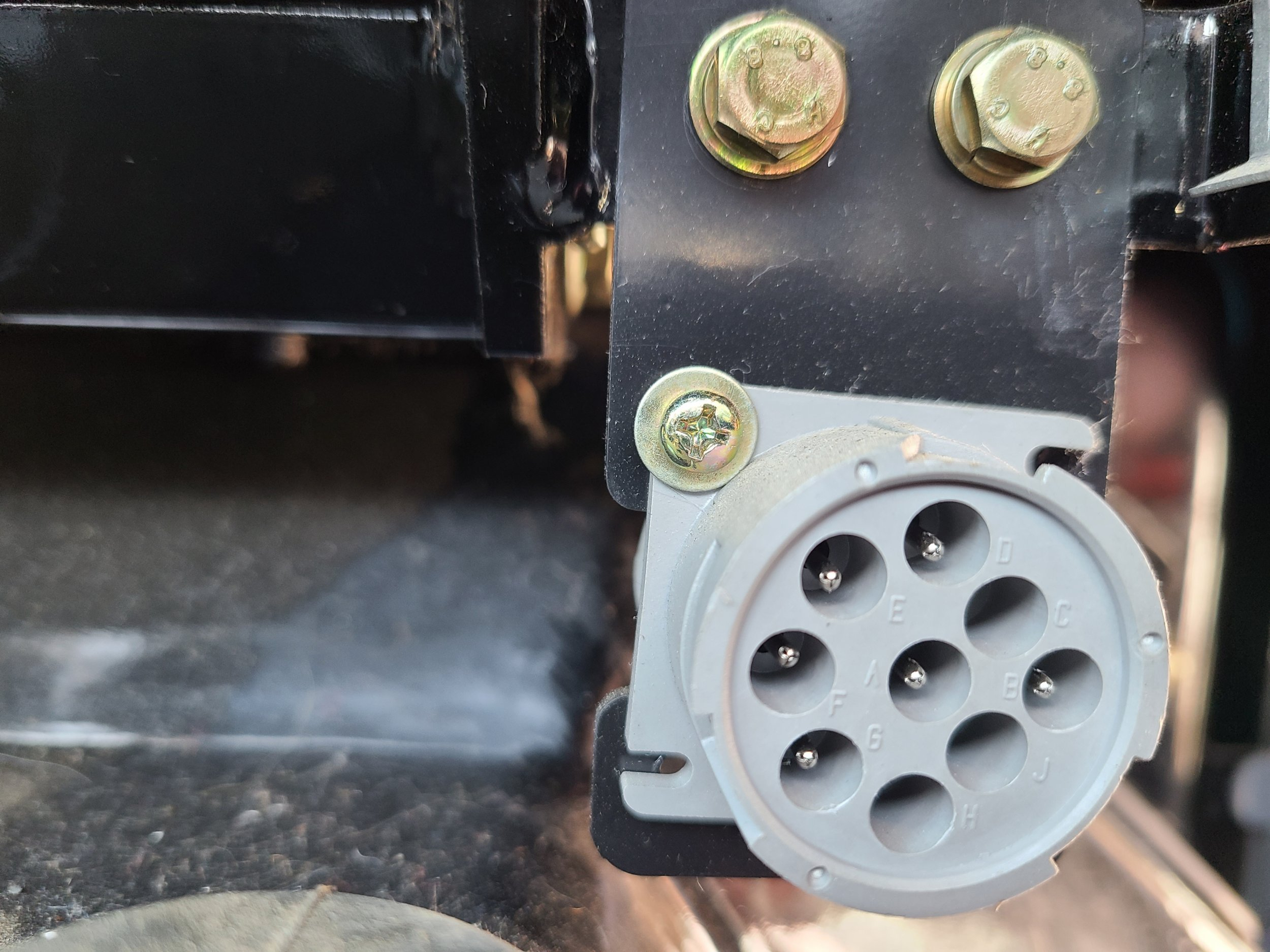

Is there anyone that sells code scanners? Looks like my dealer will not come out to fix my tractor. Nice support!!! If I can figure out what sensor is bad I can order parts from Seattle and get Betsy running again.
   / XR3037H RPM up and down after a few minutes of operation. #36
So far, only the LS dealer scanners can read codes. I found a program that will let me take a snapshot of my running engine but that's about all it will do. There is a whole other thread on scanners for LS tractors.
#37
Bought the Nexas NL 102 scanner but need to find the right adaptor to hook it up. Grandview sent a GES031A adaptor but it's not the right one. The pins fit but the actual connection is wrong and the scanner shows no connection other than low battery code. Anyone know what adaptor will work?
   / XR3037H RPM up and down after a few minutes of operation. #38
Here's a link to the cable I bought that will connect to your LS. It doesn't have a keyed pin
#39
Thanks George2615. I noticed the adapter only has 4 connections. My tractor shows 6 connections coming out. A,B,D,E,F,G. Will this work for me? 20220426_093259.jpg
   / XR3037H RPM up and down after a few minutes of operation. #40
yes, the connector link I posted will work. Not all 6 wires are used.
