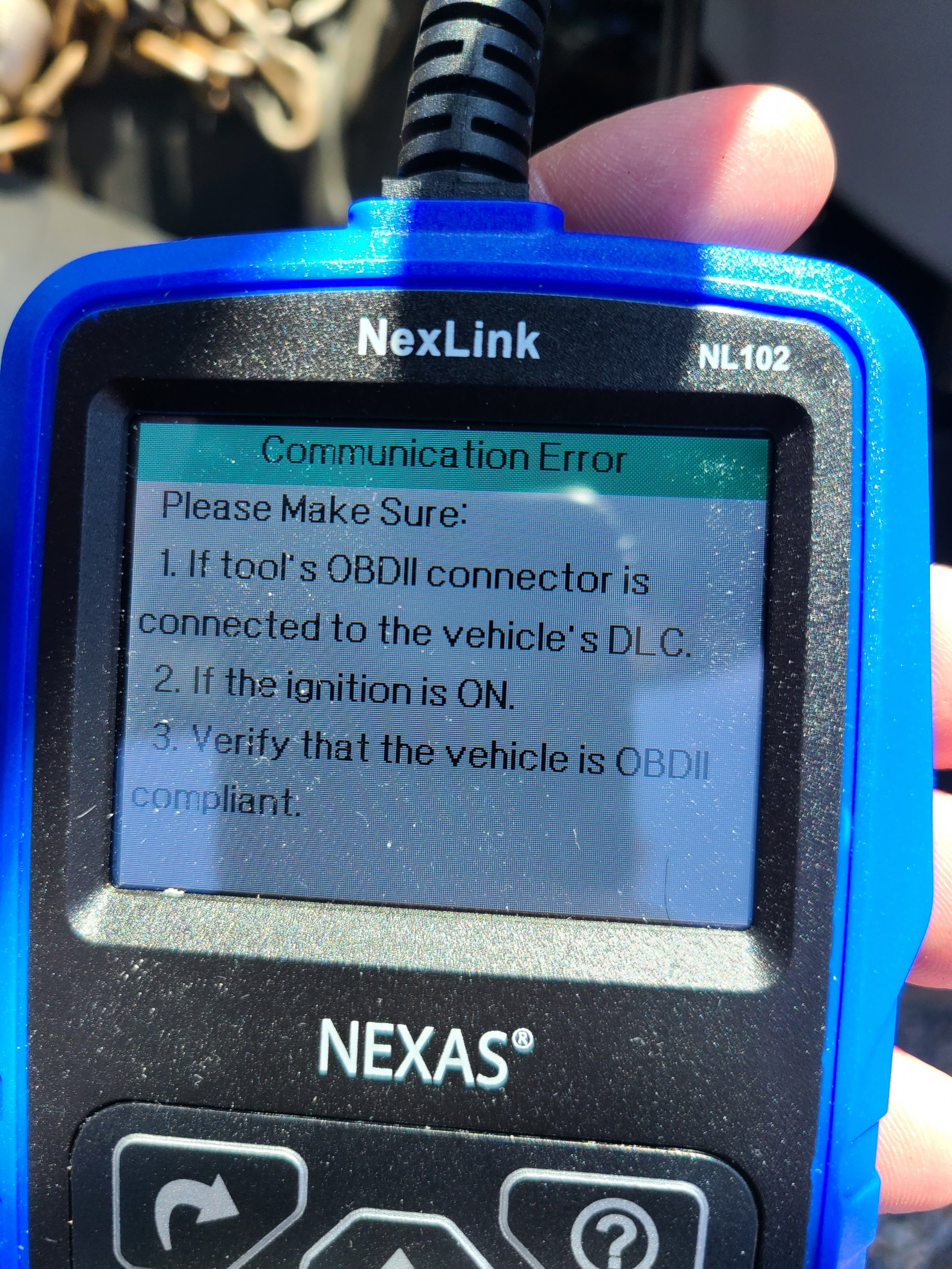

Got the adaptor and still getting a connection error. Also reads a bad barrery on the screen. Still dies before it re gens. Does a bad battery effect the diagnostic tool? Tractor starts just fine.
I'm not familiar with your Nexlink or how to set it up. I use an ELM plugged into the port (bluetooth connects it to my phone) and used a program Cummins Fault advisor (free download). It will read a lot of functions and most show a numerical value which I can take a snapshot and download on my computer but did not see any way to read or clear codes. I've pretty much given up since it seems all the stuff you want to read or reset is dealer only.
There is a company or two that do sell tractor diagnostic tools but the cost is $3500-6000 depending on which one you buy. Way to rich for me. I'll just have to save up for the day I have to take it to the dealer for a problem. I'll probably jinx myself but I guess I've been lucky with no problems the past 8 years.

Can you send me info on the ELM? I'm dead in the water unless I can figure out what I need to get this hunk of iron runnining. LS said they can't do anything about the dealer support from Daves Tractor up here. They basically said it's my problem. I just need to know what parts to order to fix this thing. LS dealer in Spokane WA said they would sent parts up if I know what I need.

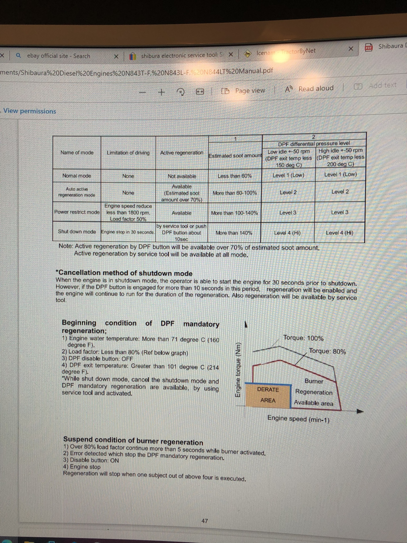

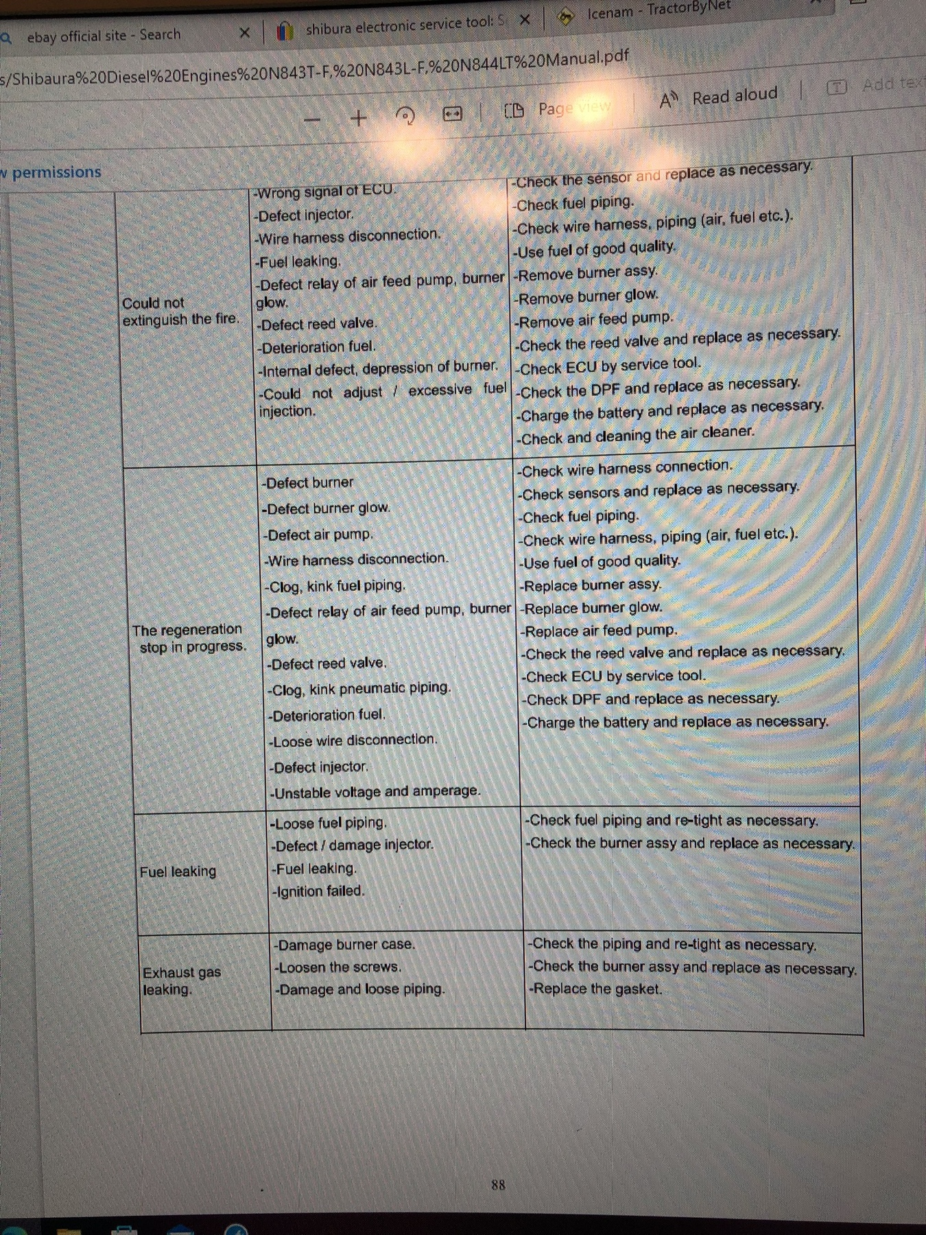

Here is some troubleshooting info from the Shibaura N843 engine manual.

Thanks inpo44! I'll print those pages out.
