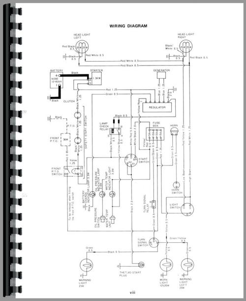

Yesterday the battery was too low, so started the tractor with external power supply, much better!
Made me think of bad connections between cables and battery, cleaned it.
I charged the battery over night, it started a little better today.
The charger is only 1 Ampere, I need to get a real charger!
Hmmm I have 12.6 Volts when the tractor is turned off and I have 12.6 Volts when the tractor is running, so I guess the tractor is not charging itself :)
The wiring on the tractor is really a mess!
Anyone who has a high resolution wiring / schematic for the 186D?
There are some around but not shure if they are OK.
I noticed there is a relay under the dash, not shure why.
(Not the one for the L/R indicator)
The connector for the red lights on the dash was loose, reconnected it.
Do these lights indicate issues or indicate normal operation for the functions (temp/charge/oil)?
What is normal to expect?

Is your machine GREEN or RED of the YM186D ??? This will determine which of the parts manuals to look at. I have both the green and red tractor versions in PDF.
   / Yanmar 186D broken shaft #60
oil light should come on when the key is turned to the on position, should go off when engine cranks and oil pressure is achieved. Same with charge light. Temperature light should not come on at any time unless it overheats. You can unplug the wire at the sensor and touch it to ground for a test to see if the light works. Do this with key in on position.
Picture as plain as I can get it, sorry.
