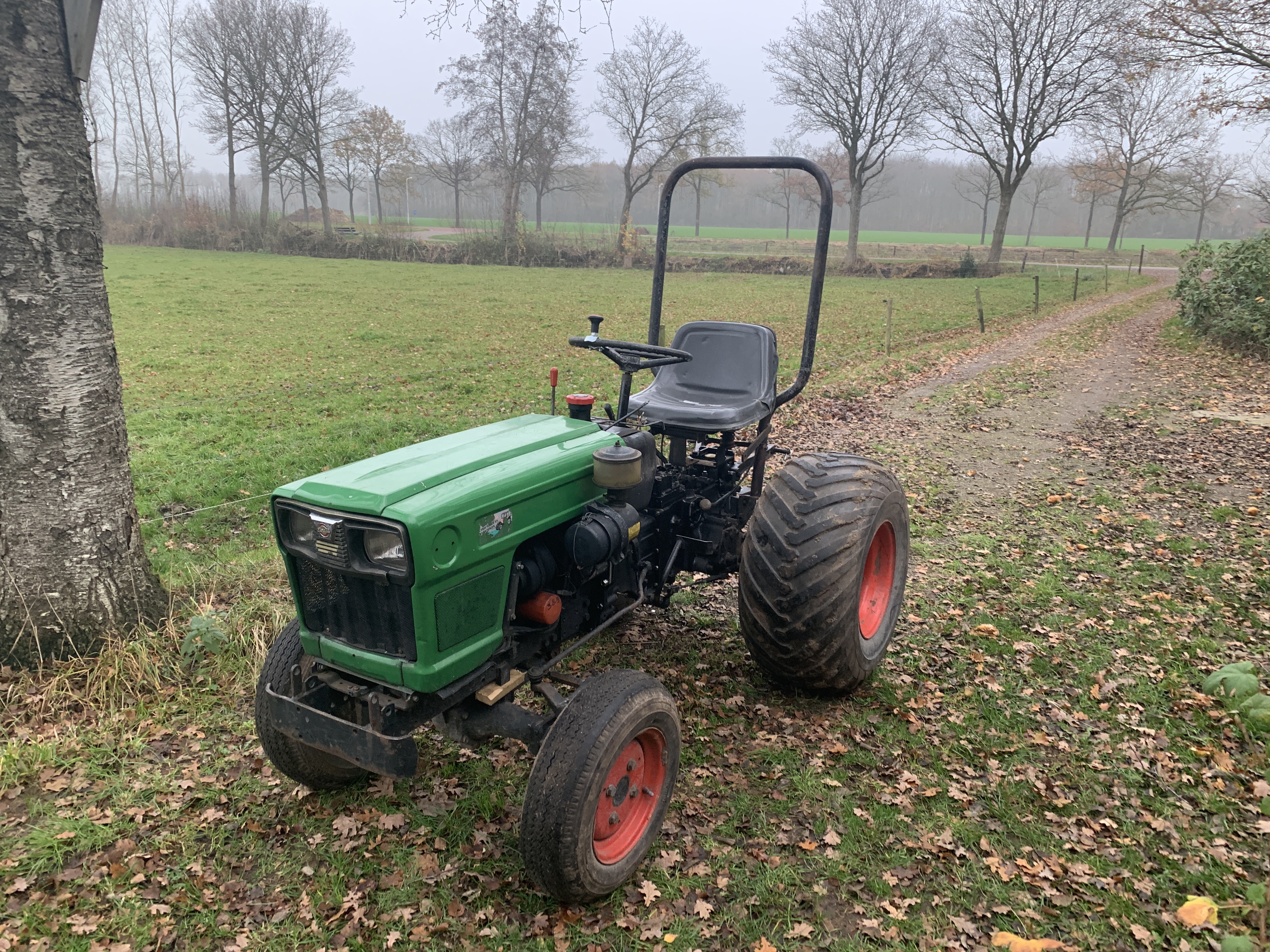

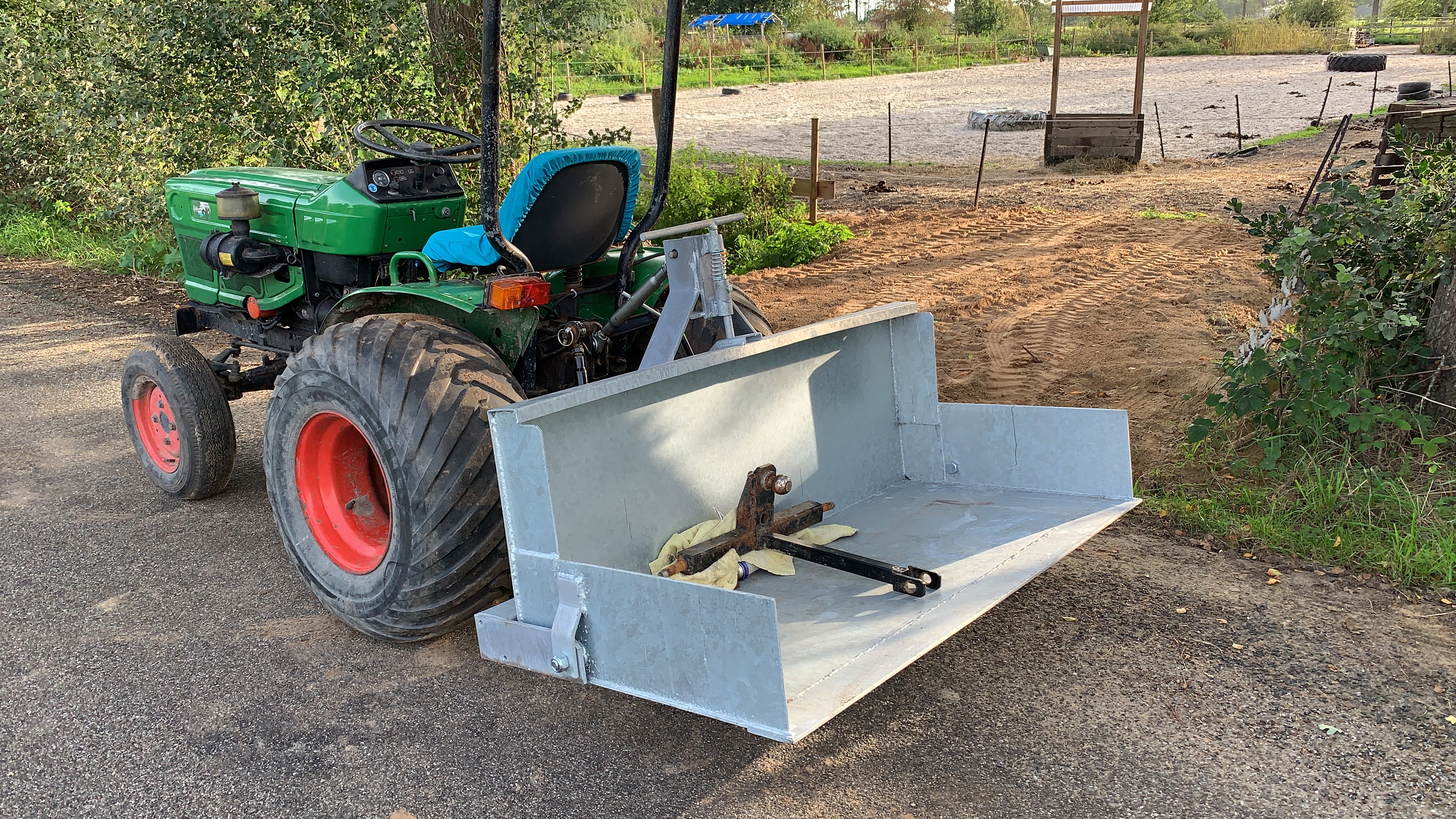

The tractor is repainted and I have no idea which parts are original or maybe put together form other tractors.
On the inside of the dashboard there's still the lime green color.
Here are some pic's:

Your Yanmar is not an early green. It's painted JD green. So, with that said, you actually own a YanDeere YD186D :laughing:

A John Deere having red rims haha :)
The green is by far not like JD, the chassis is black, JD chassis supposed to be green as well.
I think our tractor is more like a Yameleon :laughing:

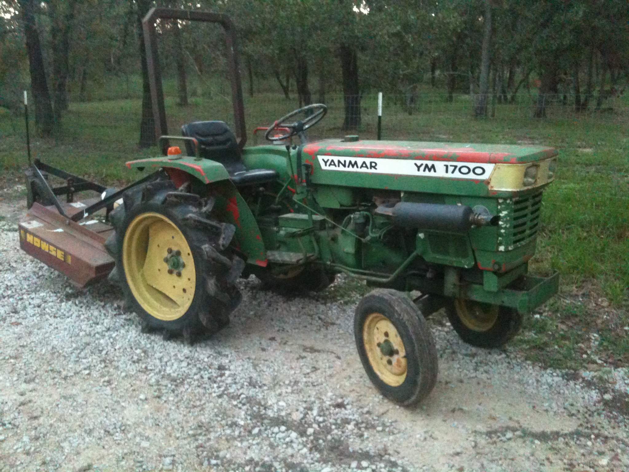

Back around 2006 or so, on this forum, a person coined the term YanDeere.
https://www.tractorbynet.com/forums/john-deere-buying-pricing/100677-anyone-heard-yandeere.html
https://www.tractorbynet.com/forums/projects/77913-moving-20-container.html#post866159
The earliest post of the term on the web from what I could find.
A funny YanDeere The YanDeere by Dorami : geometrydash
On an anime site, YanGirl posted this: :p

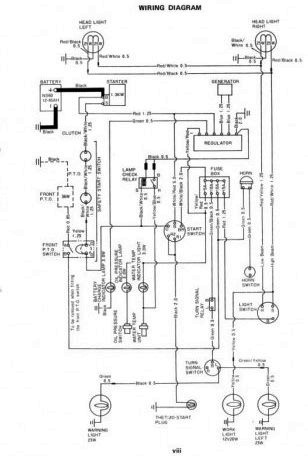

Today I removed all the unnecessary wires, removed al the tape and other stuff.
Everything works except....
My ignition switch is different.
The fusebox is only powered in the ON position.
Based on the schematics I guess the fusebox should be powered in the ON, TS and Crank position.
Anybody here who knows?
Also put the alternator back and tested the AC voltage on it (running engine), sadly it is 0.0
Tested the resistance, almost 0, also beep.
So maybe shortage inside the coil?
Or does anyone have an other explanation?

That's the TS in the ignition key setting. Why 2 wires?
You only have a partial storybook with the YM276 book. It would have some similar general items, but not exactly explicit.
I can make mention that both California and myself along with many others have not been able to turn up a YM186 service manual. :rolleyes:
We do have a recent addition from the Yanmar Tractor Owners Group on GIO. I'll add it here too. Just maybe, with these manuals, you could draw some conclusion how things should have been on the machine.
YANMAR YM135 YM155 YM240 YM330 ELECTRICAL MANUAL.pdf
Next to hydraulics, the electrical schematics tends to be the most sought after item to troubleshoot.
Over at Jensales, this is shown. Would this actually be the right electrical schematic in image-4 for a YM186? Not sure.

Pretty sure that is the same diagram I attached in post #60, yours may be plainer.
   / Yanmar 186D broken shaft #91
hmm. It didn't scale right either.
Let's try that again in PDF.
Rotate and zoom to 100%. It should be somewhat readable for many of the items.
  • YM186 Schematic - possibly.pdf

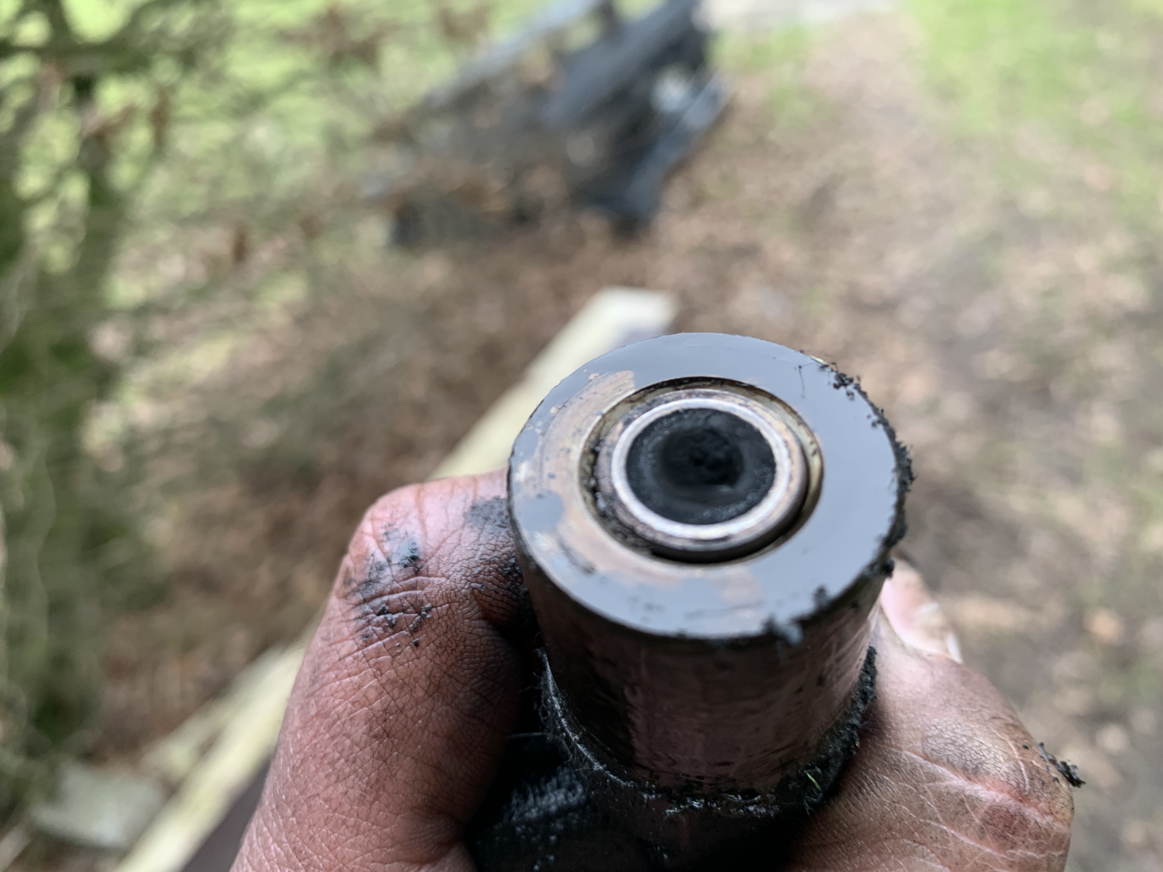

Today checked the valves, two of them had way more space compared to 0.20 as specified, adjusted them.
Also got all the injectors out, very easy, so I guess Im mister lucky here :)
One of the bolts was already loose...hmm....not good :(
The hardest part was to move the second fuel line out of the injector since there is a little too less space if you want to leave the air intake manifold on.
They all look like this:
What do you guys think, dirty, very dirty or ..... :) :)
Also checked the spray patterns, the way the diesel sprayed out, oh boy you cannot call that a pattern at all :)
Because the tractor is in use these days I put them back and will clean them later.
However the tractor started much better already, so I guess the loose injector made a compression leak.
Any tips on cleaning the injectors?

How much more than 0.2mm? Generally, it can be twice that and still no problems with starting or low speed running. A little too much valve stem clearance just retards the injection timing a bit which tends to make them run a bit sooty.
The injectors don't look bad to me, but not sure what you can tell by looking. I've never rebuilt a set and always wanted to. I've heard there are kits available but would be very careful and maybe just use wood to scrape. The needle valve part has to be delicate. I wonder if marine Yanmar engines use the same injectors?
Only other hint is to be careful when doing a spray pattern. Several thousand PSI spray WILL penetrate skin, and can blind you. The infection that follows high pressure injection through the skin - even in the hands - has reportedly killed people.

With the metal parts, an ultrasonic parts cleaner and Seafoam is how I've done it for years. Seafoam works well on diesel and as a cleaner for the fuel system. I've let the parts sit in for 15~20 mins at a time. IF it still looked nasty, more time was needed. When doing this, ideally outside and fresh air is best. An open garage or on the front porch has worked for me. Just keep away from the pets.
From the YM186 Parts Manual on pg 33, it shows a nice exploded diagram view of how it goes together. Wish it mentioned the torque requirements to put it all back together.
