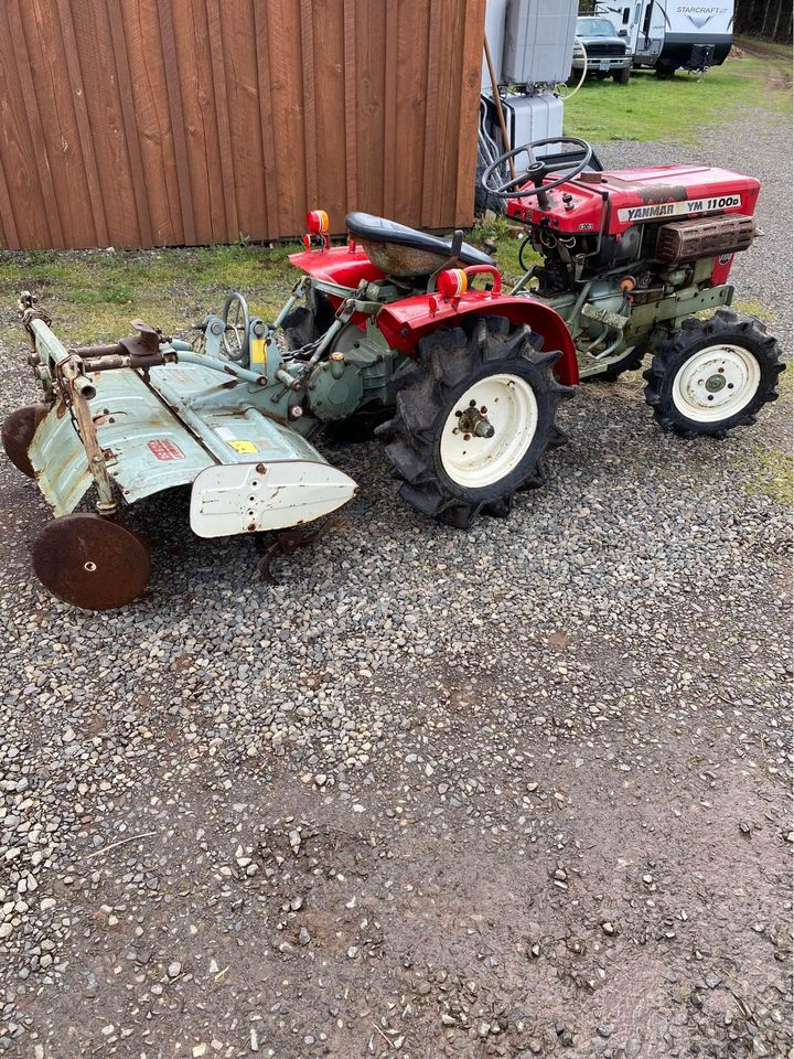

Is it worth grabbing at that price. Can fix pretty much anything and I have no plans to till a field but rather just small projects.
   / Yanmar RS1202 Tiller project #22
I would IF I had a clear idea how to make the mount. It's an alternative to spending $500+ for the three-point version after searching for many months.
When I bought my RS1400 the advice here from an experienced dealer was immediately replace the bearing on the far side of the tiller shaft. They all rust because they were used submerged in a paddy and can seize, scoring the shaft. It's a standard bearing. Aside from that and judging if the tines are serviceable there isn't much else that is ever expected to break. Oh and replace the gear oil (90 wt) because there is always condensation water in there, but I've never read of that causing a problem. Those tillers are built so tough that there's little that can harm them.
I would talk him down on price. There's not much demand for that special-mount tiller. It's made for semi-permanent mounting to a specific tractor.
When I bought my RS1400 the advice here from an experienced dealer was immediately replace the bearing on the far side of the tiller shaft. They all rust because they were used submerged in a paddy and can seize, scoring the shaft. It's a standard bearing. Aside from that and judging if the times are serviceable there isn't much else that is ever expected to break. Oh and replace the gear oil (90 wt) because there is always condensation water in there, but I've never read of that causing a problem. Those tillers are built so tough that there's little that can harm them.
Good info thanks.
   / Yanmar RS1202 Tiller project #24
That tiller is for a YM 1301 - 1401 or a 1510
It will take a lot of fabrication to make that baby hum on a different tractor , plus the PTO shaft on those were not the greatest.
If you're retired , go for it, or it will make a good winter project. However you have a lot of members here with good advice.

As much as I would like a bulletproof Yanmar Tiller I'm gonna pass on it for now. May hit it hard in the Fall for a winter project.

Just came across this photo.

California, You mentioned replacing the 90 wt gear oil in the tiller. I haven't pulled any plugs yet except the plastic fill cap on the cross tube and mine doesn't have any labels on it. Is the oil common to the chain case and 90° gearbox? What is the fill level and how many quarts does it hold?
Steve
   / Yanmar RS1202 Tiller project #30
I never found any instructions for fill so I put in just enough oil to flow from the gear case over to the PTO gear. There's no barrier between them.
I don't recall quantity, maybe a quart? Same oil is used in the front 4x4 axle so its something to keep on hand.
