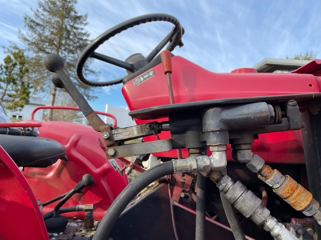

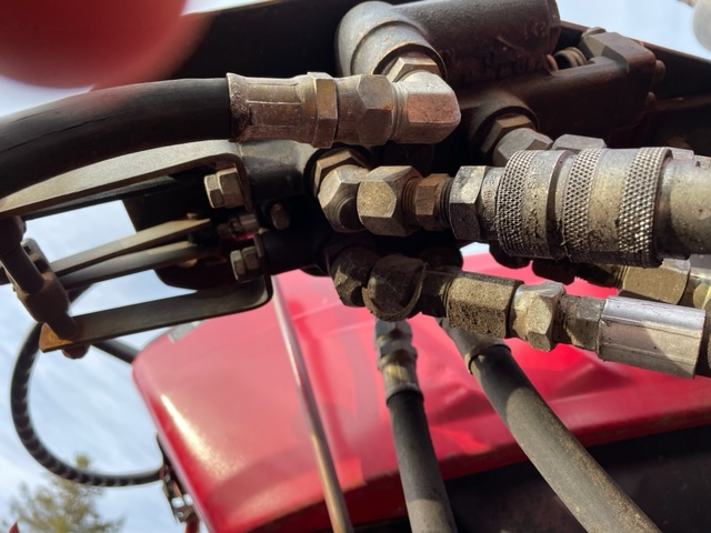

I had a bit of time to work on the tractor and changed the ignition switch since there was no key. It did not turn over, but a charge to the battery should change that. Here are some pictures of the controls for the YFL1000. It looks to me like there is one control to raise and lower the unit and another to curl the bucket. Would you recommend keeping this setup or replacing it with a new model? If so, any ideas what replacement might work? Thanks.

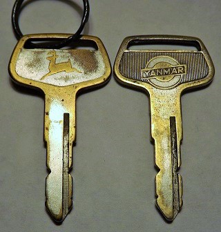

If I recall, there were only 2 types of keys for the YM Series. The Tree Frog type and the Red Apple type. And sometimes they would over lap depending on how the machines transitioned.
The Read Apple tractor keys were also the John Deere 50 Series keys. Note the icon brand details. I use either to start my machine.
I can not be sure about where the hoses go on your setup but if the two hoses with the quick disconnects go to the suction and discharge of the pump you need to know if that discharge quick connect ever gets disconnected with the engine running your pump will be immediately dead headed.
If your valve works good for you, why change?
   / Yanmar YFL1000 vs Yanmar YFL1075 #19
With more photos we could see where the hoses all go. And that would make a difference in what valve you replaced yours with. There are several different ways to plumb a FEL to a Yanmar.
More importantly, why would you want to replace the valve in the first place?
   / Yanmar YFL1000 vs Yanmar YFL1075 #20
Ditto! There's a lot of stuff Yanmar got right and trying to 'improve' what they designed is pointless.
I don't see any leaked oil on the underside of that valve which might be the only reason to replace it.
That said - I had to replace the ancient AICO (third-party) loader control on the YM240 because it dribbled on my foot when lifting and seemed weak.
I looked through my old photos posted here and they are attached to the following posts, in threads where I asked a lot of beginner questions. I'll leave it to you to wander through the threads where I gradually learned enough to do the project right.
But my advice stands - don't replace anything until its unavoidable. Not even hoses. The hoses have two steel mesh layers and can look awful while still working same as new.
