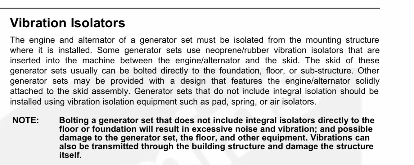

Solid mounted to the frame but frames are on isolators - either spring or rubber waffle type.
In a tractor, the frame is free to move, you can’t bolt and engine directly to concrete without causing damage.
I get this from two decades of failure analysis on generators from 10 -2500 kw.

That is a sale photo of a paint booth overhaul, not an installed unit. The alternator is shimmer and solid mounted to the frame but that frame will be on some kind of isolator when they install it.
   / Your last generator Maintenance Run #3,338
I looked up Generac vibration isolators on Jack’s Small Engines there are dozens obviously a standard component.

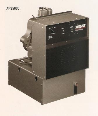

It took a little time to dig out the old Winco documentation... this Natural Gas unit served as emergency back-up power for a small medical clinic.
Here is the cut and past regarding mounting:
Caution The unit's main frame should be bolted solidly to a 4 to 6 inch thick cement pad. The engine-generator is mounted on a sub-frame which is shock mounted with special neoprene pads on the main frame. This allows the engine generator to vibrate without affecting the control panel which is mounted on the main frame. DO NOT shock mount the main frame. Engine vibration will be trans-mitted to the control panel causing erroneous start-stop cycles and premature control failure.
