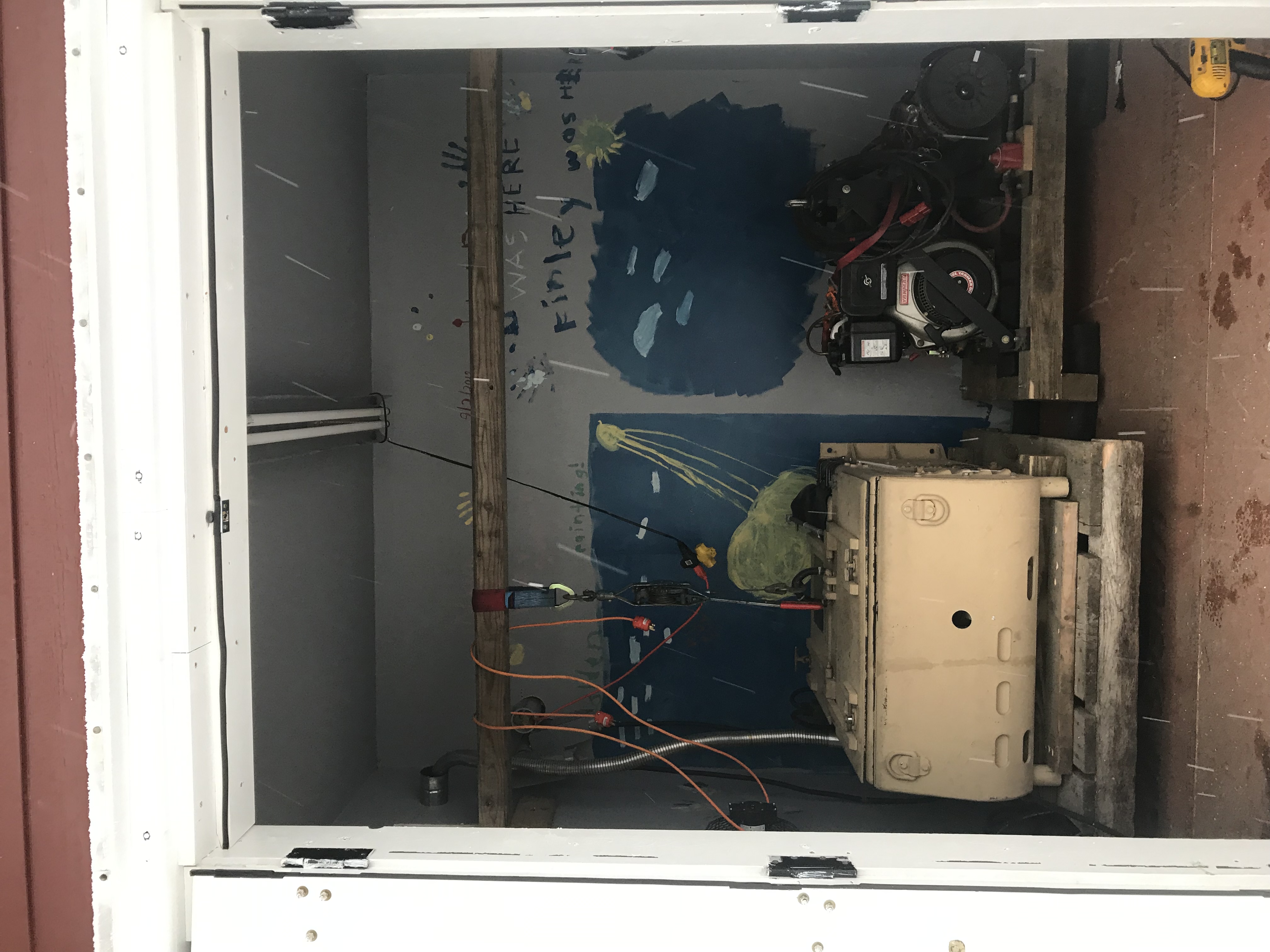

Powerhouse update
I upgraded the cables going from the powerhouse to my battery pack.
I had a length of 4awg which became warm when pulling 200 amps @ 24v.
There was also excessive voltage drop of 1+ volts depending on load.
The run into the house is now kcmil 350 aluminum cable into 4/0 copper.
My last test I saw 214 amps with negligible voltage drop.
My cooling fans are on place and operational.
2 details left.
Install 120 volt outlets around the interior for fan, light and 1500 watt space heater power.
Move my 55 gallon diesel tank into the garage and connect the MEP-952b fuel line which can pull fuel from up to 30 feet away.
This unit has it own fuel filters and pump. When that’s done it will be ready for action.
The Yanmar will then get fitted up with exhaust and an auxiliary fuel tank for extended runs.
I’ve performed fuel consumption testing in the past but I will repeat and post my final numbers in the future.

Very nicely done. I’ve been following along even if I wasn’t commenting.
Having space to get around a genset really pays off in the long run even for something as simple as an unexpected filter change in bad weather, at night etc.

Very close...... to being Zombie Apocalypse Approved :thumbsup:

Geez, I only have a generator.
When I could have had a Powerhouse.
Seriously impressed by that install.
Now if we could figure out how to get fuel in a crisis, that's the remaining issue.
I have 800 gallons of propane, but even that will run out even with rationing.
With the heat and humidity here, plus it gets cold here for sure, high demands on HVAC,
and since two of my heaters run on propane, the heaters are sucking up my gen fuel, not a preferred situation.
That install rates a nice Powerhouse sign on the door.

Critical factor for sure...... why even well-funded military operations are interested in efficiency..... can't do much when out of fuel.
If you weren't planning to move soon(ish), I'd say just double-down on the tank capacity - that could be a selling point, for an informed buyer though....
Big issues in parts of Canada right now with propane (rail strike at present). The biz news last night was talking about truck tankers waiting in Sarnia for 8+ hours to get filled with propane. Not easy to replace rail capacity.....
