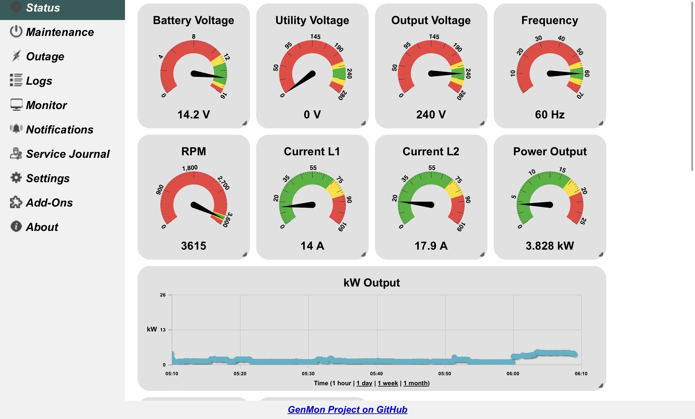

Hmmm, another unplanned maintenance run. Lost power an hour ago. 8100 houses affected. These are why i never need manual long exercises on my unit. Happen too many times.

great gauges GRS
only issue is where the tach is
too bad it's not at 1800...
the output data is super helpful
see honey, it has to stay in the green
I used to have a 50amp boat with a 100 amp wife...

Just got notified by my genmon unit, power has been restored. 1 hr, 54 minutes
That telemetry package could almost convince me to start carrying a cell again.......
Almost. I'm close to home virtually all the time these days, but if I was still traveling for business like I used to, that setup would seriously tempt me.
Key data, AND CPU Temp, AND Wifi with actually some gradation on Strength.
