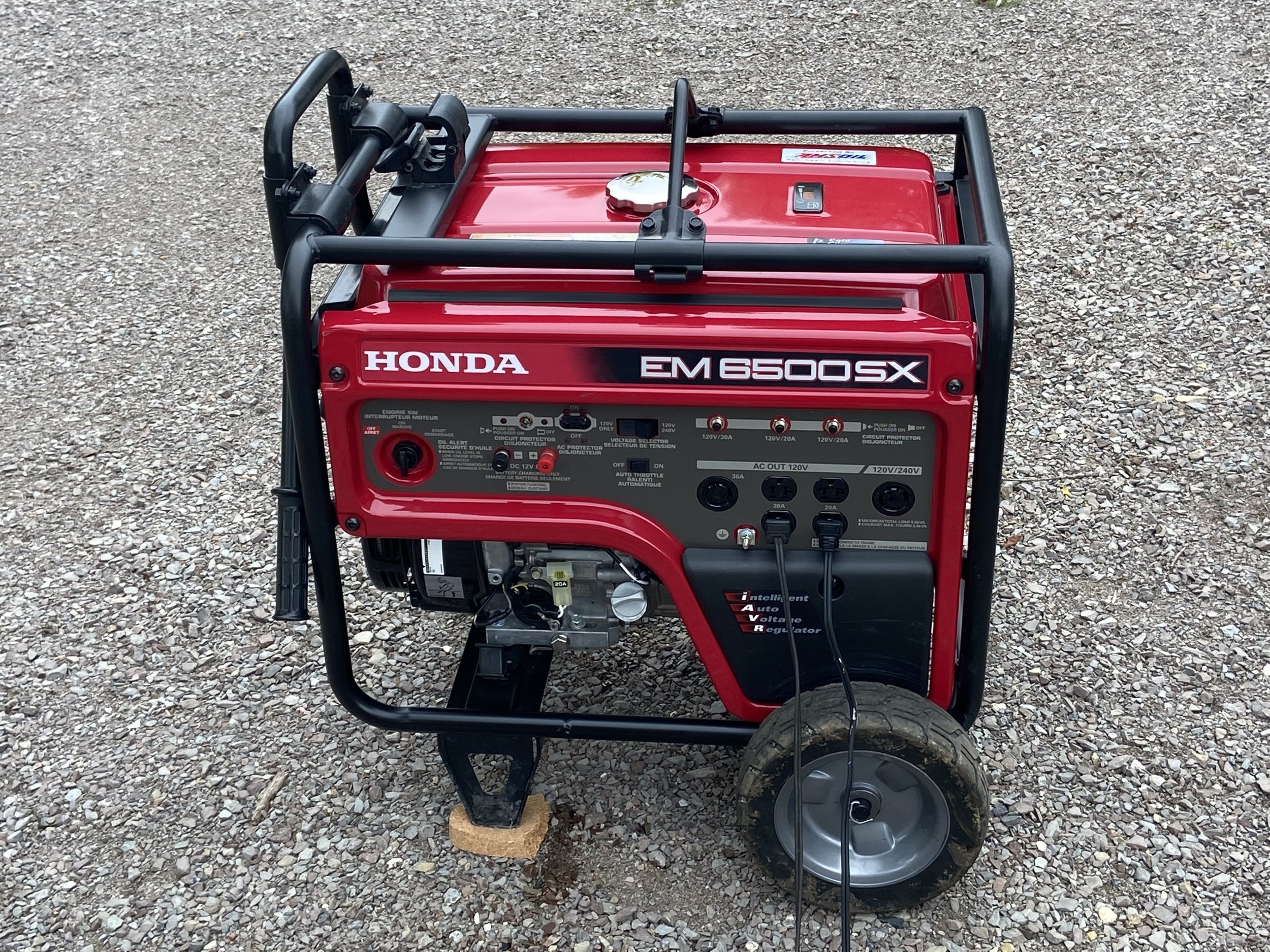

I like my Hondas too. I also had a trusty Honda 5000 but several years ago sold it to buy an EM6500SX electric start. It’s quieter than the 5000 was and no worse on fuel. I exercise it regularly and always drain the carburetor afterwards, using the handy OEM drain. It’s my new pride and joy 🤩

View attachment 869403I like my Hondas too. I also had a trusty Honda 5000 but several years ago sold it to buy an EM6500SX electric start. It’s quieter than the 5000 was and no worse on fuel. I exercise it regularly and always drain the carburetor afterwards, using the handy OEM drain. It’s my new pride and joy 🤩
Like firetrucks, Hondas look good in Red !
Rgds, D.
