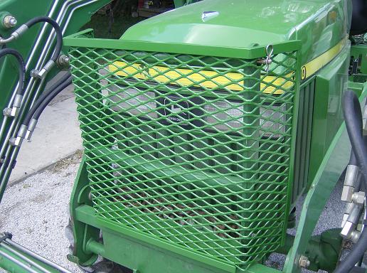

Nice looking grill guard for a total protection situation. Not much will get by that and the easy on-easy off feature very nice.
   / Your towing rigs and trailers #2,442
Thanks!
I made the grille guard myself: View attachment 469439 On/off with one long pin.
I'll second Pappy's comment! Nice looking grill guard. I have been inspired by a lot of your all's great grill protection setups and need to get to work fabricating something up for my machine too. A couple of close calls already using the grapple, so I better do it sooner than later!
