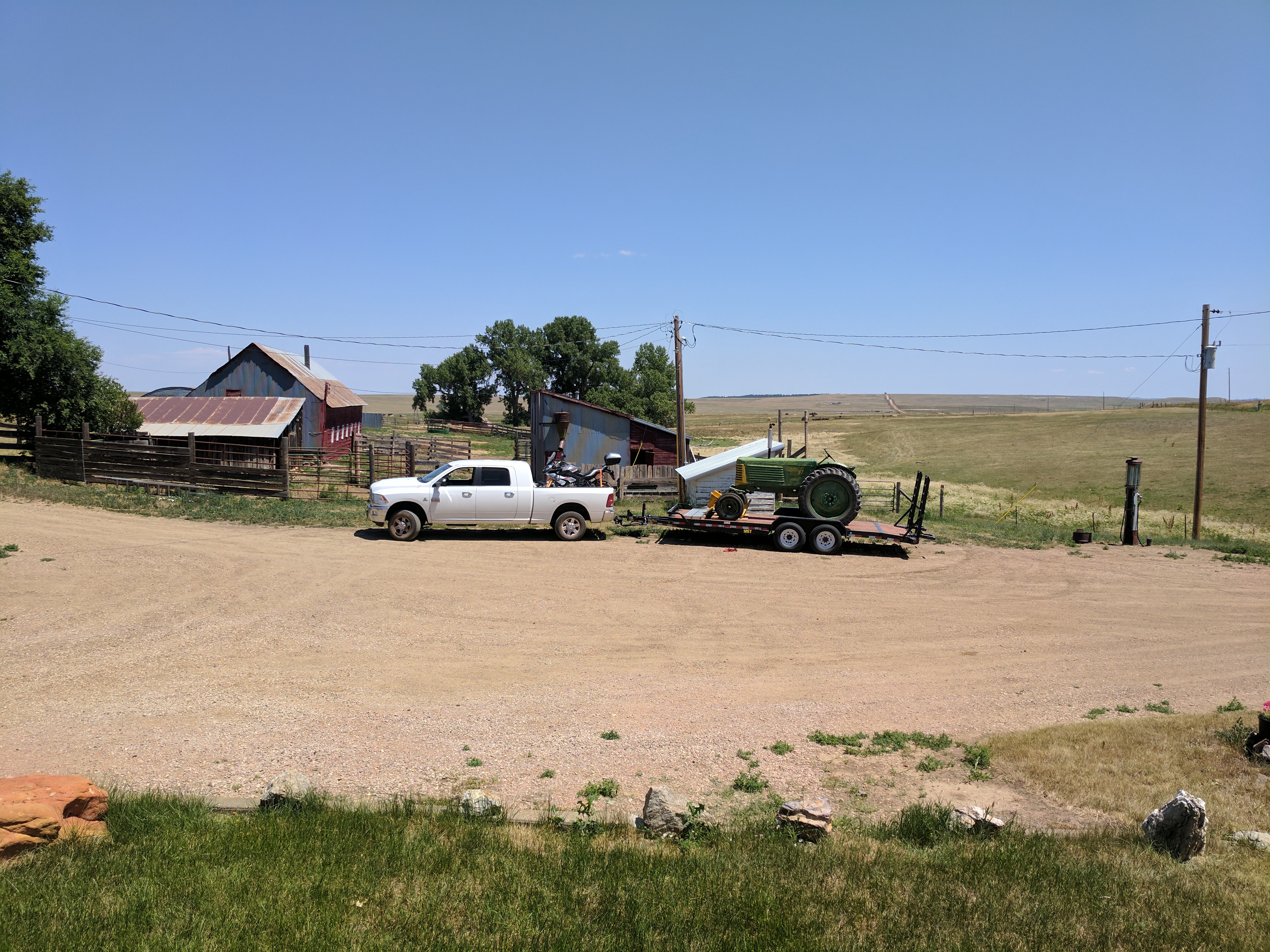

Here I am getting ready to head back to Idaho with my father's Oliver 77. It isn't tied down yet so that is why you can't see the straps and chains.

You need to readjust that weight distributing hitch. Those spring bars should be near parallel to the trailer frame once latched and loaded. You'll need to loosen the head where the spring bars go in, two bolts. The top bolt may need to come out to add washers as spacers, some just have a bolt you will screw in more. There is also a bolt that goes in the bottom to help secure the amount of tilt there is on the head. Once the head is tilted away from the truck and tightened down, the spring bars should hang below level slightly. Set the trailer on the ball, lock it, raise the trailer and back of the truck up till the bars are near level, then lock the chains for the spring bars on their mounts. Lower the jack to set the weight back on the system.
Advance to 7:10 to get to the relevant part of the video below.

They actually were close to level, part of it is the angle of the picture and part was the brother in law hooked it to the wrong link. :) On level ground and the load balanced they were pretty close to level. I do appreciate you looking out for me though.

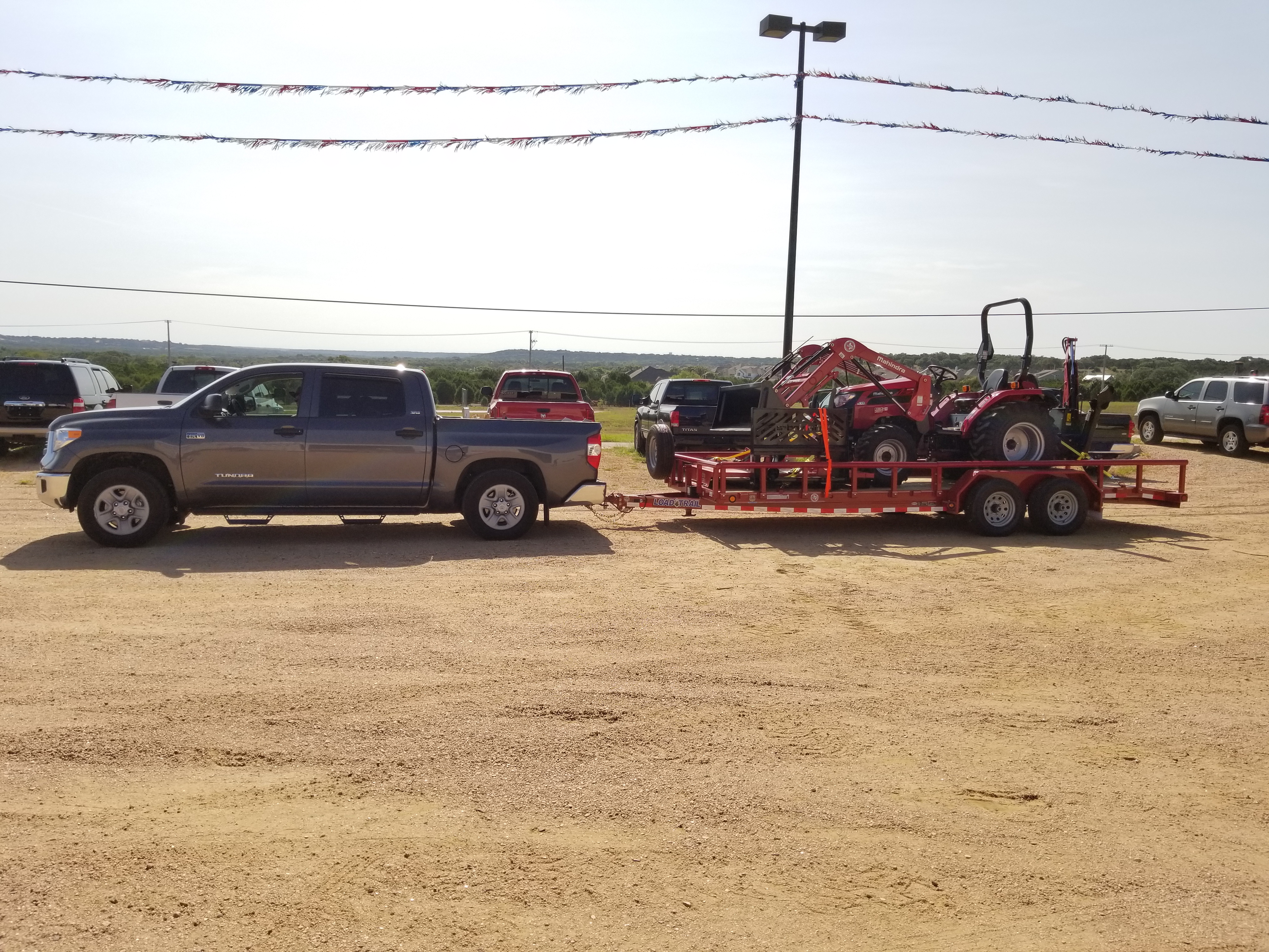

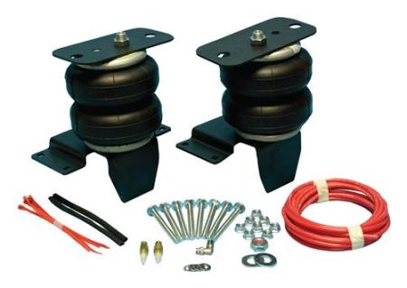

2017 Tundra 4x4 CrewMax freshly hooked up to the new 20' Load Trail 10k lb hauler and the new 2538 TLB, 6' shredder and pallet forks loaded. I got it hauled out to the property and came back and ordered the Firestone Ride Rites which I will install before hauling again. It towed it fine, no issues thanks to smooth Texas roads.

You'll like the airbags, I put them on my 3/4 ton and haul a 16ft dump, tows great even when the quarry loads it a bit tongue heavy
