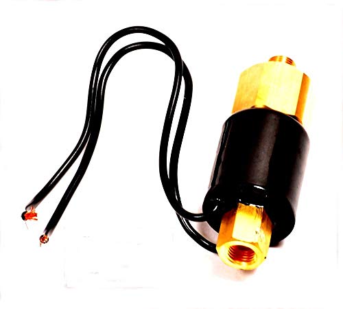

Surge brakes are popular on boats since you don稚 have to worry about dunking the electronics. I think you have to get out and do something like insert a pin to lock out the surge brakes.

My boat has a pin you have to put in to back up in certain situations. It locks out the brakes. I have to use it every time I back in my drive.
There used to be a few companies that made brake kits that tied into your master cylinder and the trailer brake pressure matched the exact pressure applied to the truck. They were great but expensive and a bit more complicated to install.
I’ve had several top end inertia brake controllers and at times they have all had limitations. FWIW.
Some also make a solenoid that will tie into the reverse lights so it disables the brakes when in reverse.

Man that would be slick, my boats an 06 not sure if they made that option then. It doesn’t sound like much but it’s a pain to get out and get back there to put the pin in, then if there is any pressure (like the boat is uphill pushing on the truck) it doesn’t line up.
Thanks for the info, course I’ve been told I’ll never get another boat, lol. But if I ever do I will ask about it.

Looks like its just an addon that goes behind the surge coupler: Amazon.com: Trailer Brake Electric Reverse Lock Out Solenoid: Automotive

I think all boat trailers made in the last 10 years (at least) will have the reverse lockout valve, but I know quite a few people who don't have the right 5-pin connector on their tow vehicle to pass along the reverse light signal. So that can be a minor complication. If you have a typical 7-pin round connector, that should be carrying reverse and you can get an adapter to go from 7-pin to 5-pin. If you only have a 4-pin on the tow vehicle, or had 7-pin with no adapter, you're out of luck....
