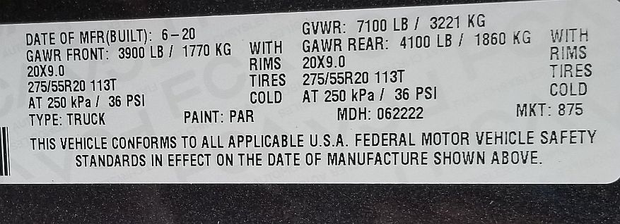

   / Your towing rigs and trailers #3,575
Here's the numbers from the sticker. Says mfg date 6-20, vin lookup said 7-22 but that may have been the first transfer date. I believe curb weight is in the 5000 - 5200 lb. ballpark (crew cab +v8+ 5'7" bed).
GVWR on sticker is 7100 lb.

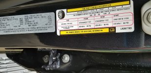

   / Your towing rigs and trailers #3,576
The other sticker will list the actual payload number.
In the past I had a Dodge 2500 and the payload on that truck with the Cummins is less than a lot of modern half tons.
   / Your towing rigs and trailers #3,577
OK, got the right one.
Looks like 1301 lb. Odd how things are out of sync. 5200 (curb weight) + 1301 (max cargo on sticker) = 6501 lb while GVWR is 7100 lb. Load range 113 tires should be OK for 2500 lb. each, so where does the limitation come from?
   / Your towing rigs and trailers #3,578
Your truck probably weighs closer to 5800 lbs, the options add up and take away from the payload.
   / Your towing rigs and trailers #3,579
I had the same experience with the various brochures and towing guides from the manufacturers being unreliable for cargo and tow ratings. If you're lucky they will be within 400#. The doorjamb sticker (or sometimes in the glove box) is the most accurate data and will usually be specific to the VIN or configuration and trim level.
The loaded up trucks suffer in cargo capacity, no doubt about it. You're trading off cargo capacity for options, crew cab, etc (and you carry it around all the time). And at least with GMC, going with the heavier engine options also deducts from cargo capacity. In a GMC, if you care about cargo or towing capacity, best option is a lower trim level with the smaller V8 and avoid crew cab. That can gain 200-500# in extra capacity for cargo and towing.
I hear a lot of people proclaim that the bigger engines are better for towing. Well, they might feel stronger when towing, but they also knock down the towing capacity. I think there is a couple hundred pound loss in tow rating with the larger V8 in GMC.
   / Your towing rigs and trailers #3,580
seeing this just made me curious so i grabbed a flashlight and went out to check mine, and my numbers all add up. 7200 gvw, 5405 curb, 1795 payload... both the tire sticker and the manufacturer towing / hauling sticker matched up on the max payload amount. Hard to believe that any newer-ish trucks (even from different manufacturers) would vary by that much. Makes me think that they aren't going apples to apples, and that makes me surprised that they don't all use the most advantageous data they can.
