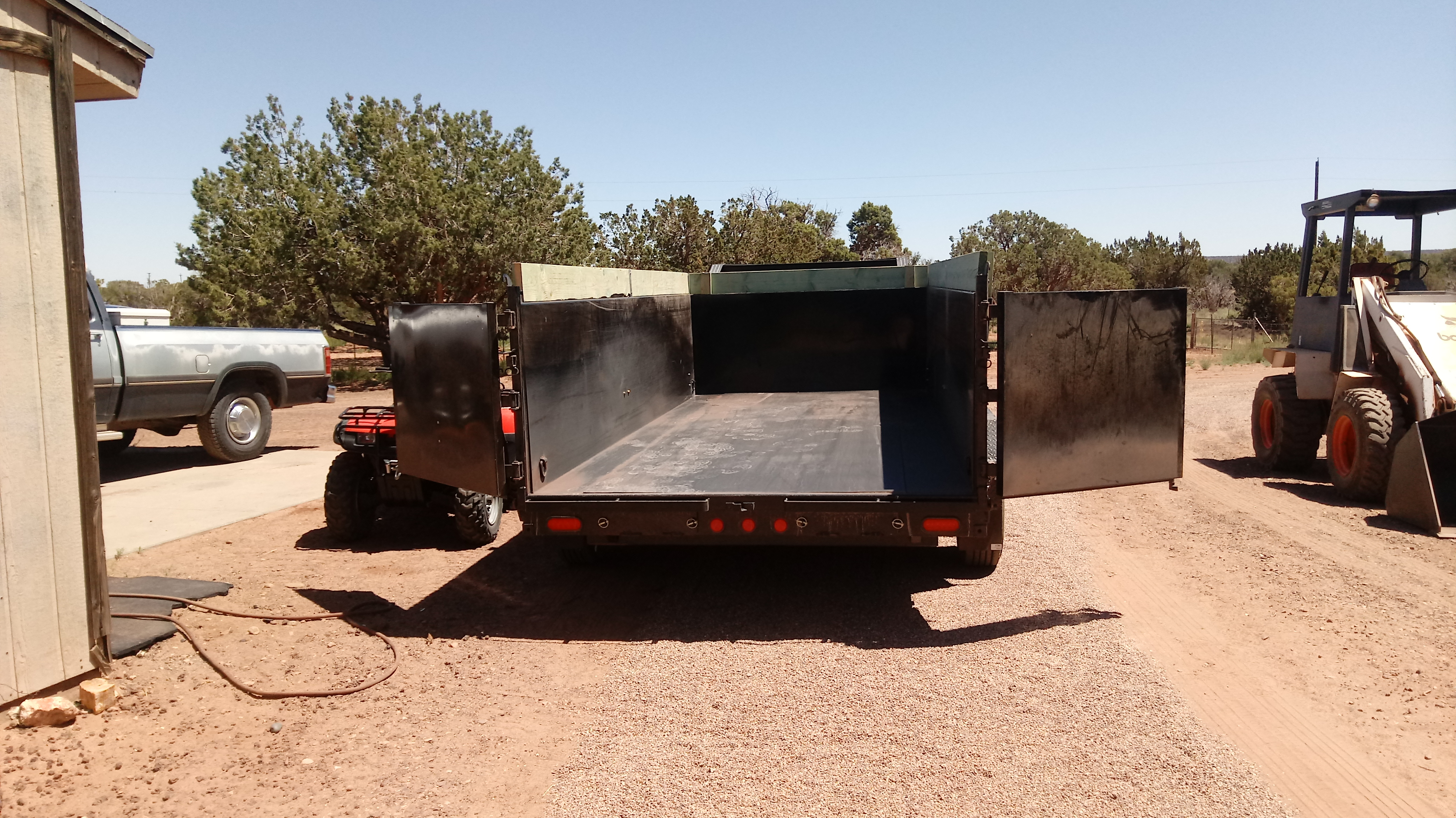

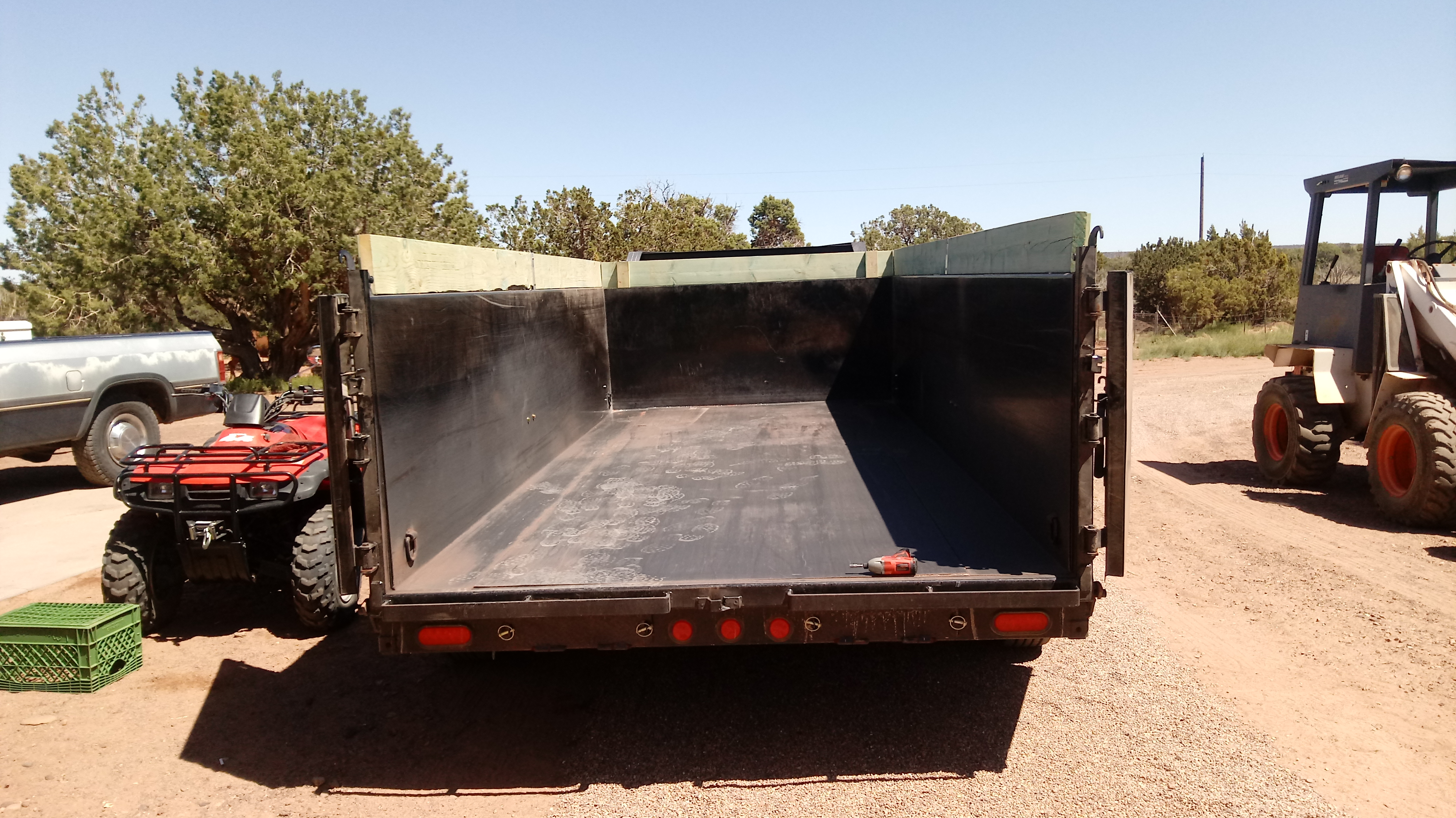

I was unimpressed with Diamond C. I'd heard so many good things about them I took a 2 hour trip one way just to look at them. Was quite disappointed, I think PJ is far better in workmanship and the small features such as how the doors are held open are also far better.
They look and operate cool until you actually put them in service. Then you find out real quick they open too wide, not swung up against the bed side wall. They stick out too far and encounter everything in the way, such as fences, buildings, trees etc.
Here is a before and after picture of my PJ when I re-modeled my latches.

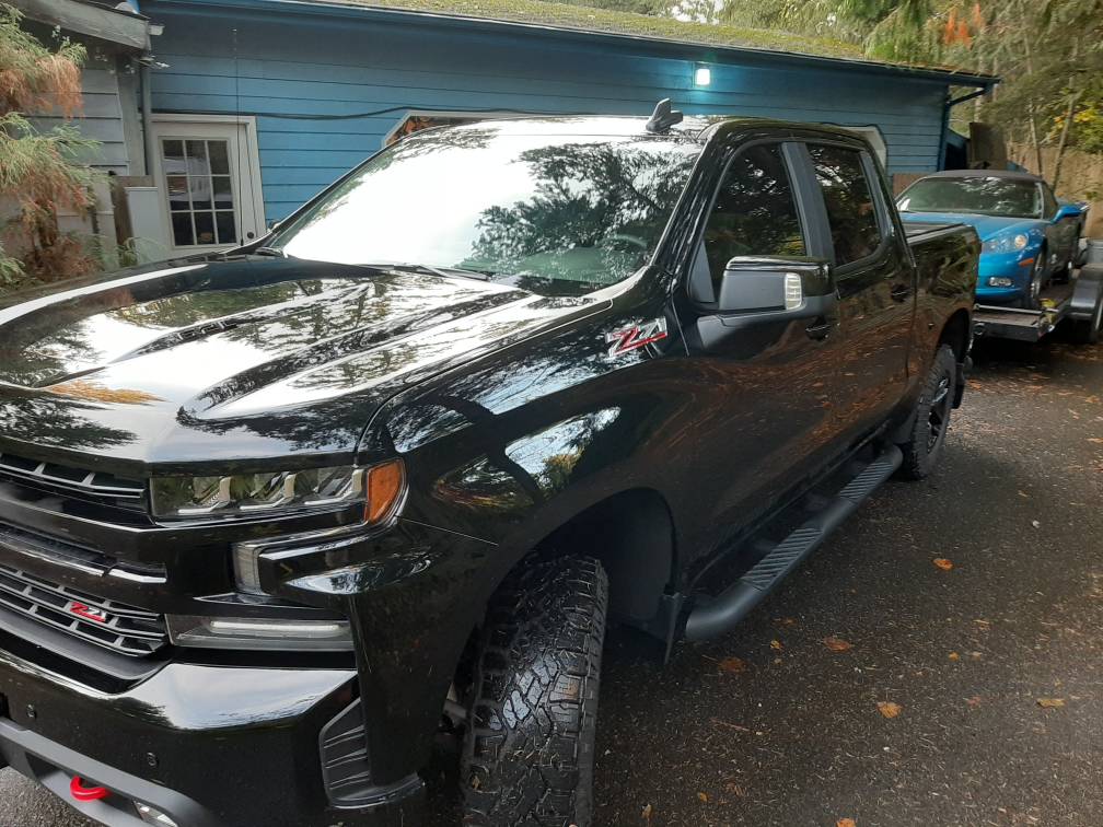

Unfortunately the Vette is on the trailer because the new truck (2700 miles) has a transmission leak. I didn't have anyone who could follow me to the dealer for the appointment then take me to the doctor and physical therapist. So I loaded the car and used it. The leak is a seal between the transmission and transfer case. They won't get parts until next week. So I had to go get the trailer with my other truck. I got the new one because the old one has a lot of miles and I wanted something more reliable to tow my RV. But the old one may still do that now. I need to keep it around because I have trailers that are too heavy for the 1500. If it's not a daily driver I should be able to keep it in real good running order. 20201022_172610.jpgIMG_20190427_164948536.jpg
