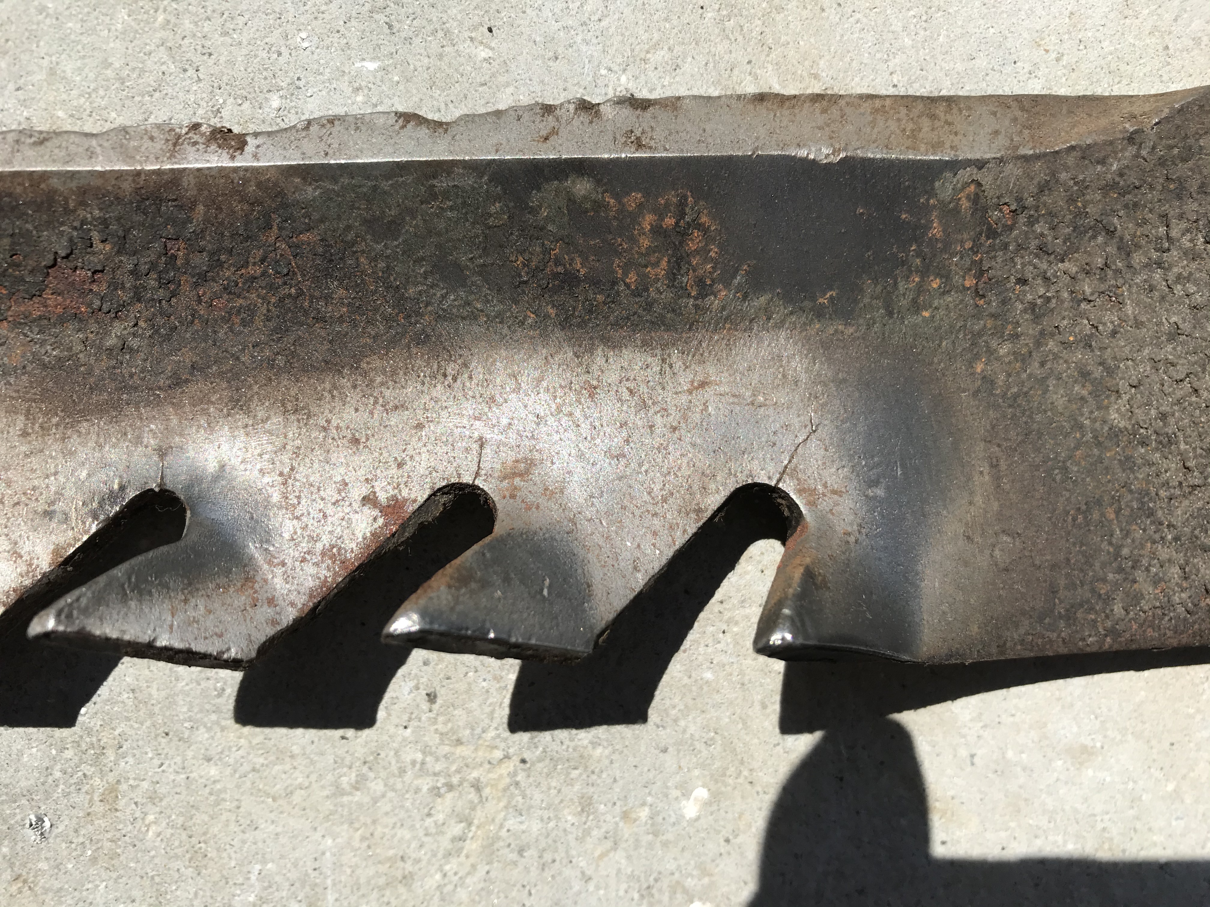

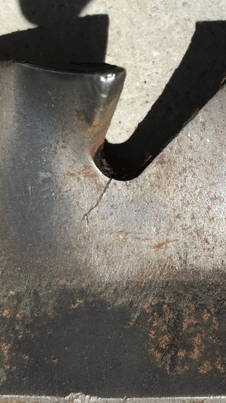

97E003DE-631E-48FA-8B06-749D927AB140.jpegThe gator blades are very good I have used them myself however I would like to share my experience with them.
I had a set on my SCAG STHM 3 wheel 61 mower.
The deck is manually raised with a boat style hand winch which requires considerable time to raise if you hit something.
I have struck many rocks & stumps in the process of expanding my lawn.
I was mowing the lawn one day when the blade broke.
I recovered the broken end days later
My advice is to inspect the radius for cracks every time you sharpen them.
This is not limited to gator blades but any blade with a machined radius.

Yikes. I've never seen a blade crack like that, but I guess it happens. I'll pay closer attention to mine when I sharpen them. I know you gotta do what you gotta do when reclaiming lawn, but it does appear they have received some harsh duty!

They did!!
After that event I inspected the other 6 spare blades and they were all cracked.
Some rocks are too large to remove and although I tried to be careful things happen.
My wife uses a hydro walk behind and she痴 gotten hung up also.
I should have known better given my background but it never crossed my mine.
Every blade I inspected before I sharpen.
