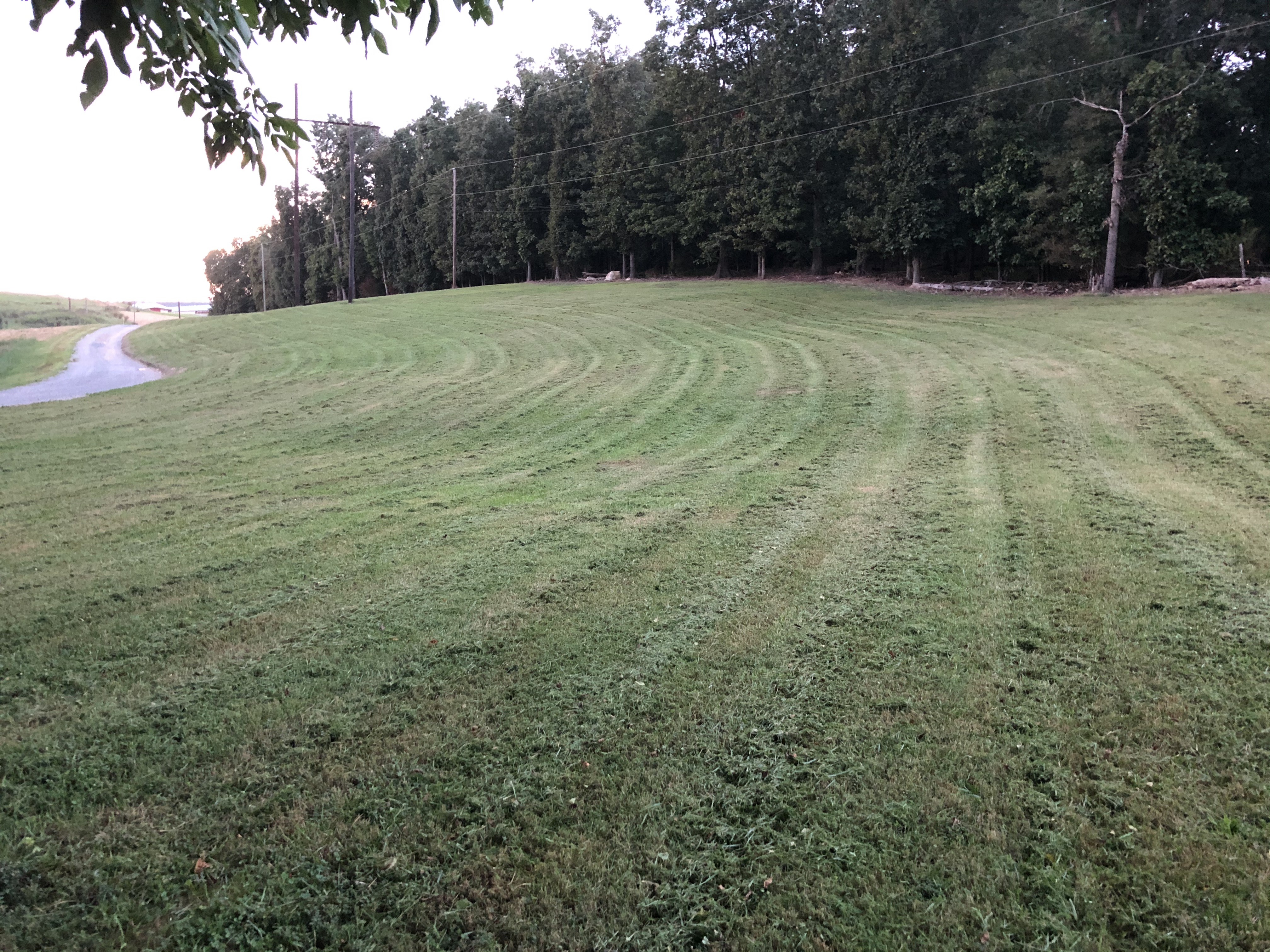

I removed the G6 Gator Blades from my 72” RD deck mower today.
The cut was great & they cut the clippings much finer but just don’t sling the heavy clippings out the back like hi lift blades.
I installed new Oregon 92-116 High Lift Blades with much longer FLAT sharpened edge AFTER I’d removed all the baffles underneath, the 2 rear deck skids, all 3 rubber flap shields across the rear of deck & also cut a 1” strip off across the bottom of a metal shield in center.
All this was done to sling Heavy clippings out faster & broader instead of making 3 windrows each pass.
It’s still not as good as my 72” Side Discharge but it’s the best it’s ever been.
   / Zd1211 blades #113
This was 6-8” hi thick heavy grass mowed in a back & forth pattern with 72” RD deck @ 3” blade height from concrete floor.
Clippings are still very visible but not concentrated into 3 separate windrows like before.
In a few days when clippings turns brown is when it’s Ugly :(
