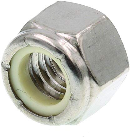

Also, of you mow around wire fences, (ie. farms) take the clevis pin out of the front casters on the deck and replace them with double nut bolts or lock tite the nuts. The fence wire will flip the clevis open and the caster goes into the blades without you knowing. The sound of the caster being ground up isn't nice, and definitely raises your pucker factor. I speak from experience. (more than once, because once just wasn't enough!)
Use these nylon insert lock nuts, they won't come loose.
