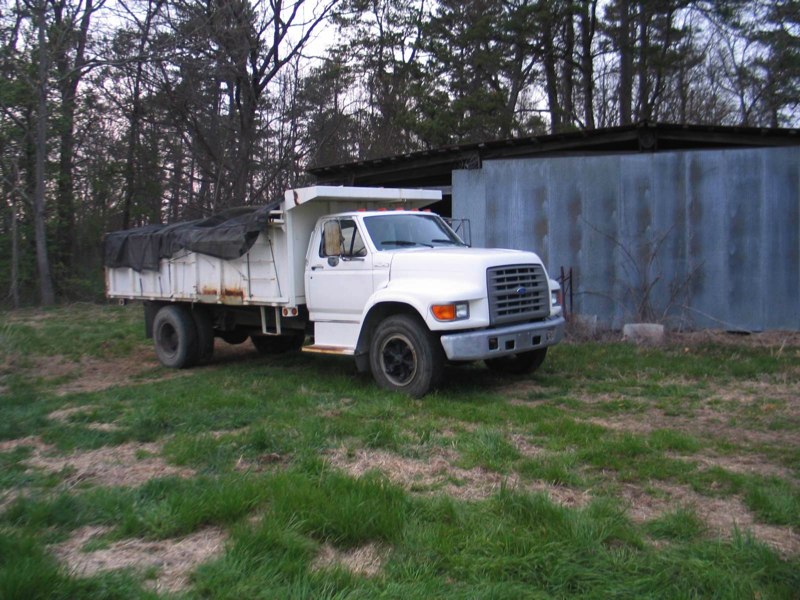

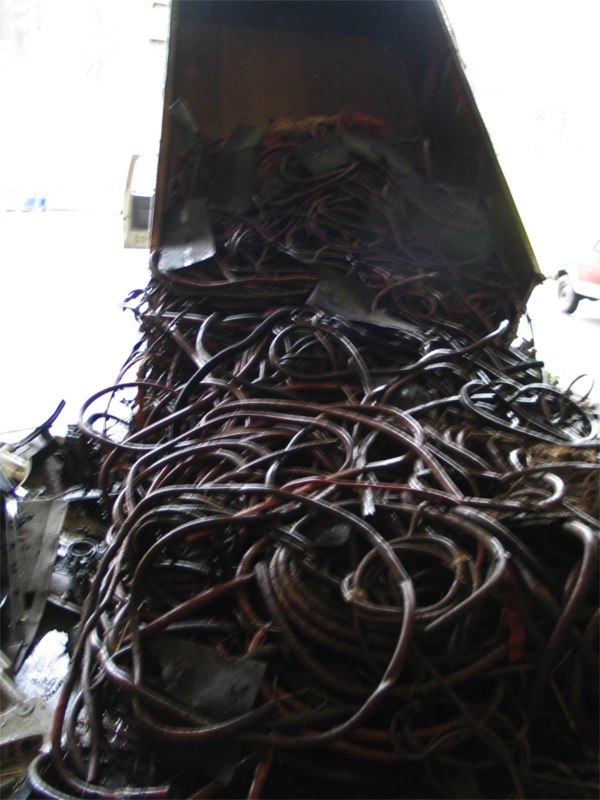

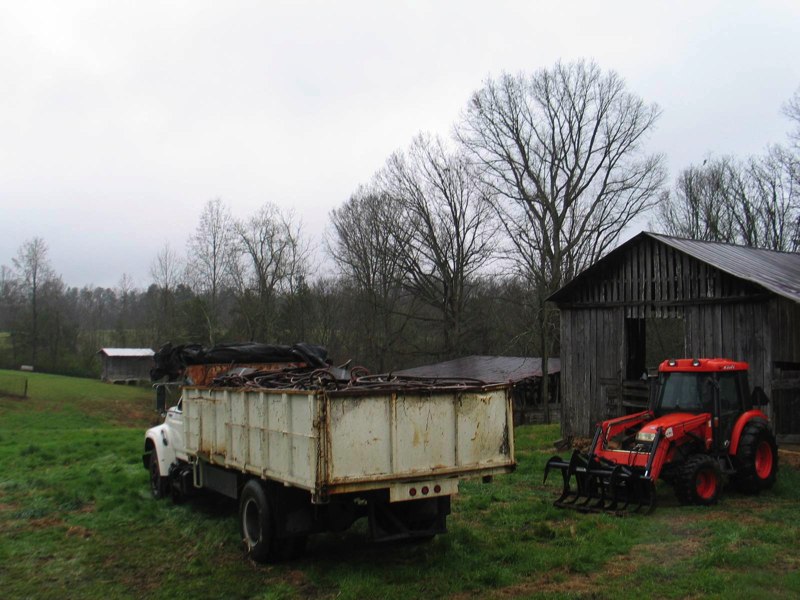

I bought a refuse dump truck last month have about $4500 in it. Hope to use it for a while and sell it. I had a lot of trash left on the property and just couldn't bring myself to pay someone to load and haul it off. It was a county truck - pretty well maintained.
It a 96 F700 140K miles 7 litre engine, and I believe since it's single axle and electric brakes, a CDL is not required. I've put about 400 miles on it and so far it's been great. I have a few more loads and I'll see if one of the neighbors needs it and let it go. There are so many chicken houses around it might be good for moving chicken feed.
