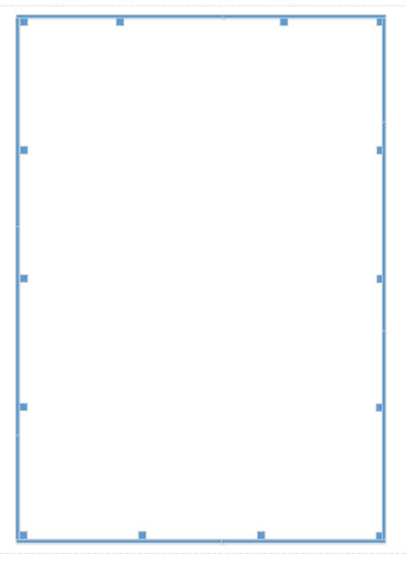

Now I'm looking to build something a bit bigger... 14 x 20... and really interested in a small pole barn style structure.
My first major question, since I'm not familiar with this building style, is about the poles. I would prefer to use 4x4s since they are easier to work with. I'll need 12 footers so that I can bury 4' and have 8' walls. A 12 foot 4x6 or 6x6 would be really heavy and hard to plumb etc. While I could use larger lumber and 10 foot spacing, I was thinking that I could use 4x4 posts and 5 foot spacing.
So five 4x4 posts along each 20 foot wall, plus two more posts along the 14 foot walls. Evenly spaced on one wall, but a bit wider on the other to allow for a 6 foot wide door.
What do you think? Some folks really frown upon 4x4 posts even in the smallest pole barns. Some promote 6x6 or even 8x8 posts.
I should also mention that I plan to use 2x4 girts and T1-11 siding. So the siding itself will add to the rigidity and support of the walls.
