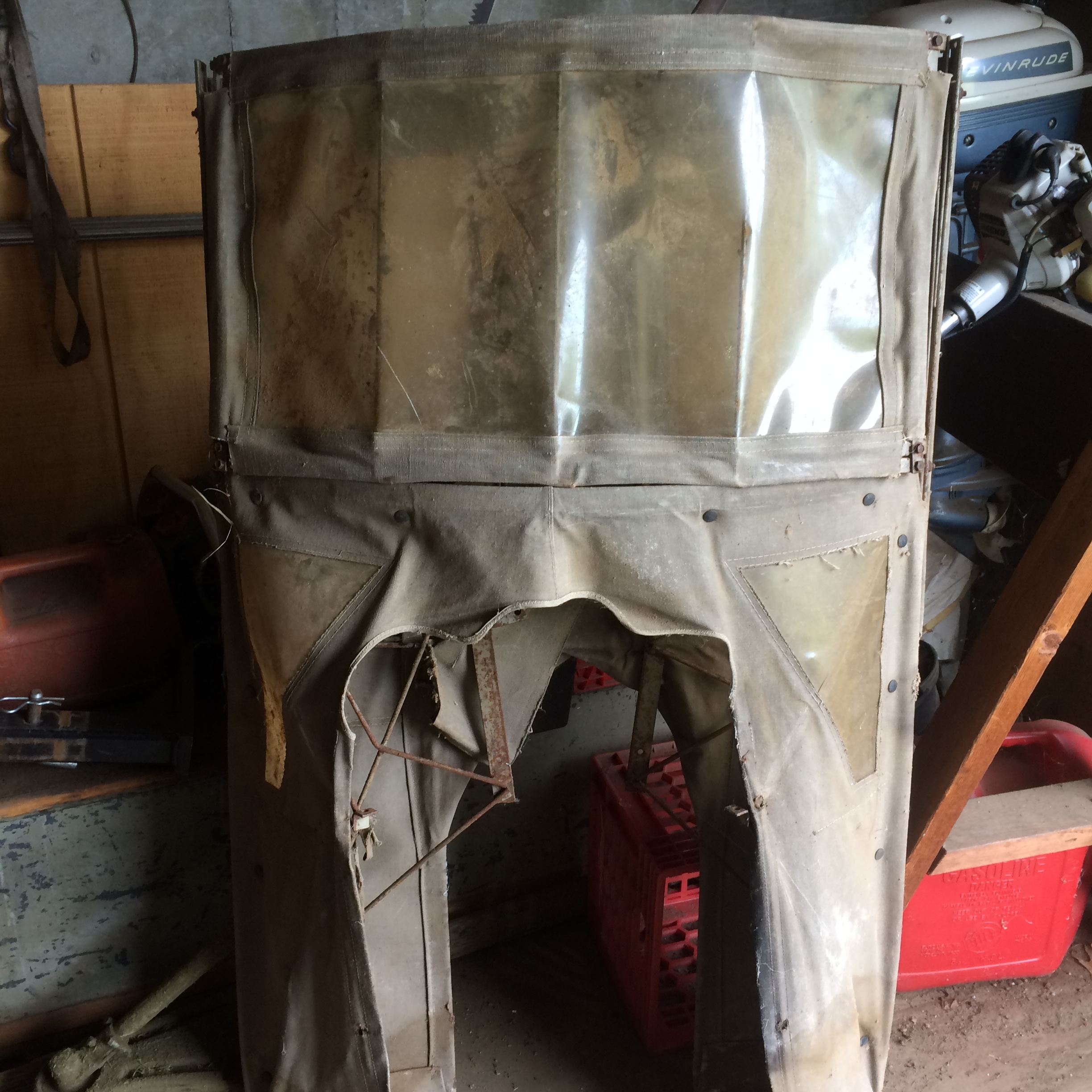

Dave found the old snowcab that his Dad used on the tractor. Hoping he comes across a couple other things, like maybe the right bumper for it. That'd be nice.
Here's a cell phone picture of the cab he found Saturday morning:
   / 1958 641 w/3 speed transmission and Sherman over/under unit #38
I had one that looked about the same condition. I wound up taking it off. Couldn't see through the "glass". Always trying to look over it or around the sides. Prefer the open air on a nice winters day.

Many years ago I pushed snow helping an older gentleman with a side business
He had an 861 and a Jubilee. Both had canvas heathousers with roofs and rear curtains. Warm enough to take off my coat. Good clear windows. Worked great.
The Jubilee was sooo much more nimble than the 861.
