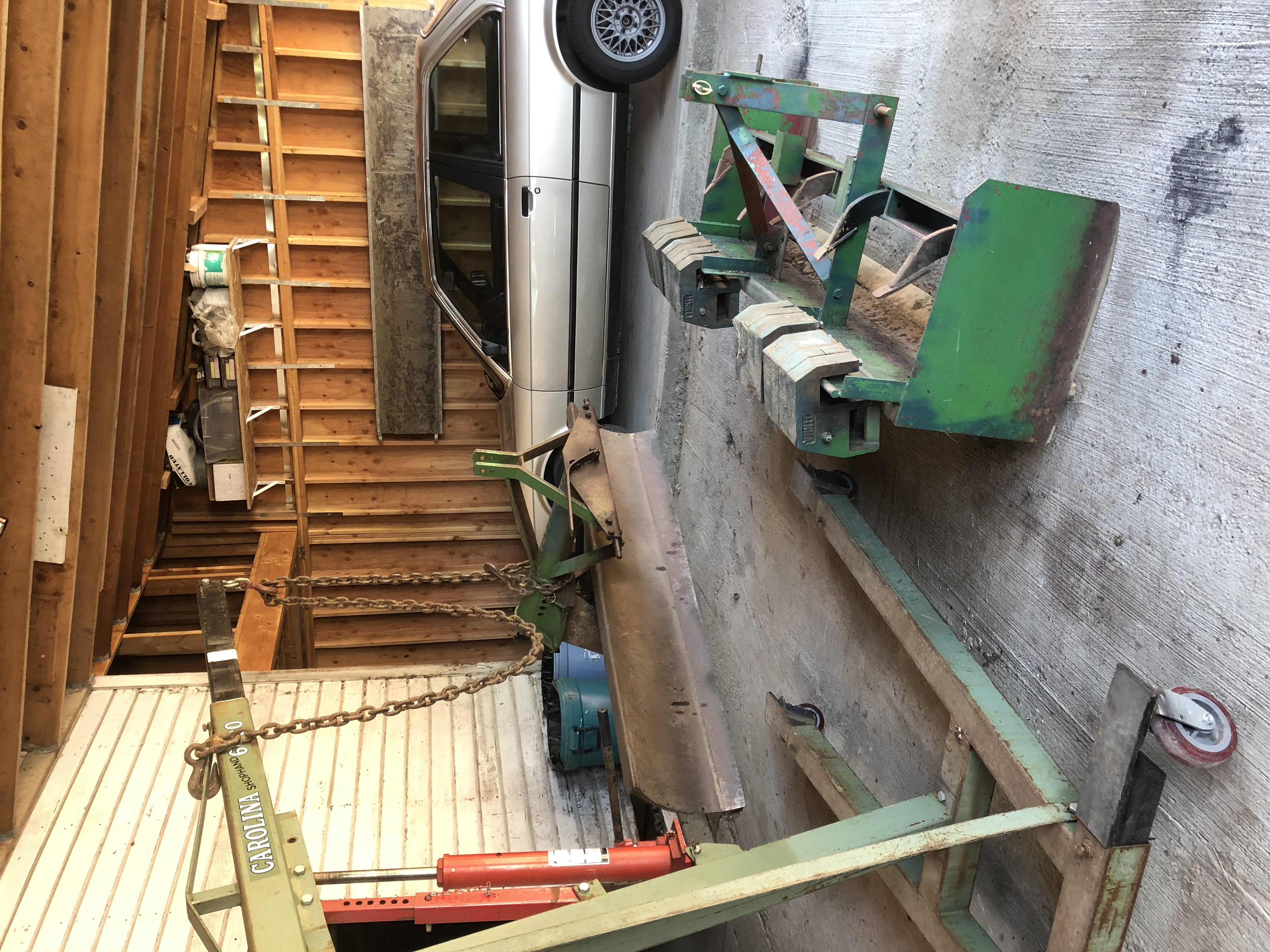

I finished the barn addition, and started to really get my shop dialed in so I can be the most productive I can.

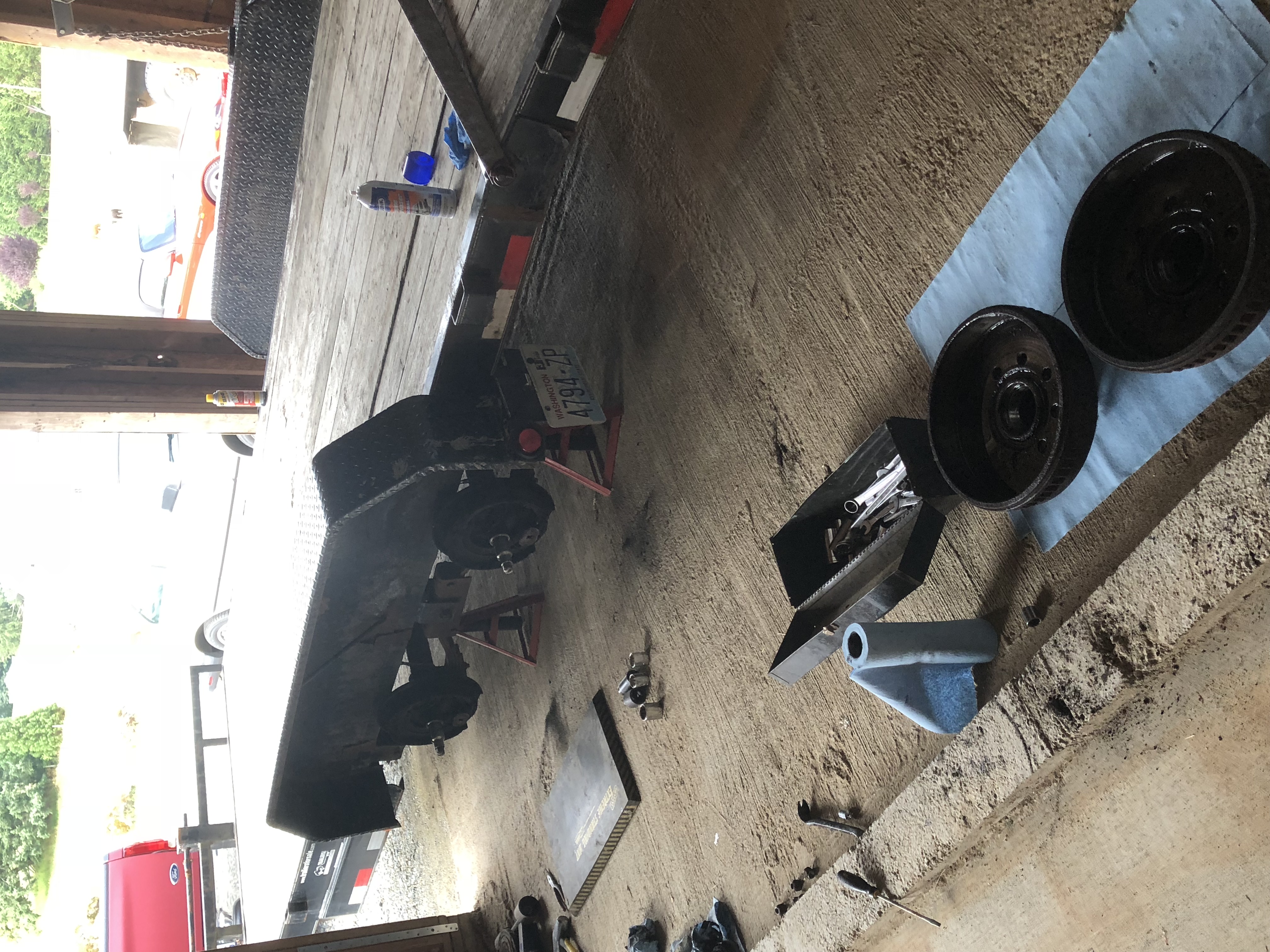

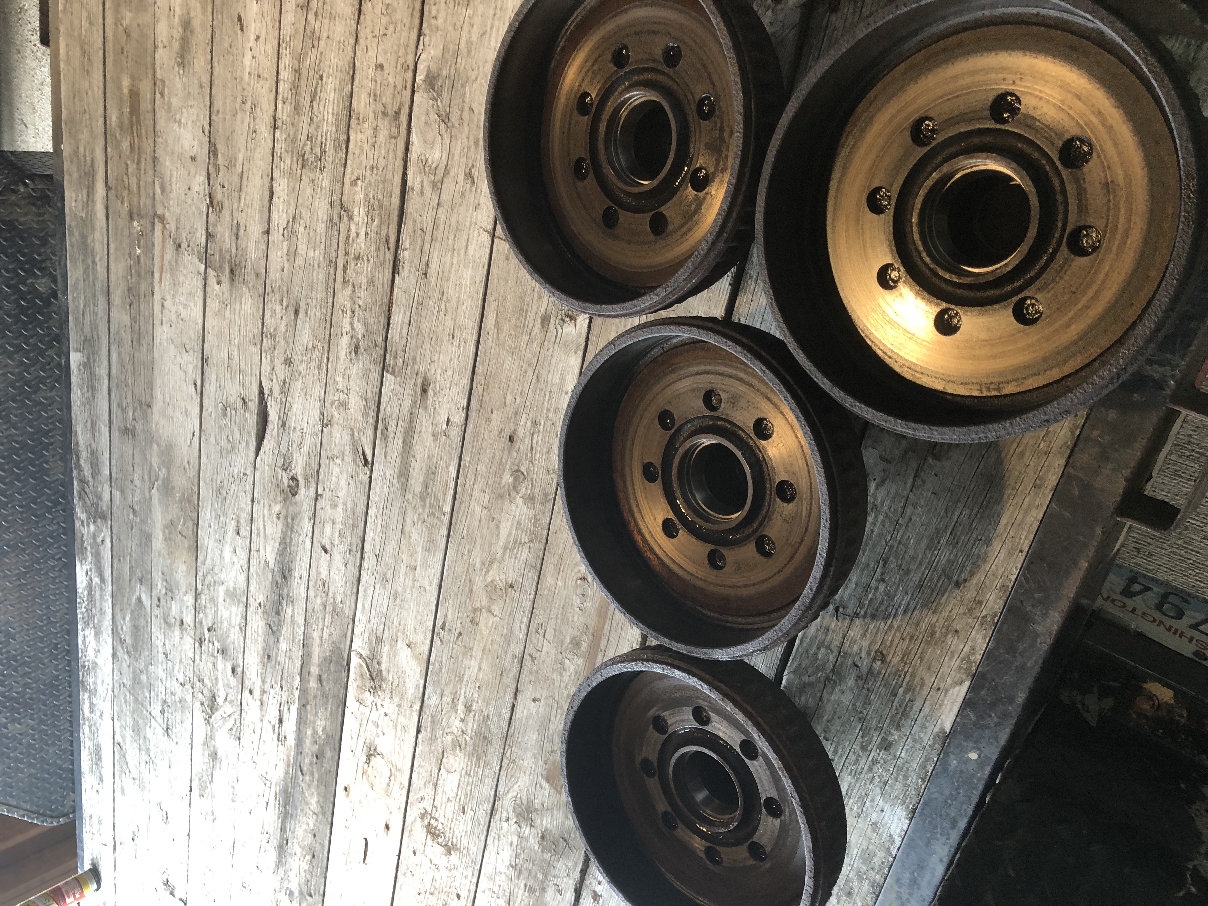

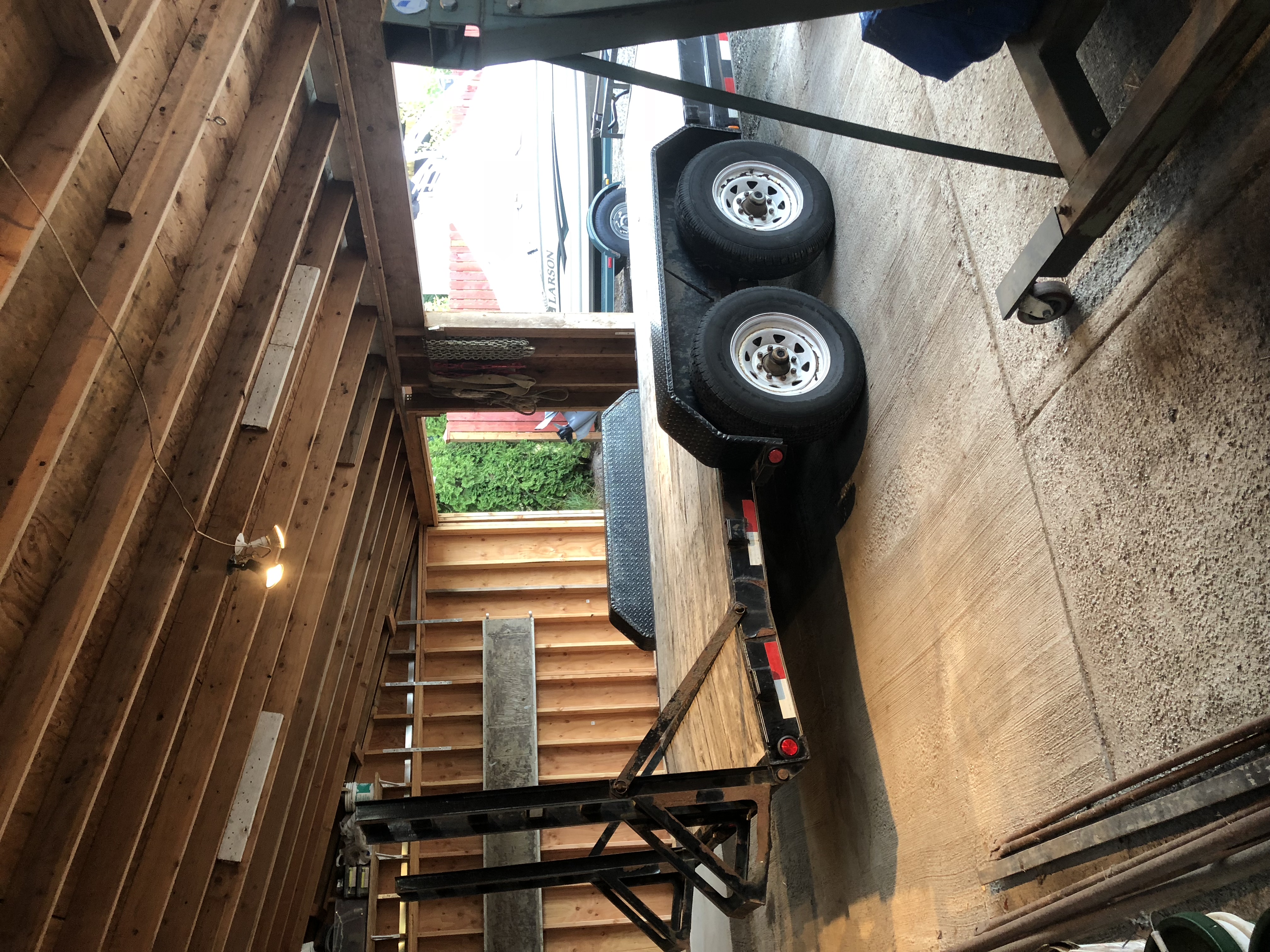

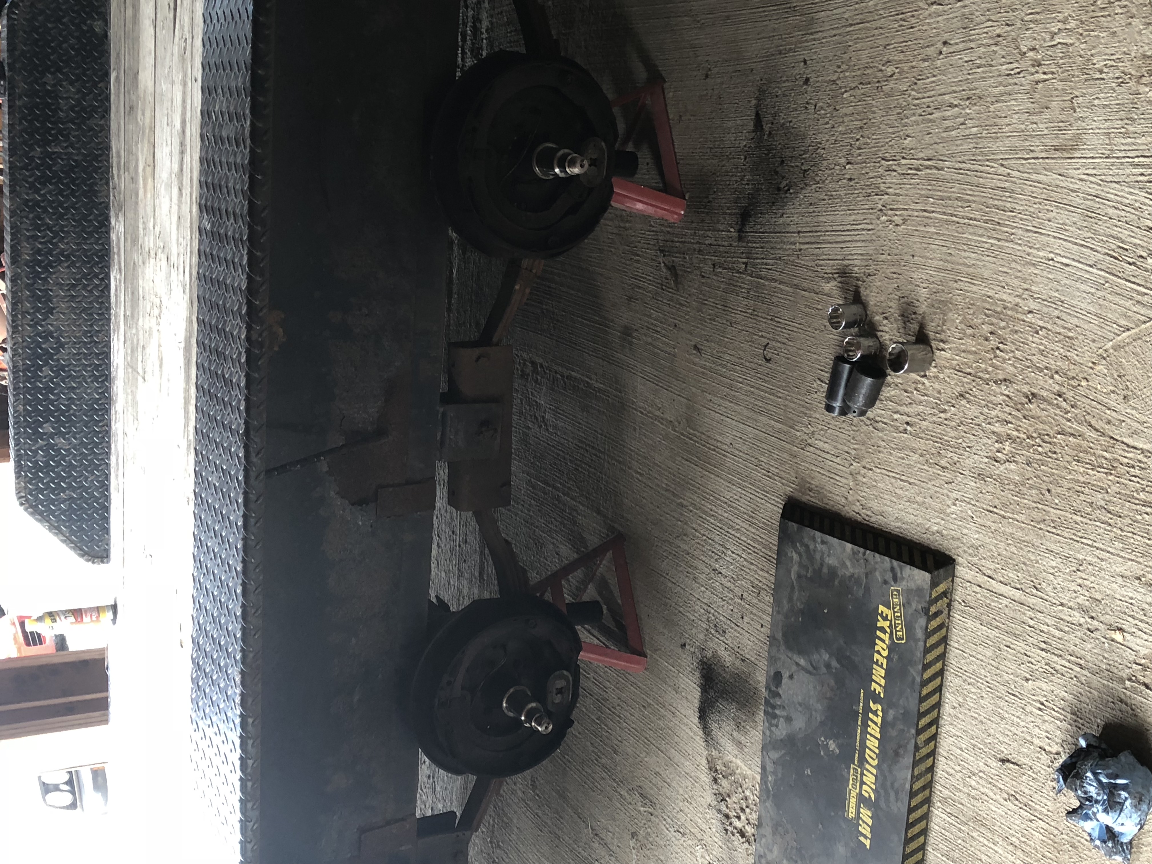

I also serviced my PJ 14K trailer as well. Put some new tires on the rims, did all the inner and outer wheel bearings, brakes, etc.

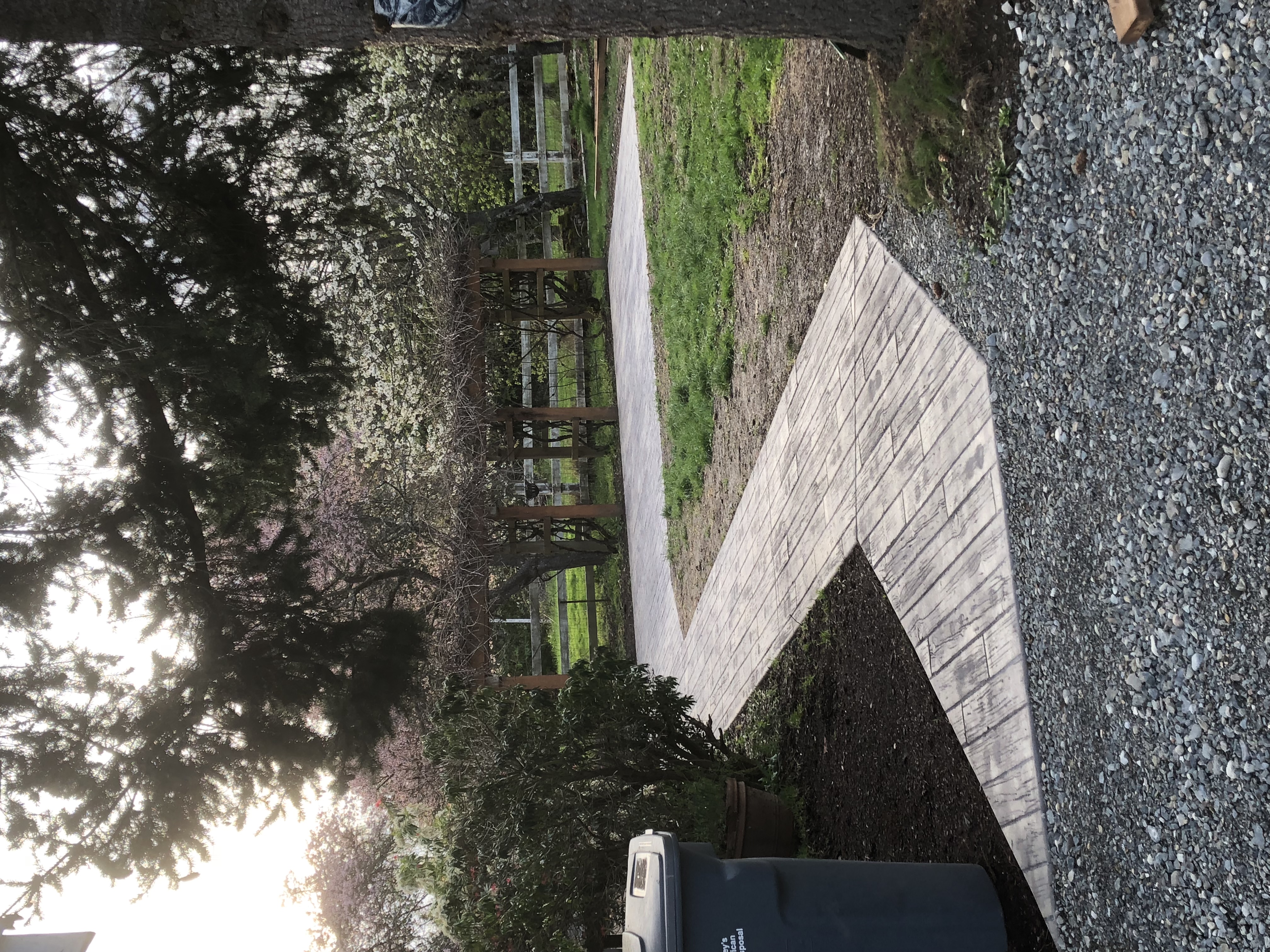

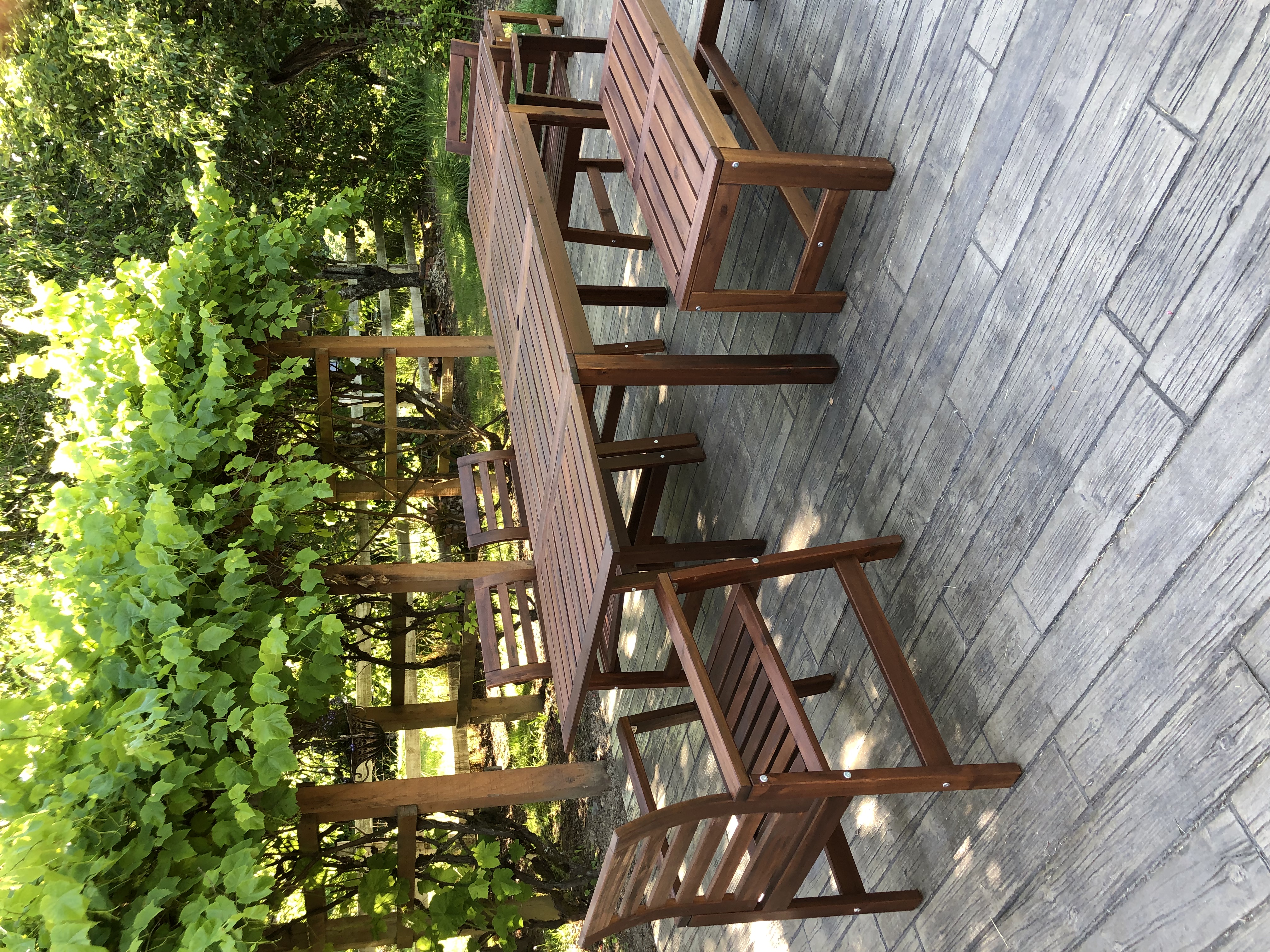

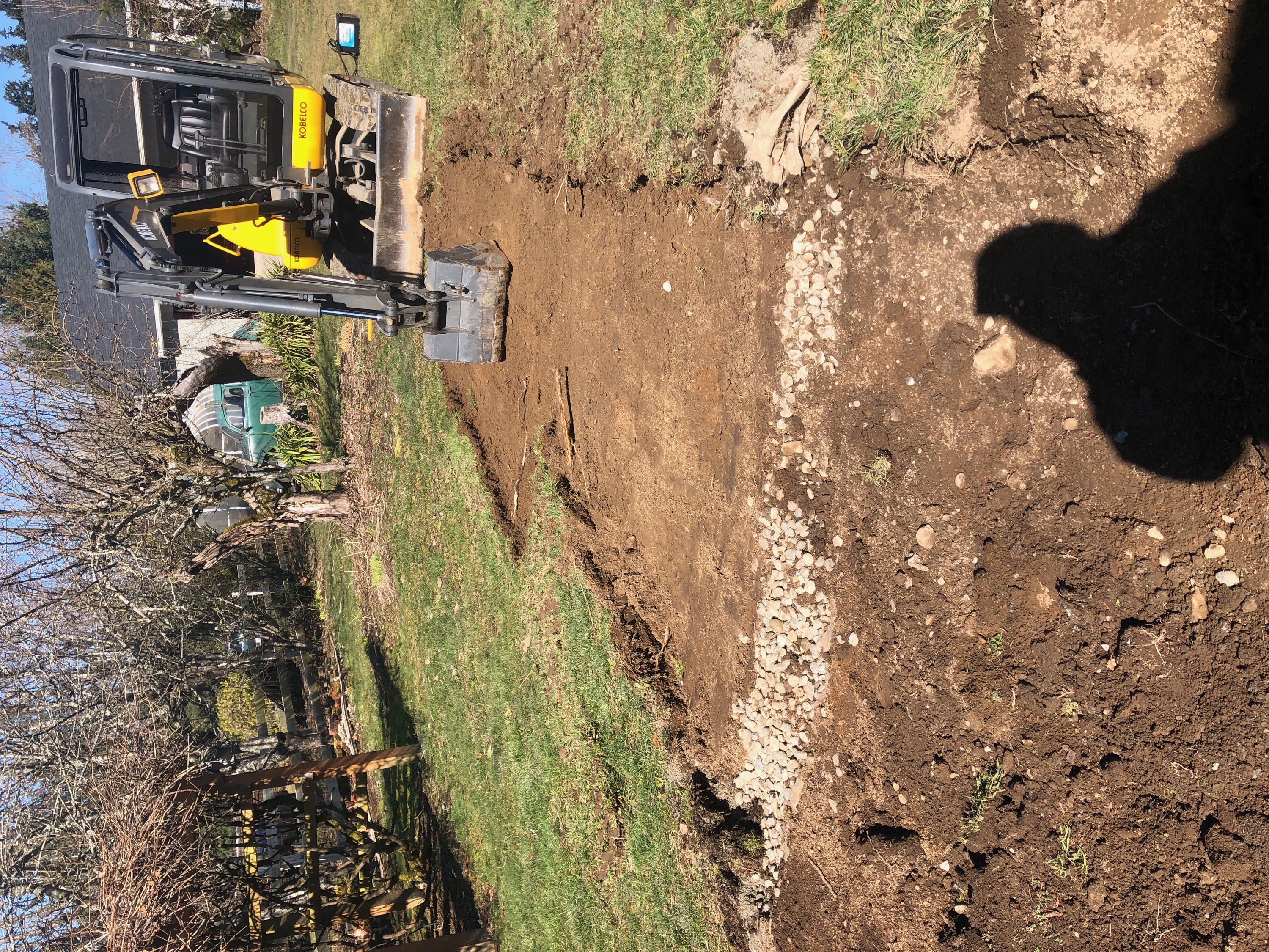

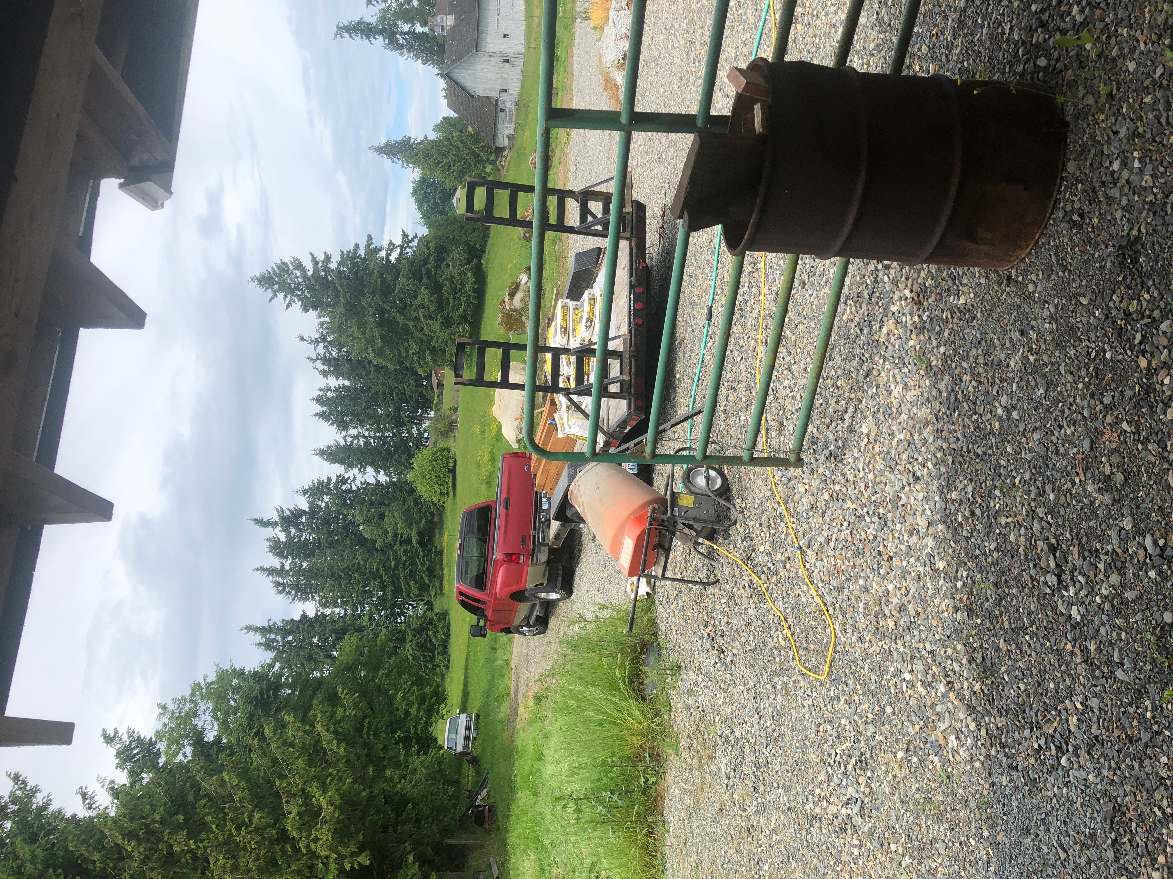

I recently added a patio. The old 1020D was a great help moving the spoils for me, and spreading my base course material. Its a colored and stamped patio with a 2 color design (integral base color and release antique color). It did it for my brother's baby shower!!! Gonna be an uncle very soon!!!

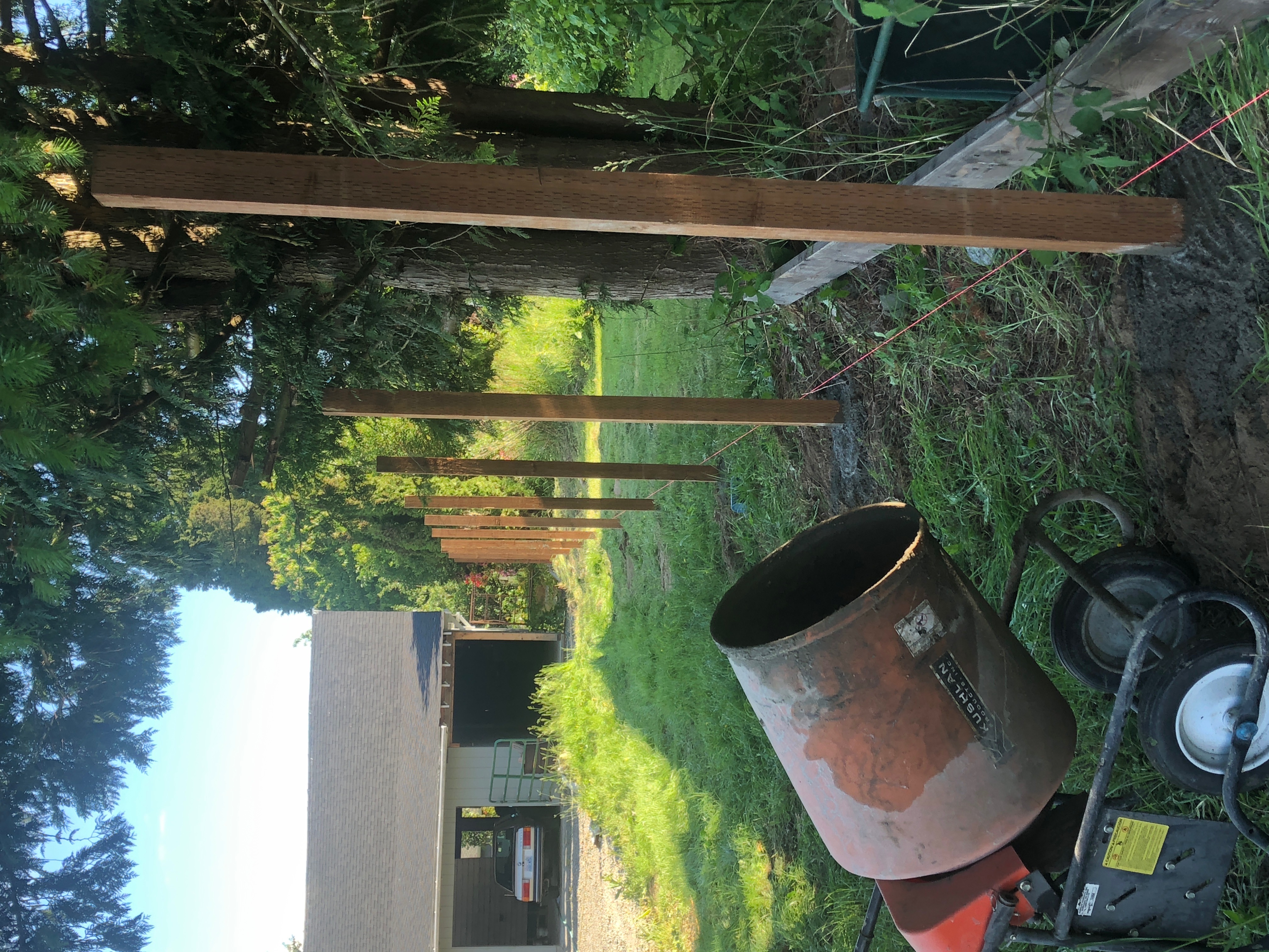

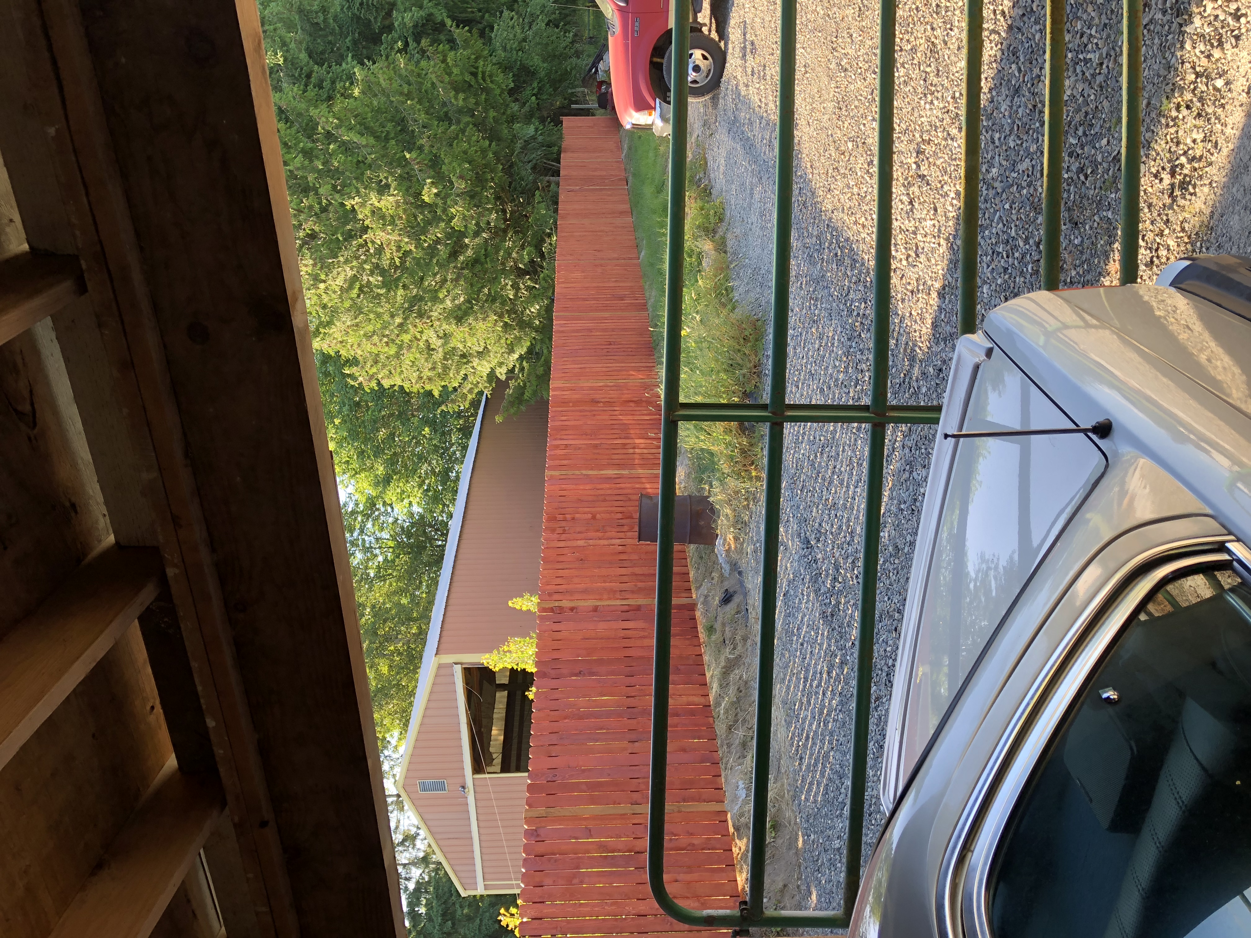

Then I started another project that I have been wanting to complete for a couple years now. Building a new privacy fence out back behind the barn. I have those type of neighbors if you know what I mean....sigh... I finished it up with copper post caps, and a redwood stain (2 coats).

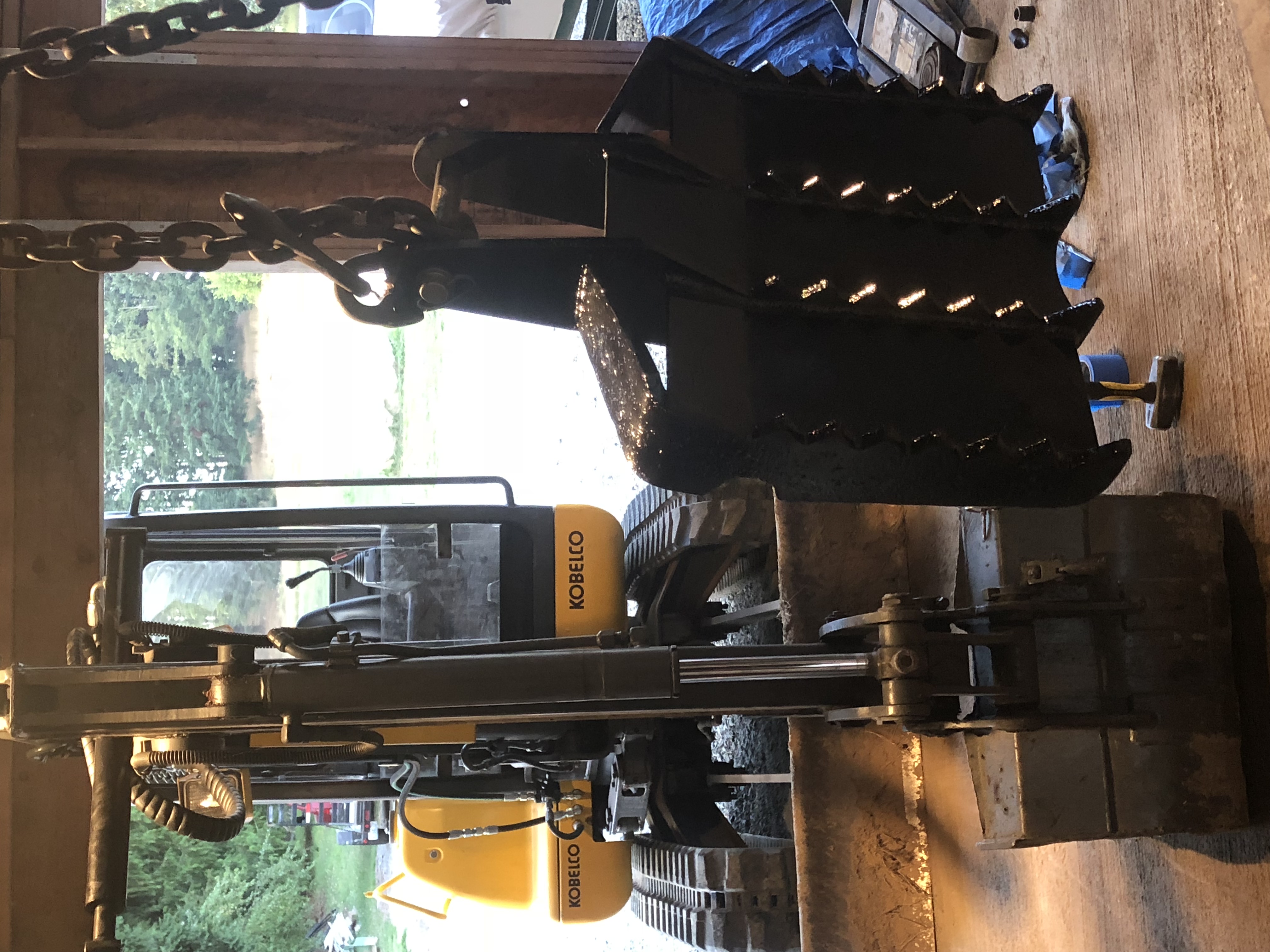

I also bought another piece of equipment. Its a Kobelco mini excavator. I have had it for about a year now, and just tackled adding a hydraulic thumb. Its was just me a my buddy. We learned all about built in pressure relief valves, locating the proper spool section in the manual, reading up on working pressures of curl cylinder vs. relief pressure of thumb cylinder, etc. etc. The thumb was homemade via my buddy. I just painted it last night.

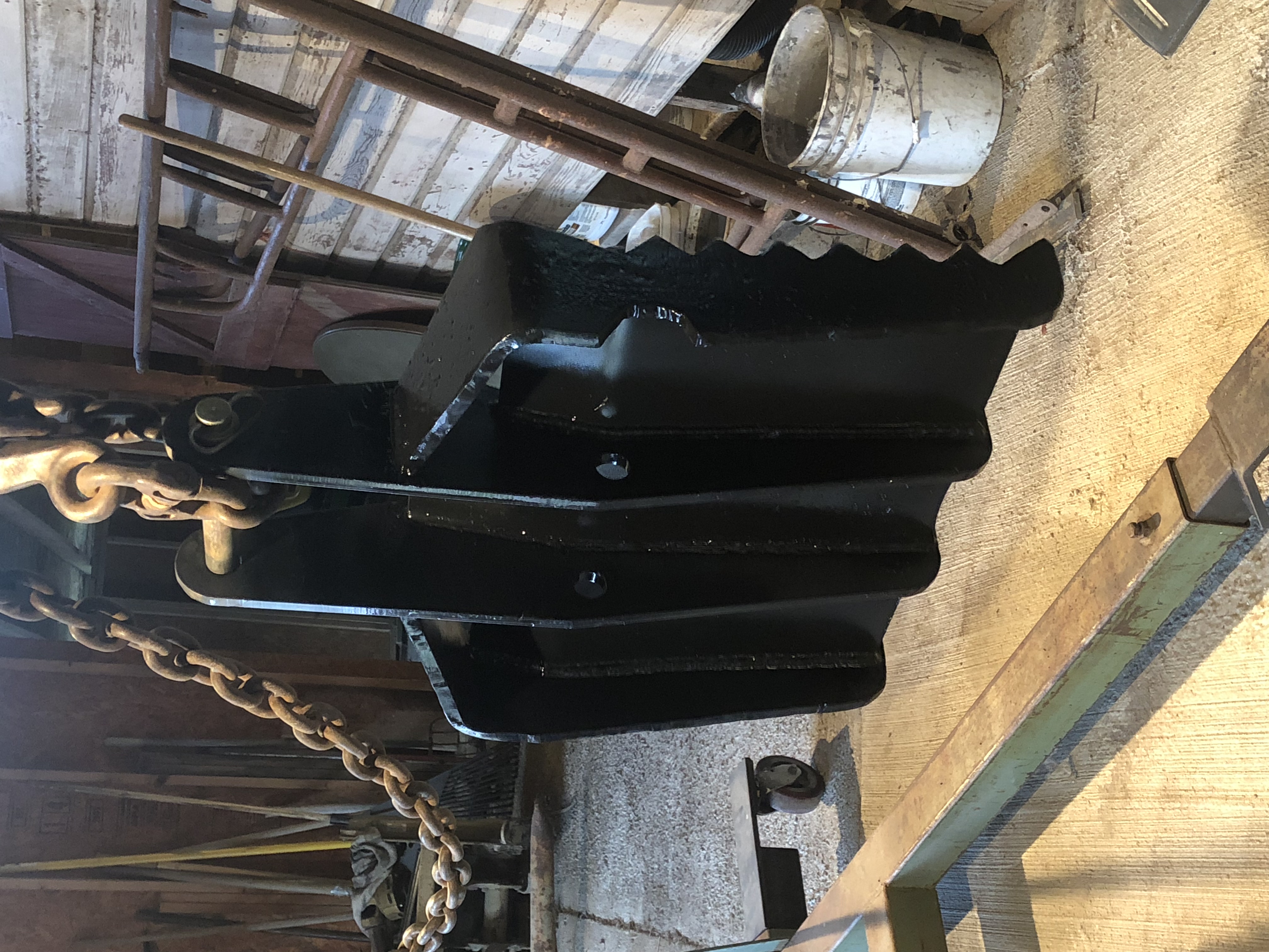

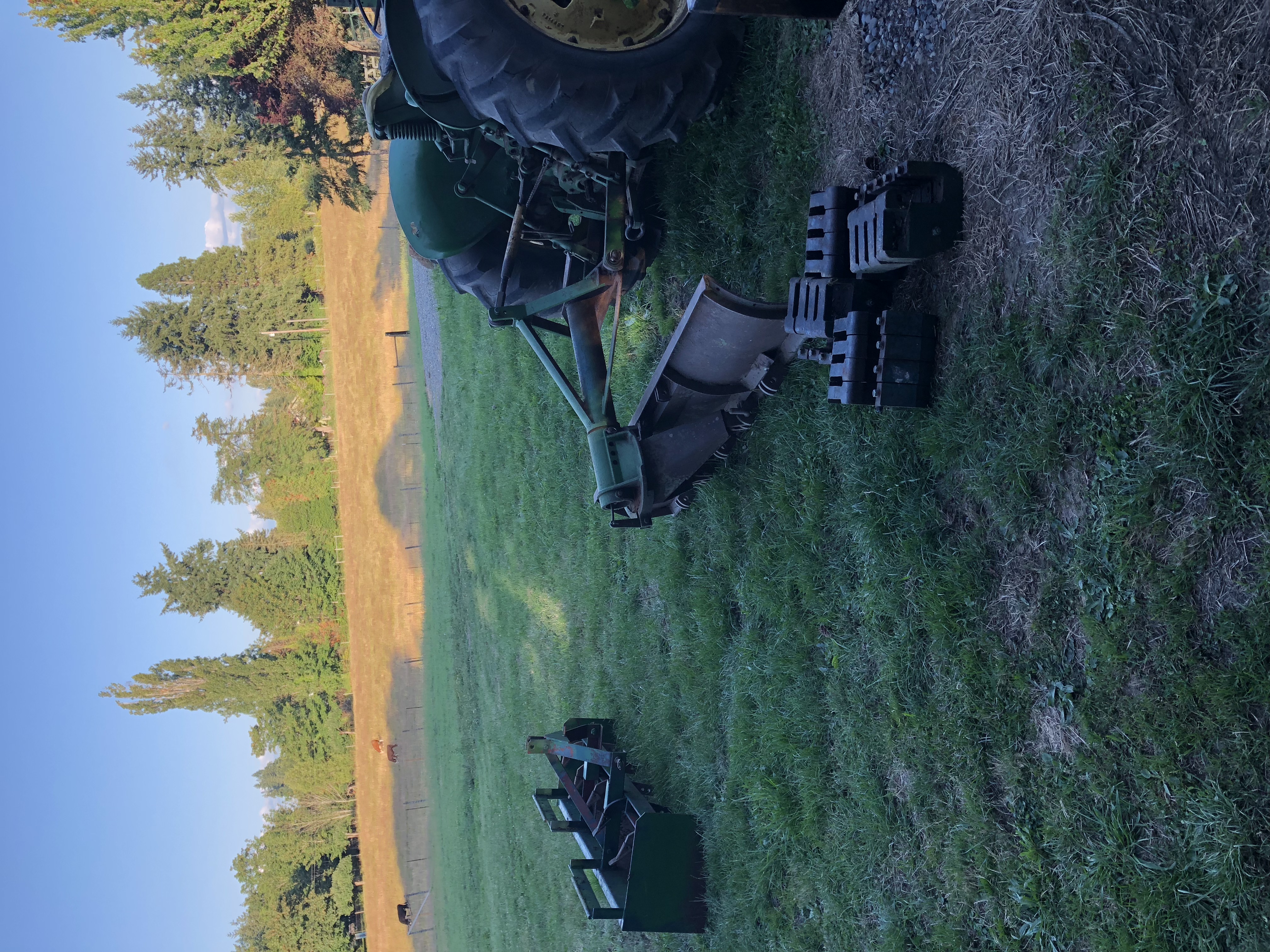

Finally, I bought some new attachments for the 1020D. I got rid of my Land Pride 6' ripper, and my Kodiak 7' rear blade. I then picked up an old school JD model 80-2 rear blade, and an old box blade with rippers. I tore the old cutting edge off the model 80 blade, and am attaching a new one. I cleaned up the box blade, and bought some new Cat. 2 pins, and ripper pins. The older stuff is so much better built its hard to believe the stuff they are selling these days holds together.

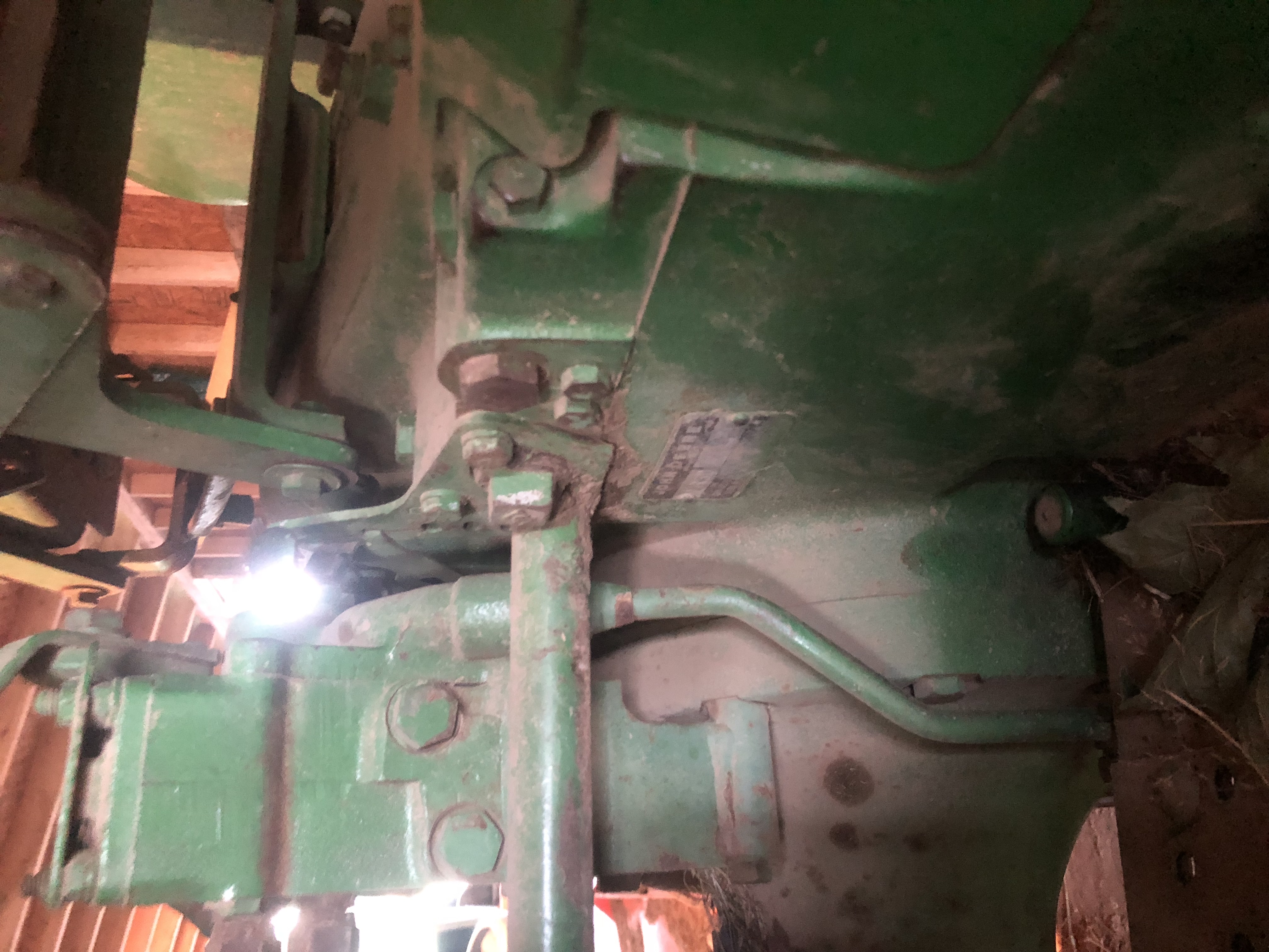

1) I want to confirm how my FEL is plumbed. I also would like to know how much my tractor with FEL weighs (I know get on a scale), just a good estimate from you all? Tractor Data says ballasted, my little 1020D weighs about 6k. With my model 47 FEL, I am thinking that number goes to 7.5K. Then adding any of my heavier attachments, I would think another 800-1k , the total would be right around 8.5K? Does anyone know the approximate weight of the JD model 47 loader?

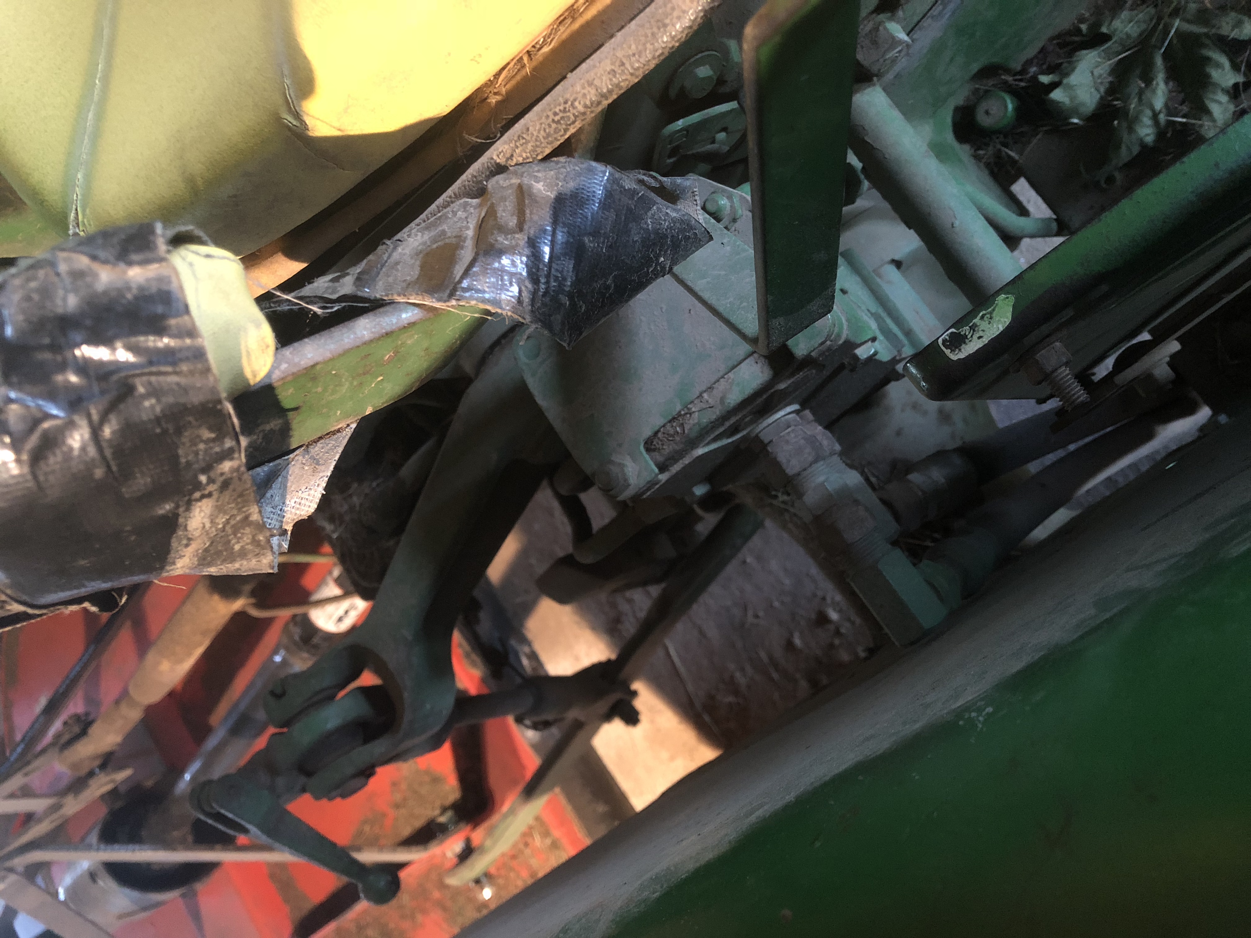

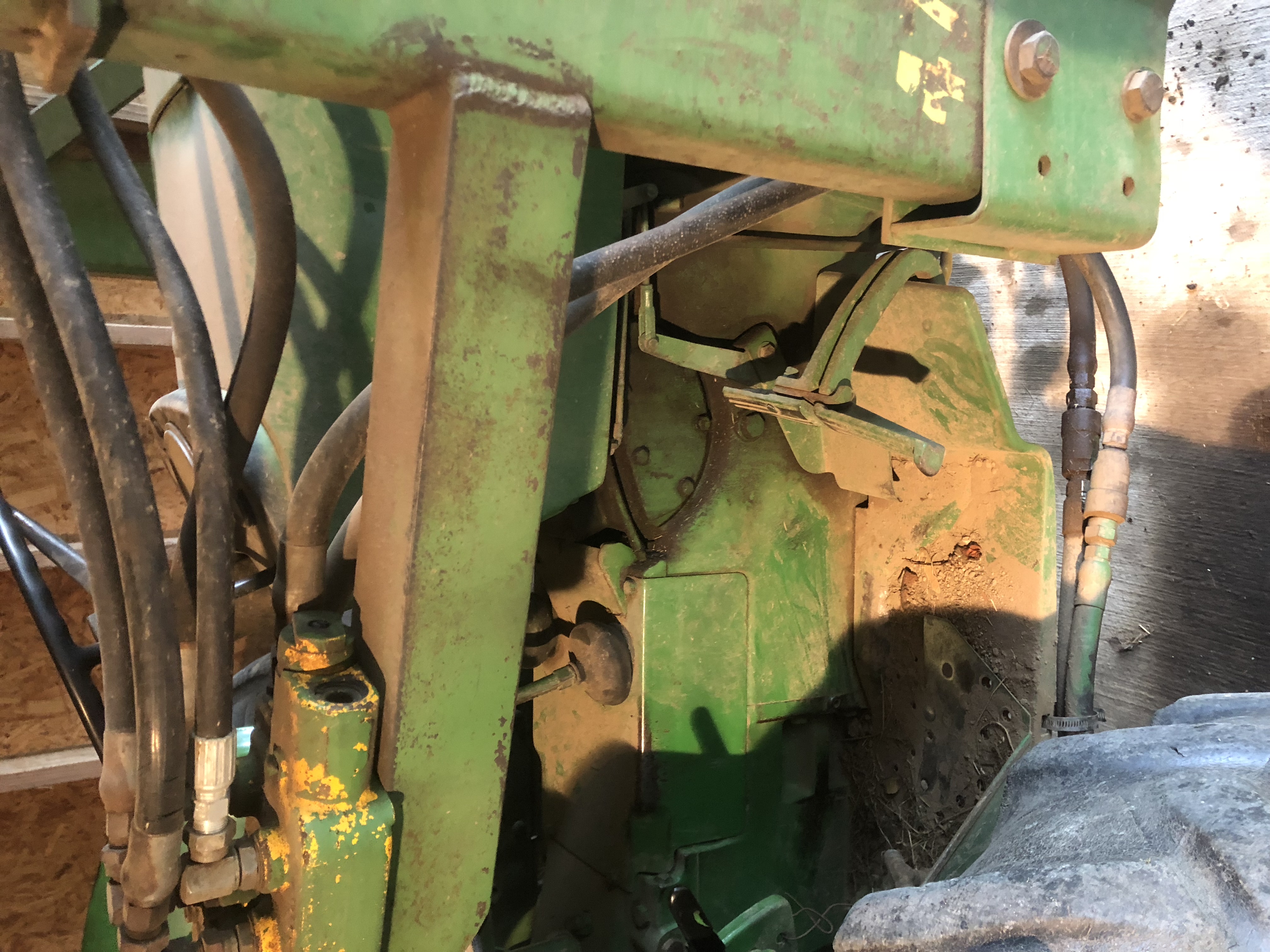

Here are some photos of my tractors hydraulic plumbing for my FEL. All this talk on the forums on how to properly plumb this FEL to my tractor talks about a ported filter cover, where the FEL return goes to. People say this is the "right way" to do it. It seems that I have the half *** way, and my FEL is plumbed into my SCV? Can someone please educate me on this topic as a whole? I want to one day add a hydraulic top link to run off of my single set of rear remotes. With that being said, because my FEL is plumbed directly into my SCV block, will with affect my hydraulic top link install?
EDIT!!!!
Per this post below, it seems I already have a ported filter cover??!! My filter cover looks just like the one shown in this thread via Tx. Jim. I thought that was just a drain plug hahahaha. So does this mean I just need to run one of my FEL hoses to that port?

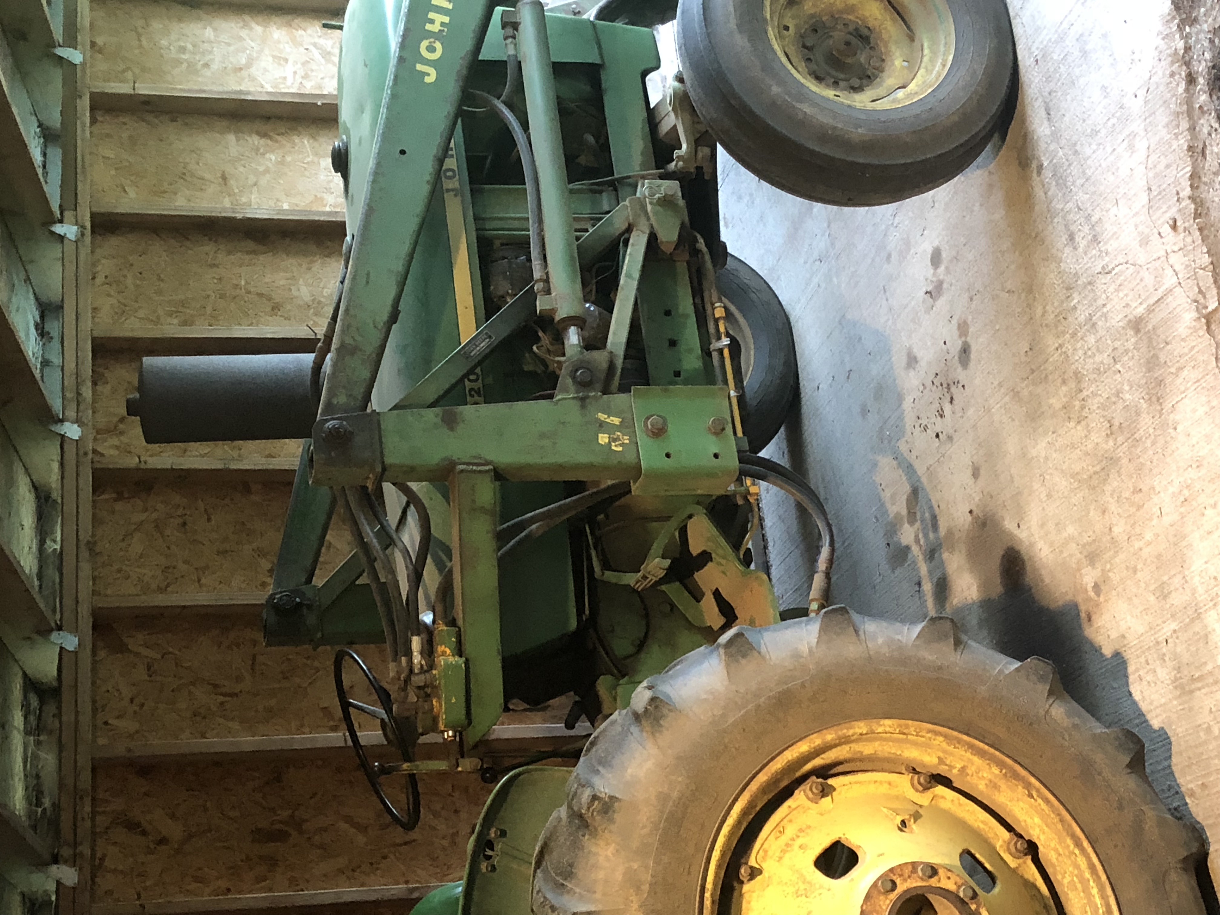

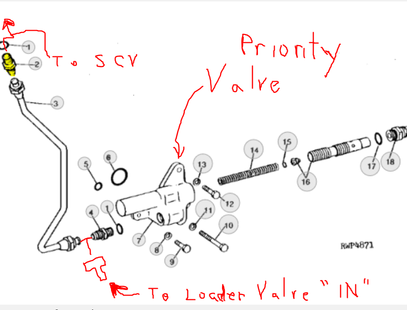

I could not tell from your pictures how your loader is plumbed.
Does it have priority valve? If so, you add a Tee after the priority valve and connect the supply line to the loader valve to the Tee. The return line from the loader goes to the ported filter cover.
