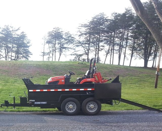

I've had several Load Trail and PJ trailers. They are built by brothers. I think I am going to sell my current HD R&R aluminum deck-over 16 footer for a steel deck-over. I ordered this R&R with custom HD ramps specifically for my tractors, but used to use it for hauling quads. That phase of my life is all but dead since the kids are growing up and college is on the horizon. This trailer is somewhere near a 4,500# capacity, with all LED lights, dual brake axles and five-star aluminum mag wheels. It looks great and handles so well with torsion axles, but it sits 364 days a year. If I can get a steel trailer again, I'll let my dad use it for his heavier tractor, and then we both can split the cost. While these dump styles look great, they aren't as functional for my use.
