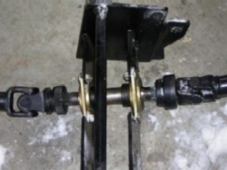

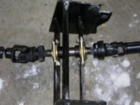

I have a couple of pics that I took of the drive shafts phased correctly and incorrectly.
They are on my computer at work. I will post them on Monday.

Shaft phasing pics on 2210 front pto. Pic 1 is correct and pic 2 is not.
   / 2305 with 47" 2 stage snowblower question #58
Where's the difference at?? I'd like to know... thanks Labrat
   / 2305 with 47" 2 stage snowblower question #59
If you look at the "U" Joints you will see how they aren't right in the second pic. I got to run my blower this morning (8 inches) and the same thing happened. It got noisey and then bang, sheer pin. I turned on the heat in the shop and just looked at it. The fan/impeller would move at least 1/2 inch forward and back. I loosed the 2 set screw (had to use a torch to melt the loctite) moved the collar back and tightened it al up. It runs dramatically quieter now. I will check my shaft alignment in a little while and let you know if that makes a difference. It seems that when I lower the blower below level there is something in the drive line causing noise. I think its probably the front short shaft bearings so I will check there first. Thanks for all the help.
