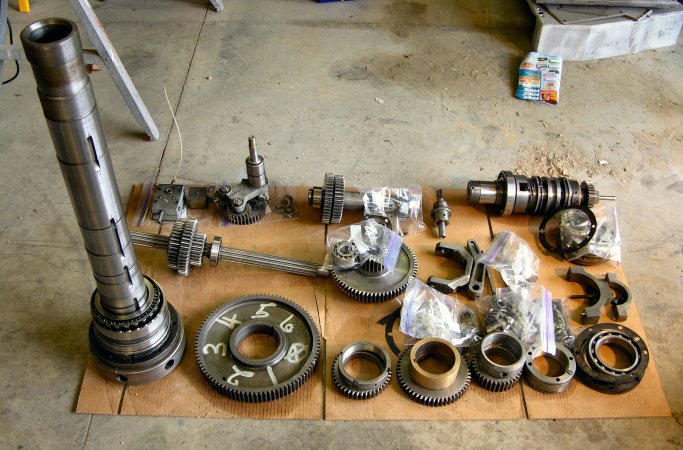

Here's the whole kit and caboodle that came out of the headstock. These parts still need to be cleaned up and inspected for wear.

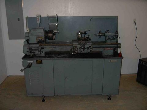

Nice machine! It looks like it will be at least as good as new when you are finished.
It dwarfs my little 11x35 Atlas. Delta actually sent me a free set of manuals when I inquired!

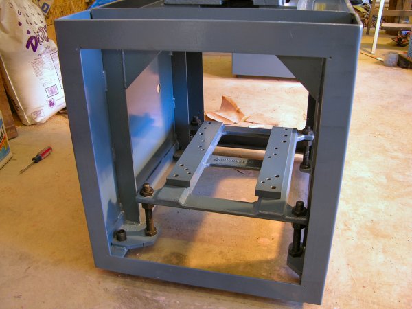

I was finally able to get the motor mounts bolted in place in the lower pedestal. All the nuts, bolts, and fasteners now have a black oxide finish.

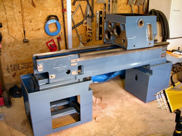

The headstock has now been placed on the main bed for final preparation before reassembly. There's a brake/clutch shaft that exits the headstock directly from the bottom of the casting and that piece will need to be installed before the headstock can be slid into its final position.

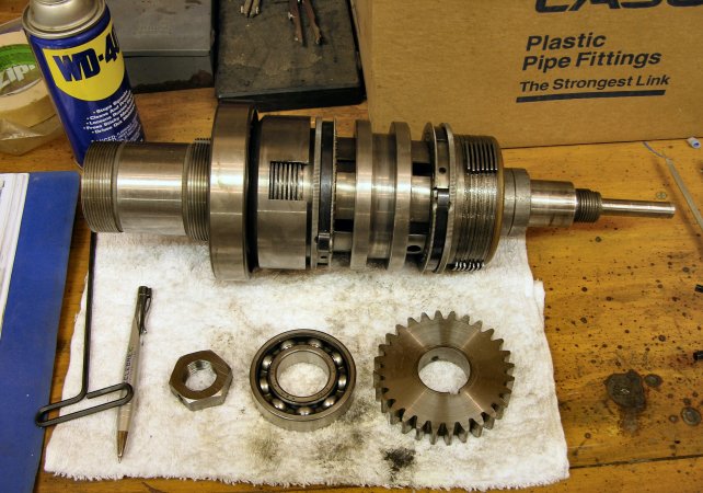

Well the headstock has now been reattached to the lathe bed. I cleaned up all the surfaces where the various gaskets and bearings will meet the metal and it's time for reassembly of the headstock assembly.
This is the clutch/brake assembly that transfers the energy from the 5 HP 3 phase motor to the gearbox via the single gear shown (lower right). This assembly uses multiple disc's much the same way as an automatic transmission in a automobile however in this application the clutch/brake mechanism is operated manually. The smaller shaft extension on the right side drives the main oil pump that keeps all the gears within the headstock well lubricated while in operation.
This assembly along with the associated linkage will be the first fitted into the headstock.

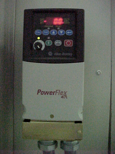

Cool, I did not know you could use single phase input, all the ones I have in my plant are 3 ph in and out. This is what I use, i think it's rated for up to 5 hp also, about $500 brand new from Allen Bradly. The pic might be deceiving, it's only about 6" tall X 3" wide.
