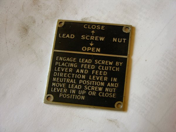

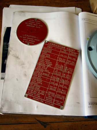

Today we took all the old scratched and faded tags on the lathe and made them look like new. Here's where we started.

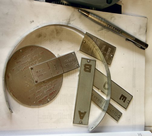

After a soak in the liquid paint remover they come out looking like this.

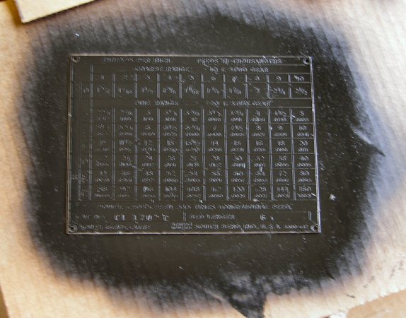

Then they are placed on a piece of cardboard and spray painted a heavy coat of satin black enamel.

Once the enamel has throughly dried I invert the tags on a piece of wet fine sandpaper that is sitting on a flat surface and slowly work the tag back and forth to remove the paint on the high areas of the tags. Here's how they will look when finished.

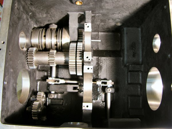

Today it was time to start reassembling the headstock. Here you can see the clutch/brake (input shaft) including all associated linkages in place. Also installed is the constant speed shaft, and the reverse bracket and gears.
I almost got the main oil pump installed but when I tried to install the 1/2" external snap ring to secure the pump on the input shaft the ring popped off the snap ring pliers and went who knows where. Did hear it bounce off the wall of the pole barn though. /forums/images/graemlins/frown.gif I'll make a trip to Home Depot and get a replacement tomorrow.
When I was installing one of the shafts It was a real PITA to get all the gears lined up correctly on the splined shaft. Took me about 45 minutes with help to jiggle it all around so it would finally slide home. Then thinking all was successful I stepped back only to realize that a spacer washer was still in my hand, yup you guessed it, the washer was supposed to be the 1st thing to go on the shaft before anything else (I was holding it so I wouldn't forget about it). /forums/images/graemlins/crazy.gif Might not have been funny at the time but we're chuckling about it now. I did get it right the second time around and got quicker at putting it together too! /forums/images/graemlins/grin.gif

Randy thanks for the help you gave me on that shaft. Don't think I would have got it without another set of hands.
