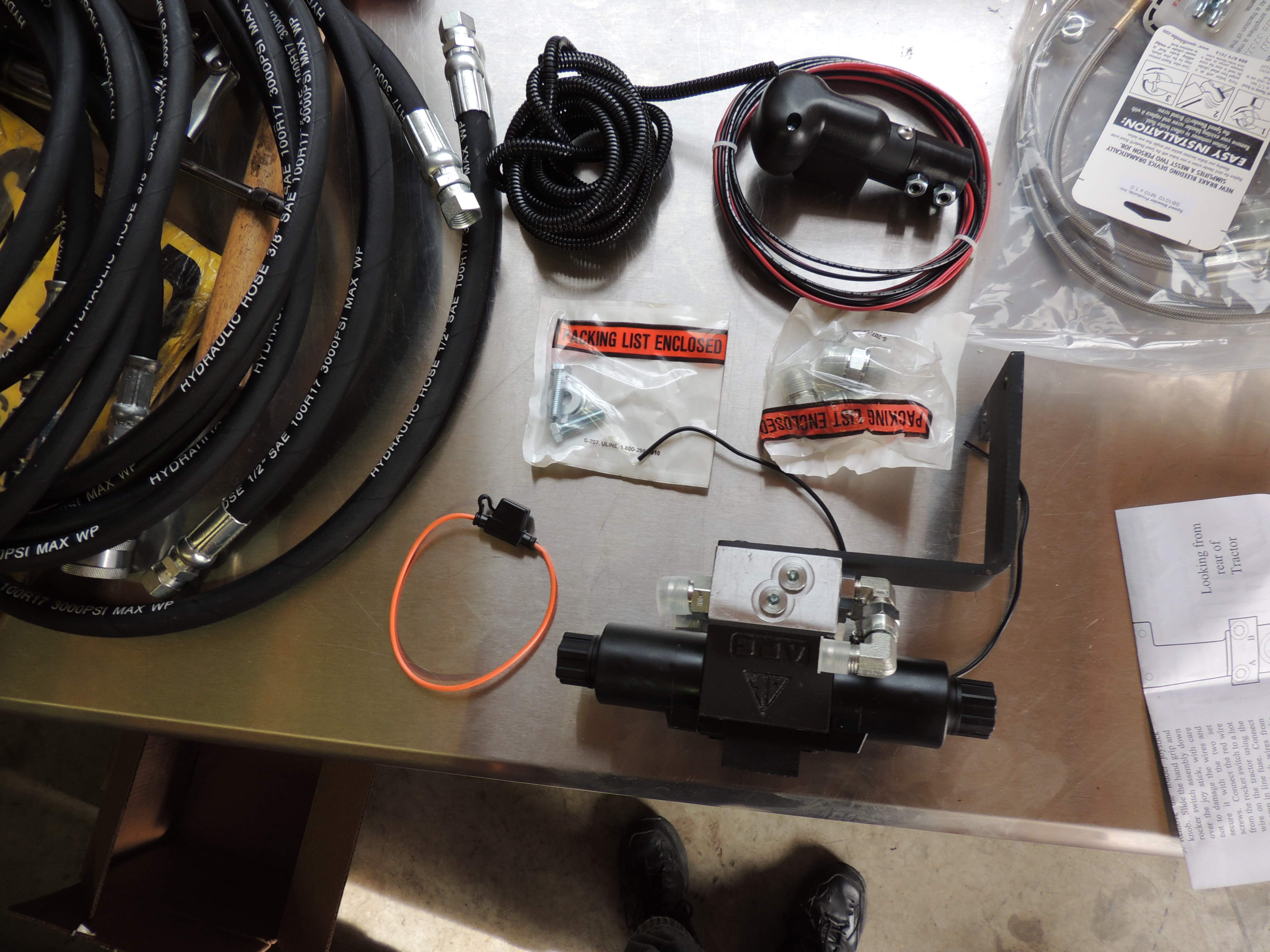

First, here is the kit from EA that I got that is specific to the Kioti DK40SE. The hoses are to the correct length and the mounting bracket for the 3rd function valve is specific for mounting as you will see in a later pic.
You can see here the valve on mounting bracket, 10 amp fuse, new handle for FEL joystick, bolts for mounting bracket, adapters for the Power Beyond (PB) under the seat and the PB port on the FEL valve, and lastly the hoses (6 of them), 2 for the PB, 2 to run from the valve to the loader, 2 to run up along the loader arms to the grapple.

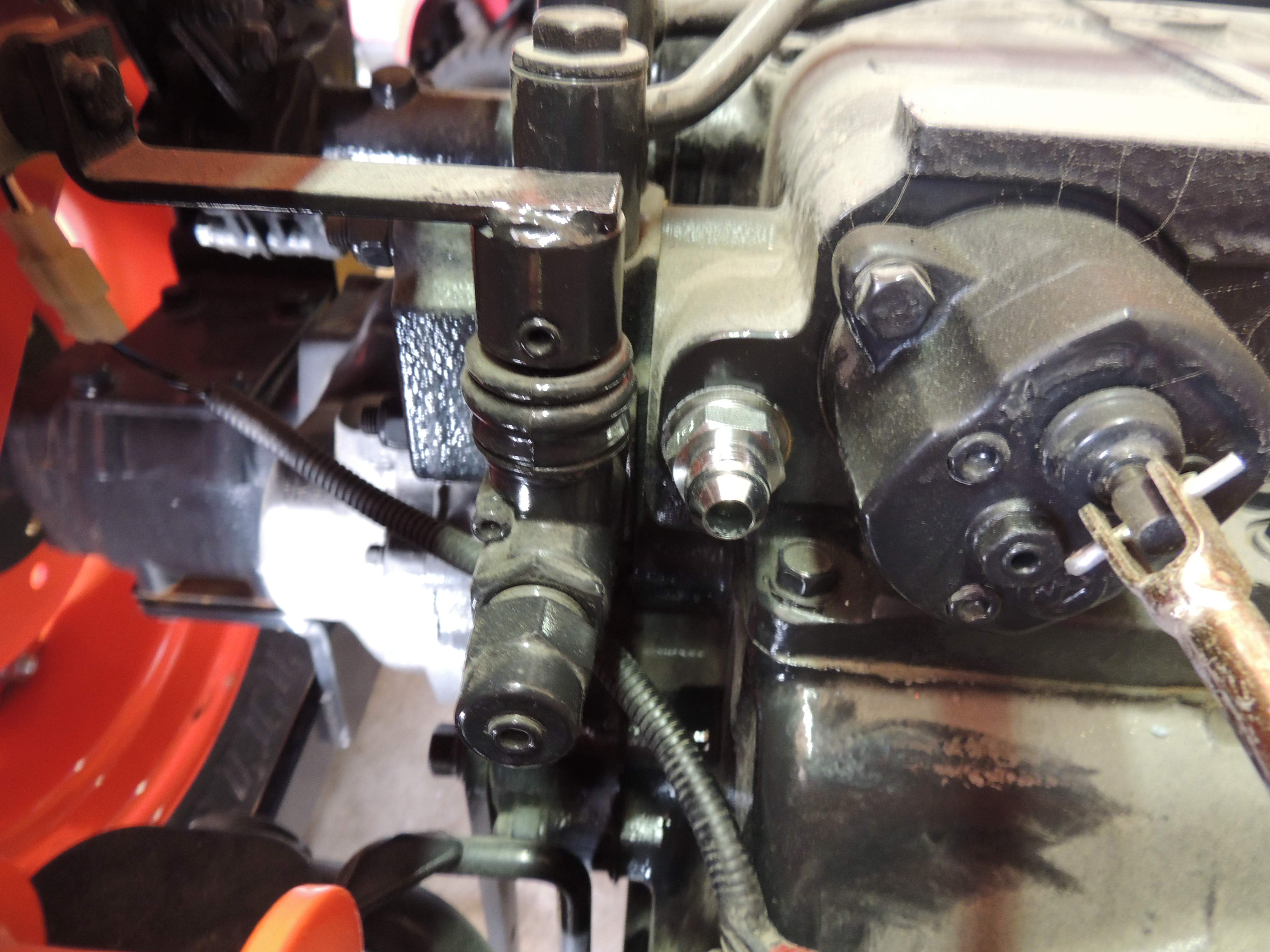

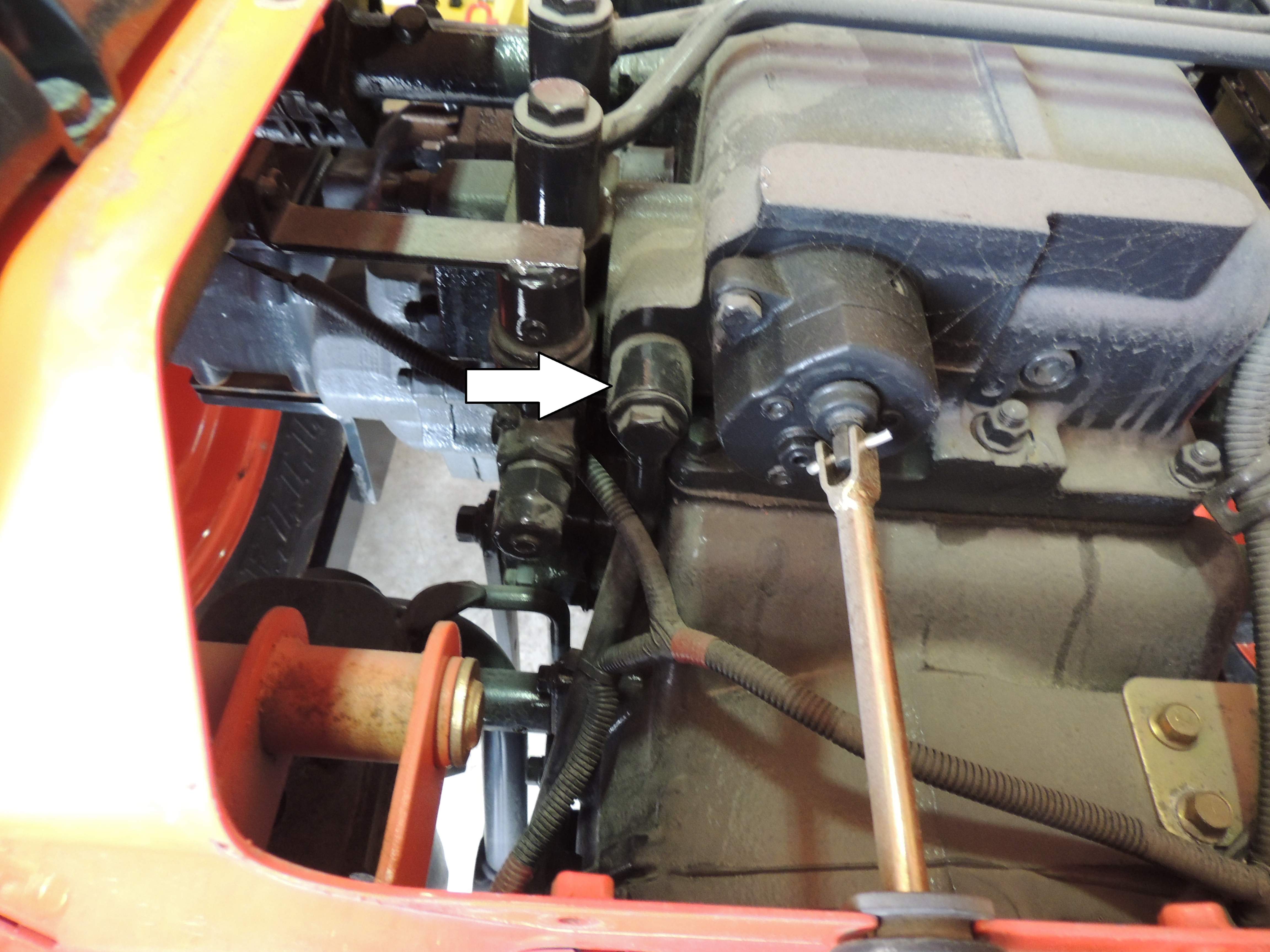

Here is the seat removed and you can see where the PB connection is:

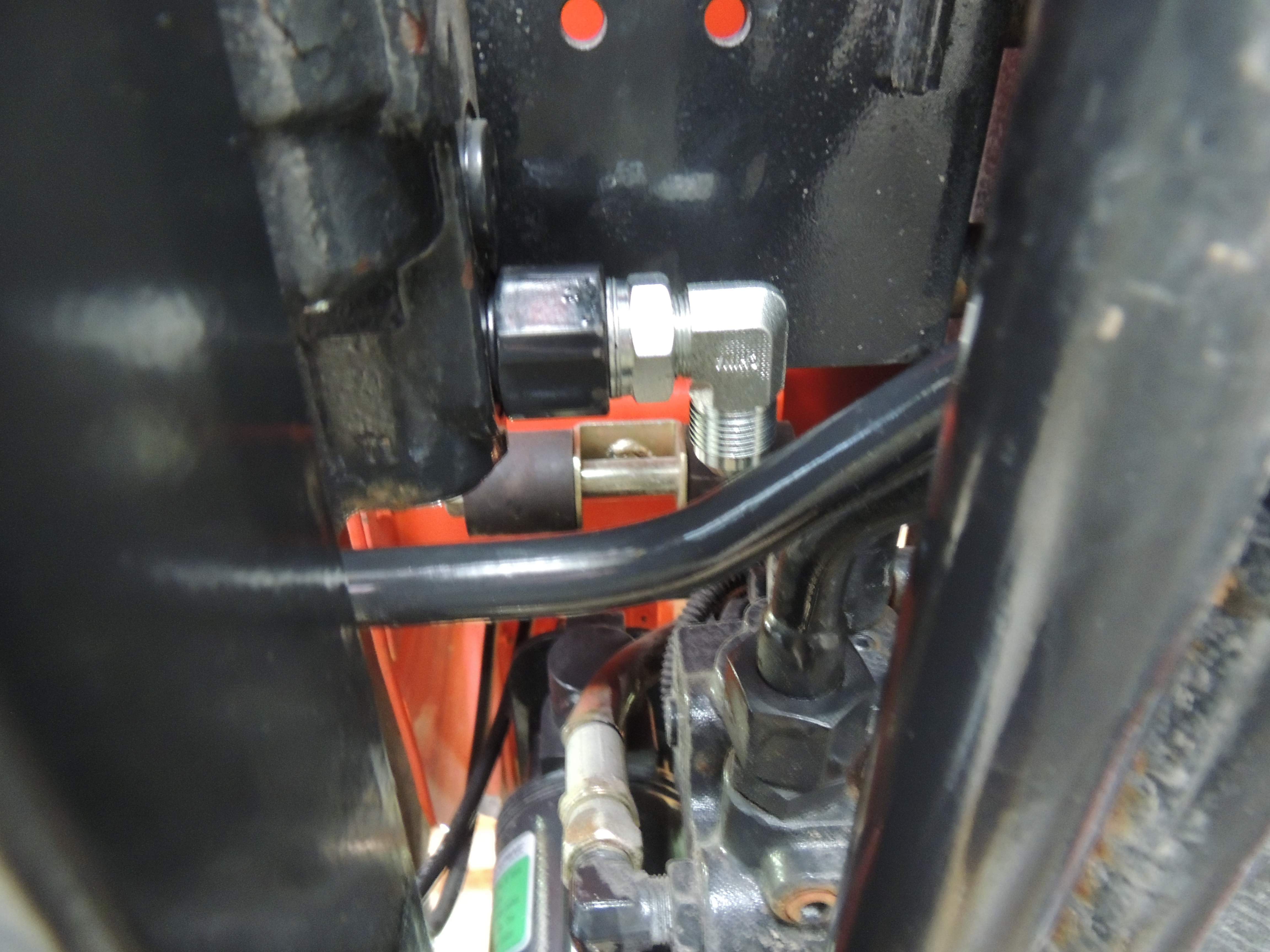

Here are the 2 adapter installed, first one is the one under the seat, the 2nd one is the one on the FEL Valve which is located under the right floorboard
The one under the seat is easy to install, you can use a socket. The adapter on the FEL valve is a little harder since there is limited space to get a wrench, but it you keep moving the wrench around you can eventually get it tight.

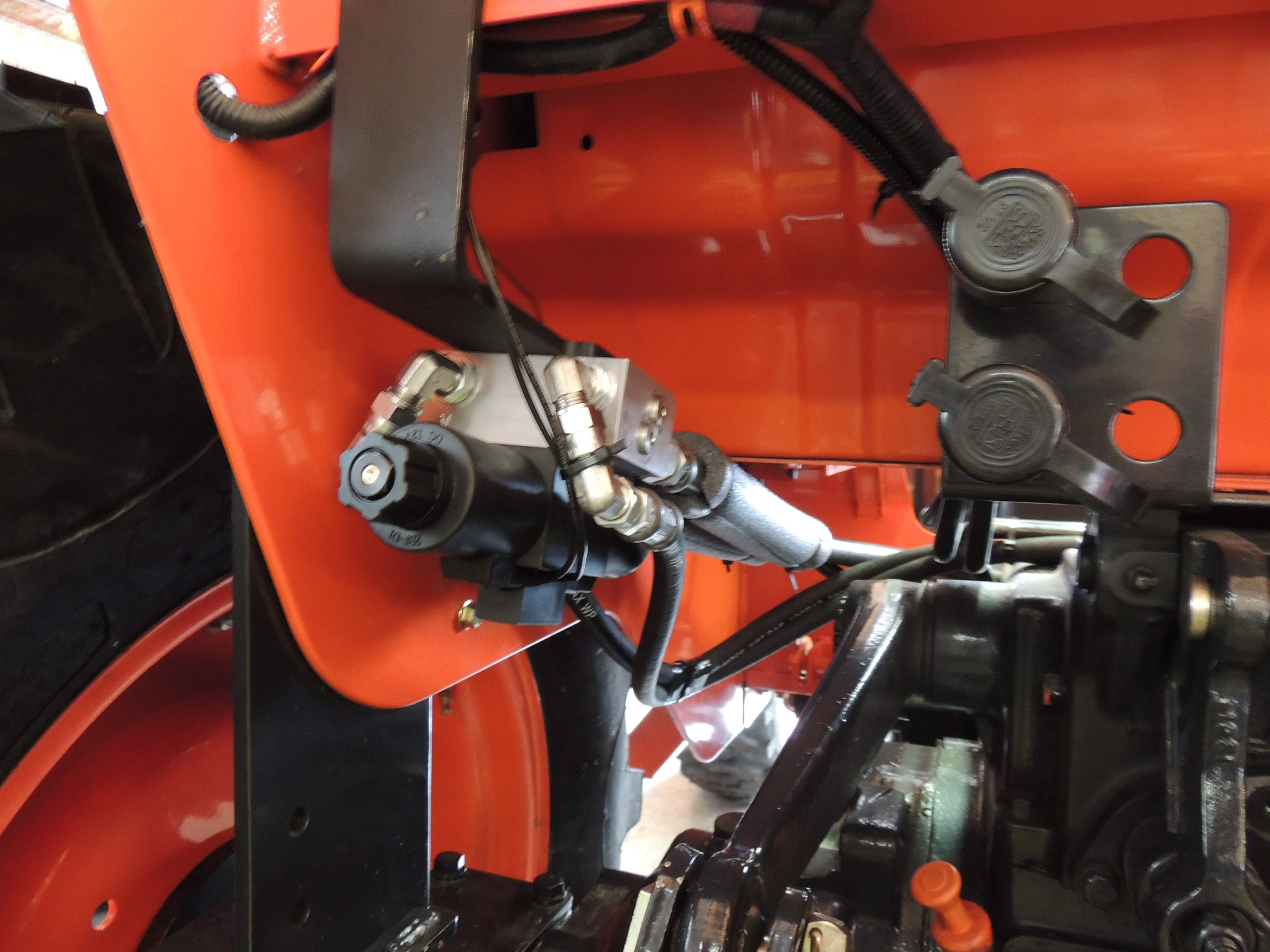

OK here is the 3rd function valve mounted, you can see the PB lines (larger ones) coming into the front and the 3rd function lines on either side in the back coming out. I used some pipe insulation around the PB lines in case the rubbed it would rub against the foam. I had to bend the mounting bracket slightly so the PB lines wouldn't hit the underbelly of the tractor body.

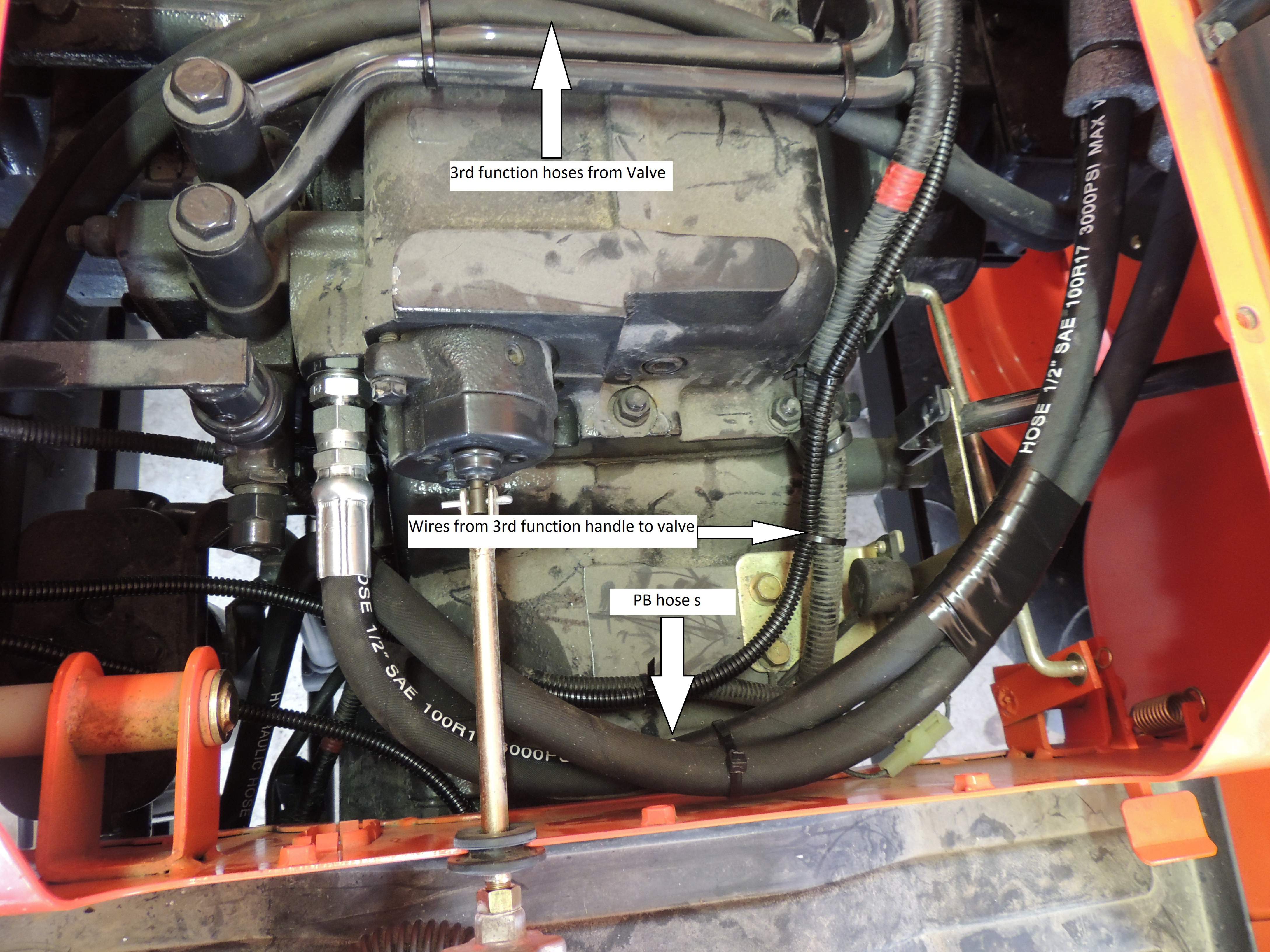

Here is under the seat where all the lines were ran including the wiring for the valve from the 3rd function handle. Took a few attempts to get the lines so they would run correctly.

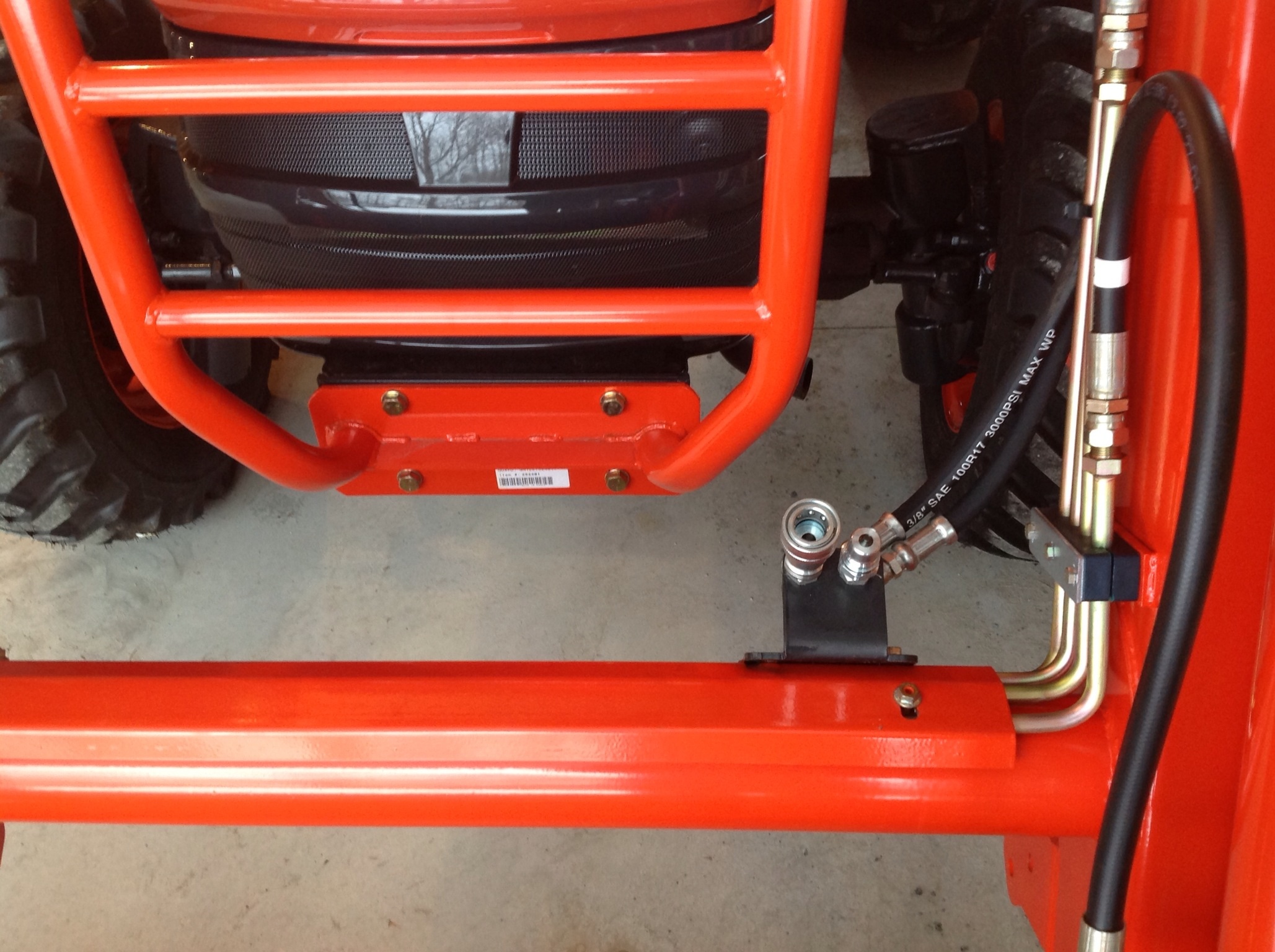

And here is where I ran the 3rd function lines down next to the FEL valve so all the QD's are in the same place. I used a hose strap that is mounted to one of the FEL Valve mounting bolts to hold the hoses in place
I don't show the hot wire for the 3rd function handle, but I ran that from the 3rd function handle, under the seat, and then used a fish wire to fish it up to the fuse box area and crimped it to the back on the fuse box using one of the spare terminals it has. It is hot when the tractor ignition is in the on position.

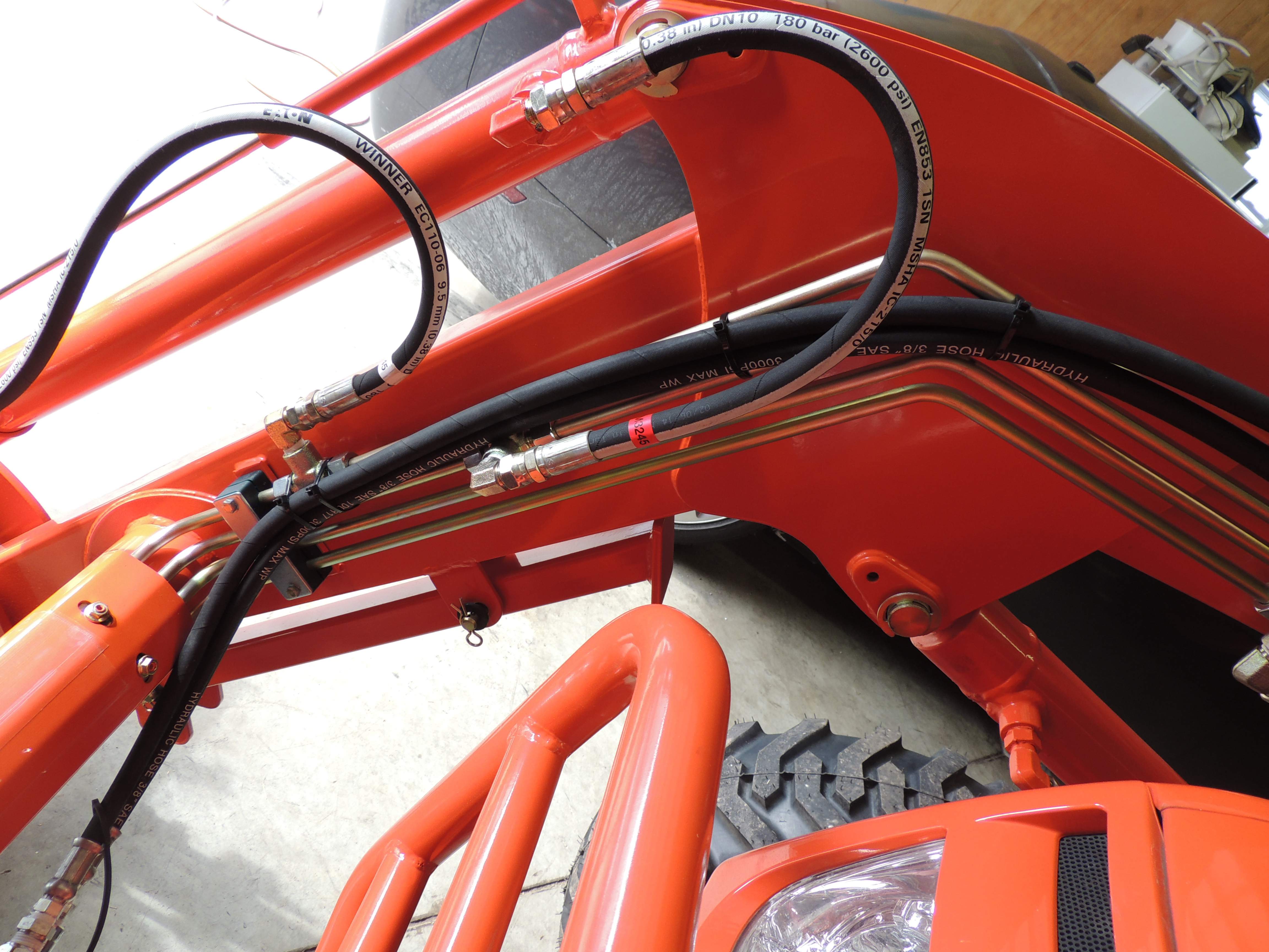

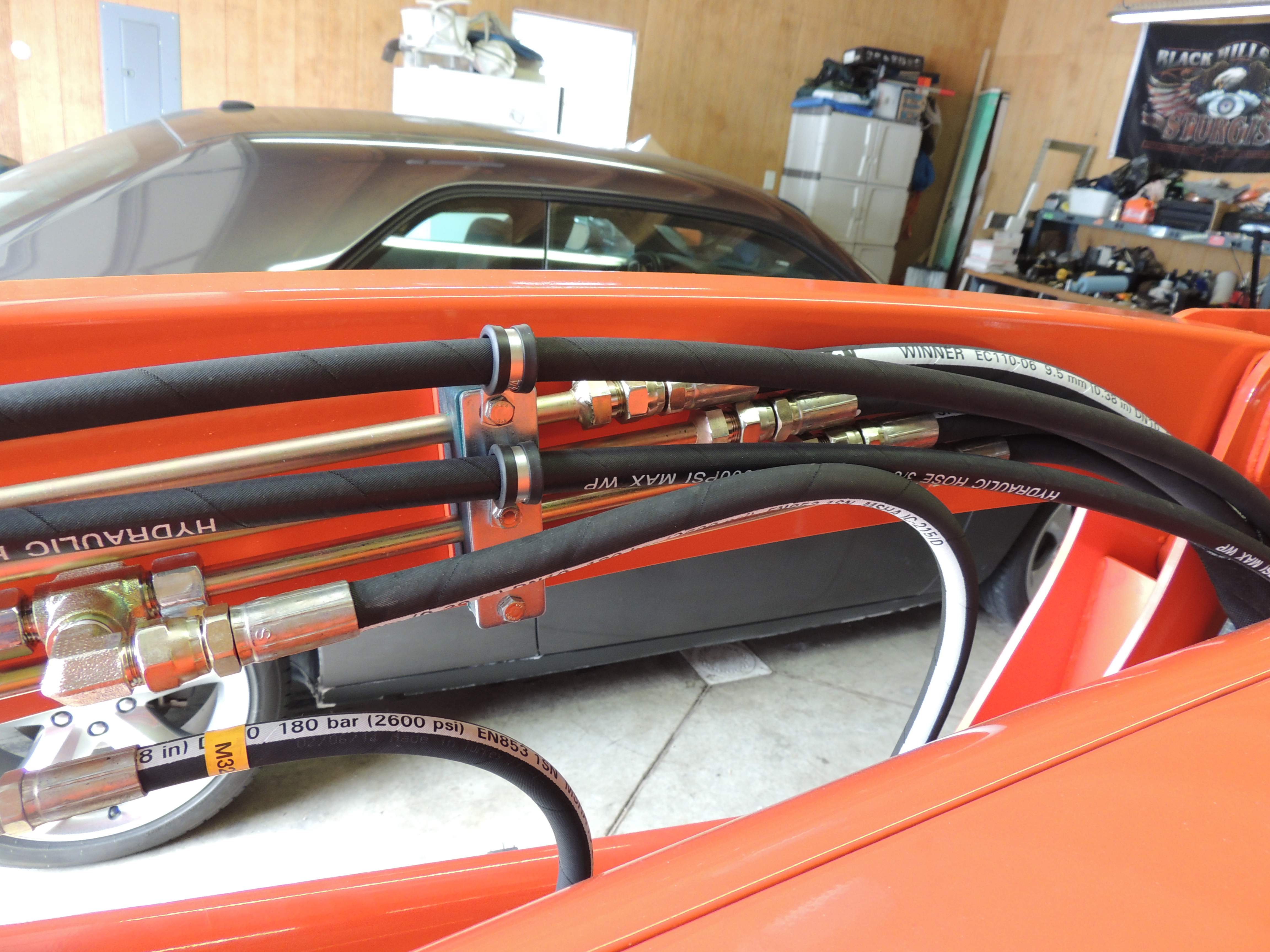

I used rubber coated hose straps on the loader arms to mount the hoses
I then used tie straps towards the end of the arms. I think there could be a better way to mount these and I will look at making a plate that has a angle to it, but for now this should work

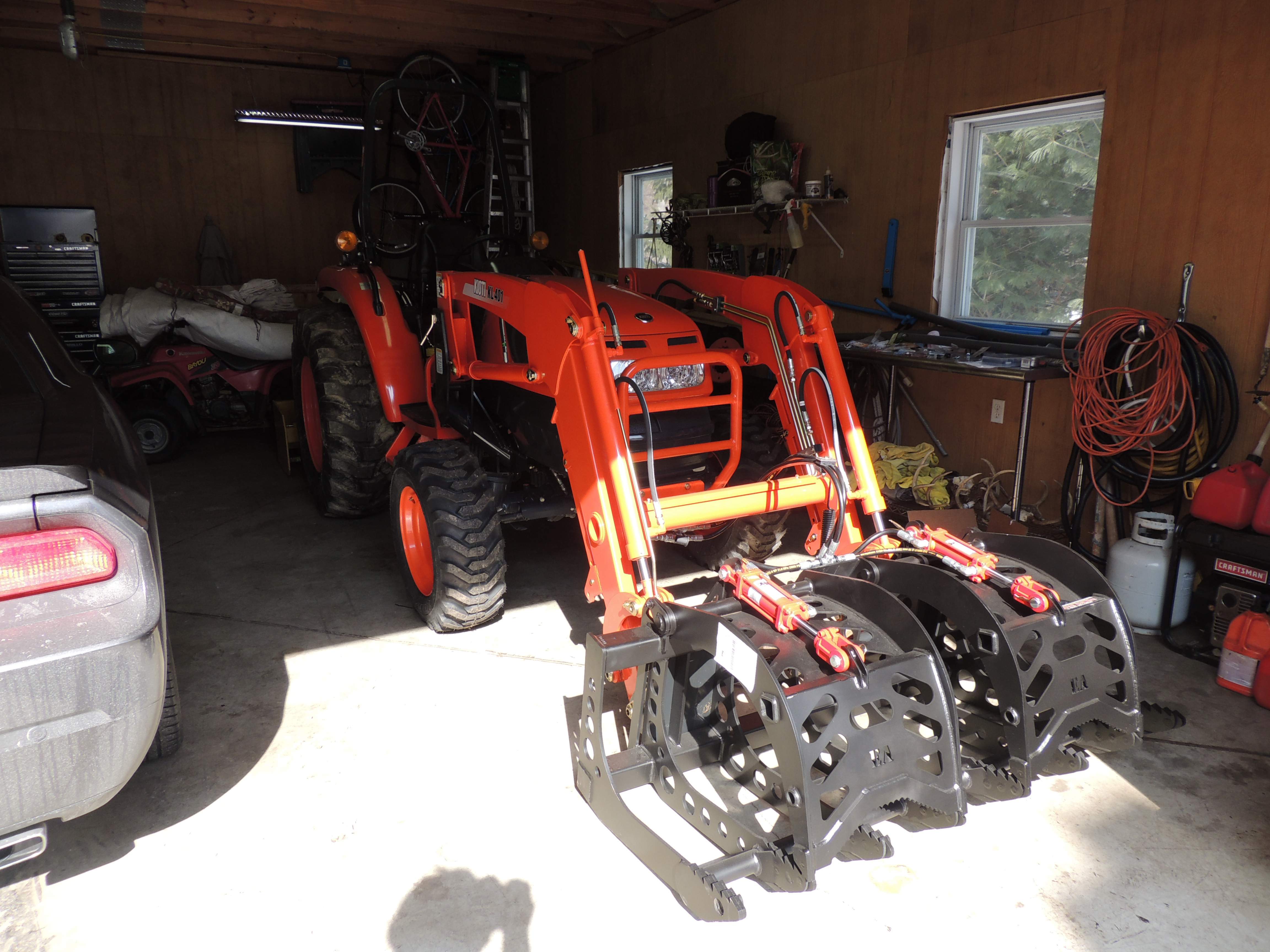

Last pic is the grapple mounted
I started it up and NO leaks. Grapple works.
One thing I don't like is the QD's just laying over the cross member of the FEL up by the grapple. I put some clear 3M adhesive on the cross member so the metal QD's wouldn't scratch the cross member all up. But again, I might look at fabricating a mounting plate.

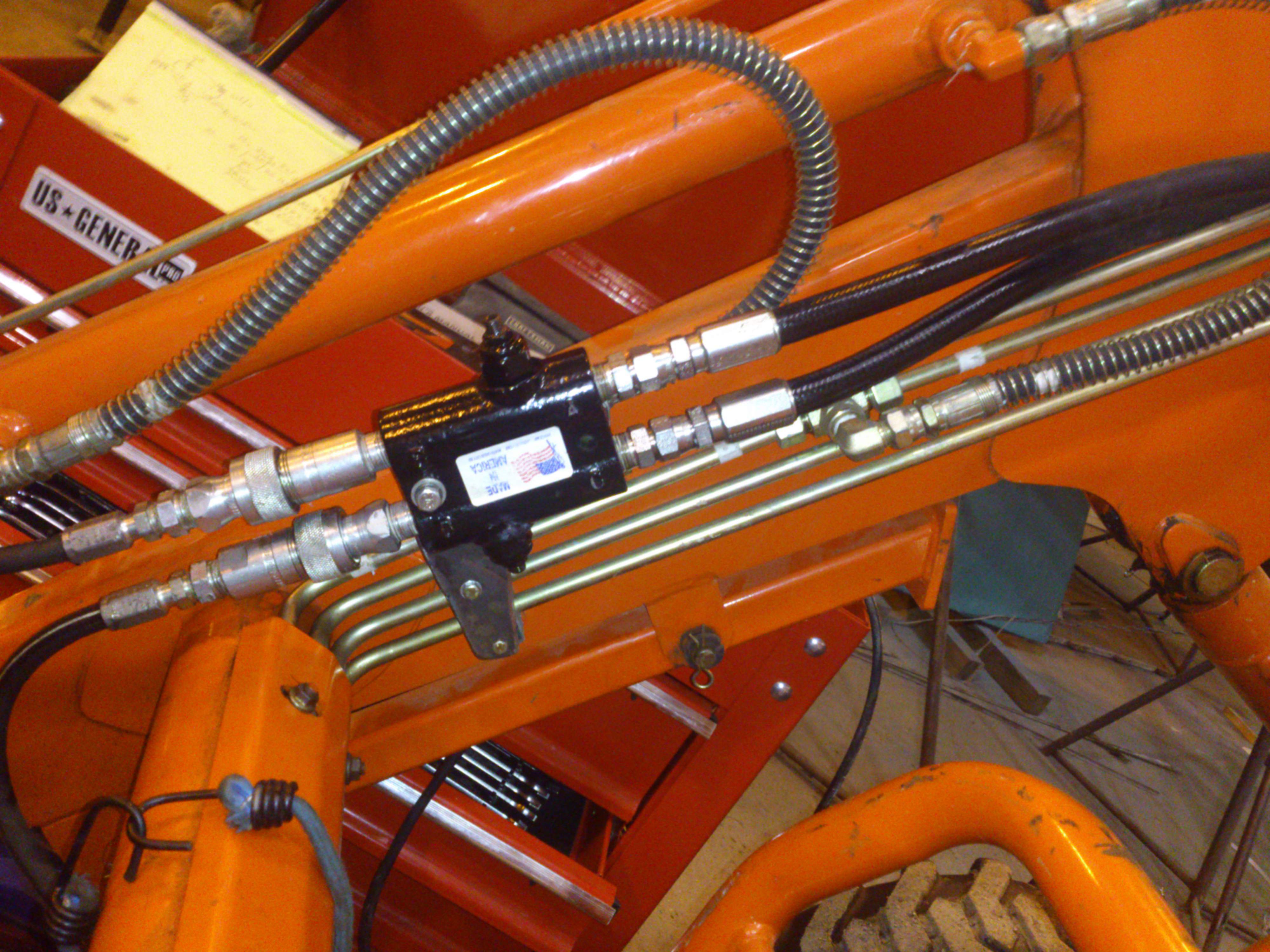

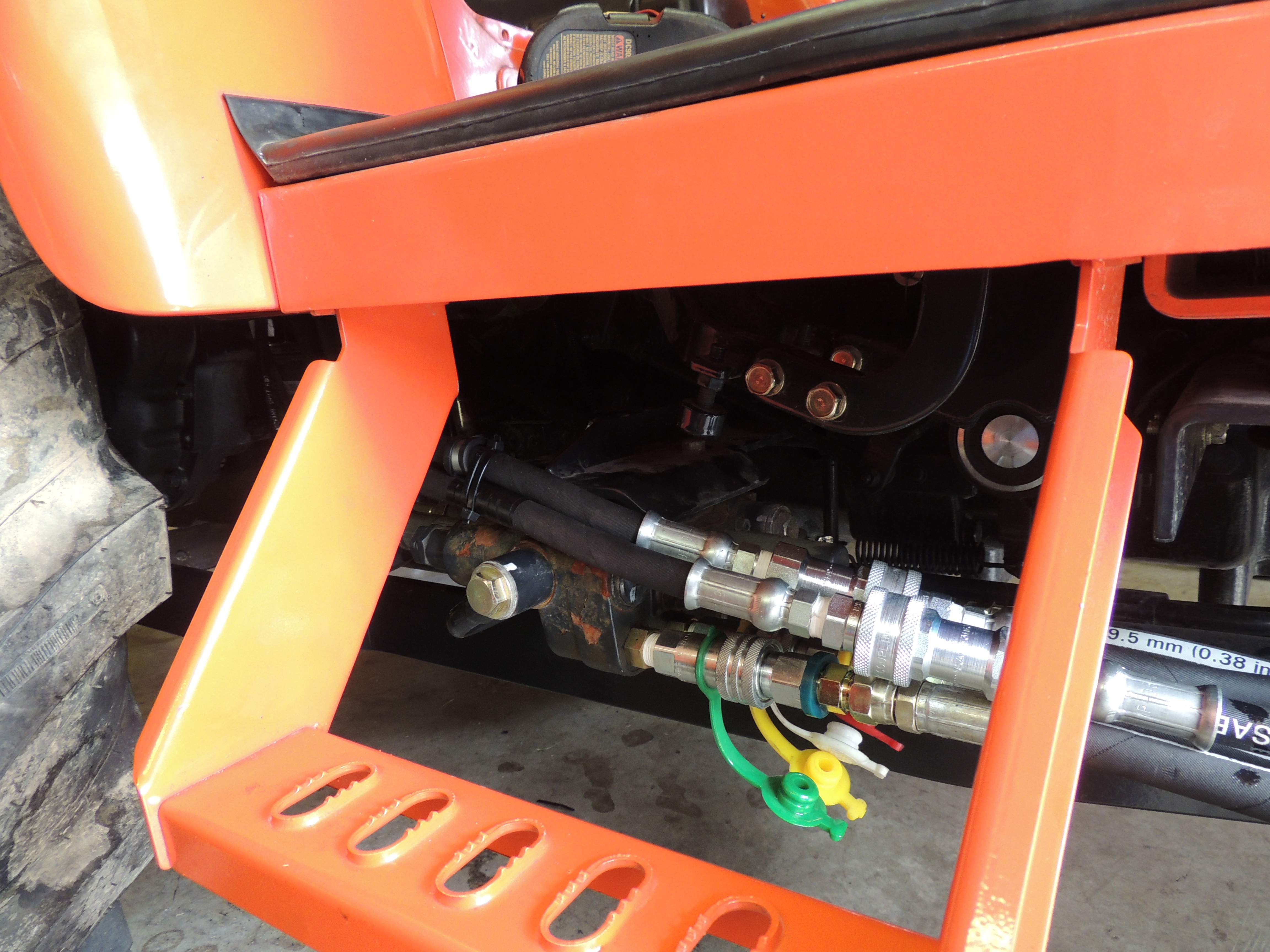

Nice neat installation. This is how I mounted my QD's for a snow plow. Originally I did not have a cross over relief and just used a piece of angle iron for just the QD's. I used the hydraulic tube bracket bolts on the FEL. DSC_0898.jpg
/ 3rd Function install Summary on DK40SE HST
#12
Nice! Here's a bracket the dealer fabbed for my QDsView attachment 413567
Thanks for the picture
Just talking with a buddy at work that has a machine shop at his home. We were looking at doing the same thing, but I will most likely have the bracket turned 90 degrees so the QD's are facing toward the side of the tractor. I have plenty of slack in the Grapple lines to do this.
/ 3rd Function install Summary on DK40SE HST #13
Yep, good idea, turning them. I havent had any issue keeping them plugged with either the QDs or the dust boots though, but good dealer, didnt even make me have to think about them.
