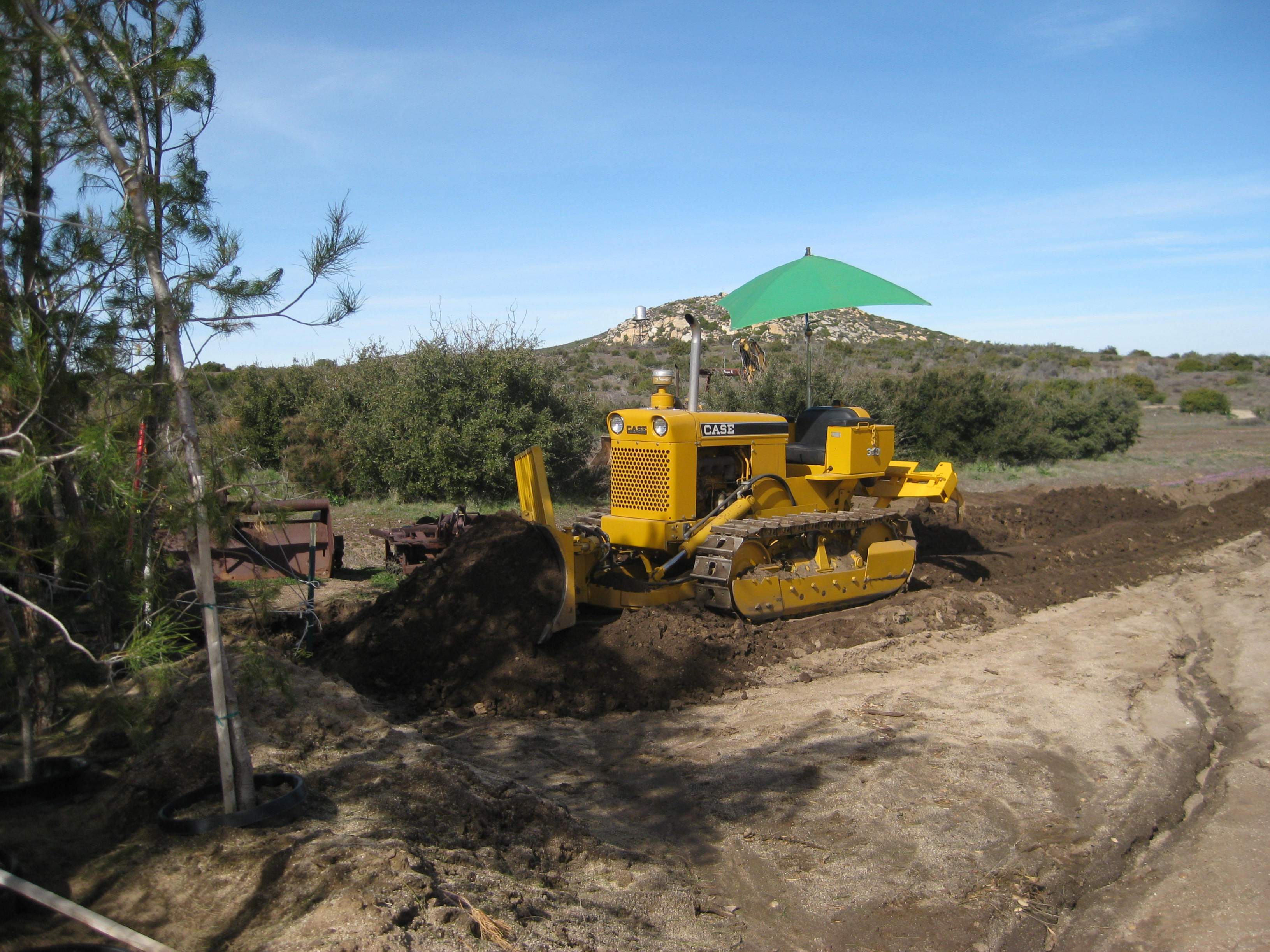

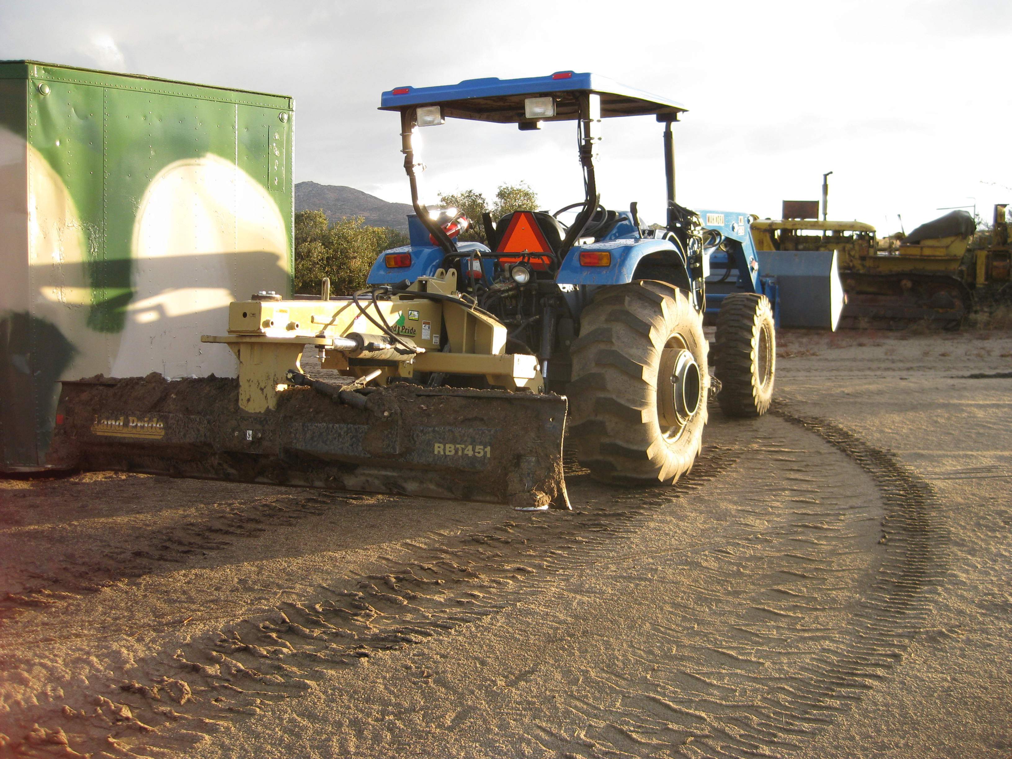

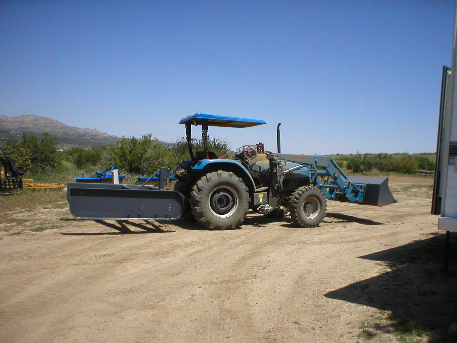

A land plane grading scraper(LPGS), 7'wide, 8' long weighing 1400lbs. This is my #1 go to implement for general road maintenance. I use the top link to make fine adjustments with this Implement. I maintain about 2 3/8 miles of road and fence line.
A Land Pride RBT45108. 9' wide, weighs about 1200lbs. Great for road ditch and crown maintenance although I have only had to re-crown twice in the last 18 years. Works well for making new trails although I have a dozer with 6 way blade intended for that.
A roll over box blade. (ROBB) 81" wide and weighs 985lbs, works well for moving dirt from point A to point B and is able to sink rippers in the ground over 10" deep.

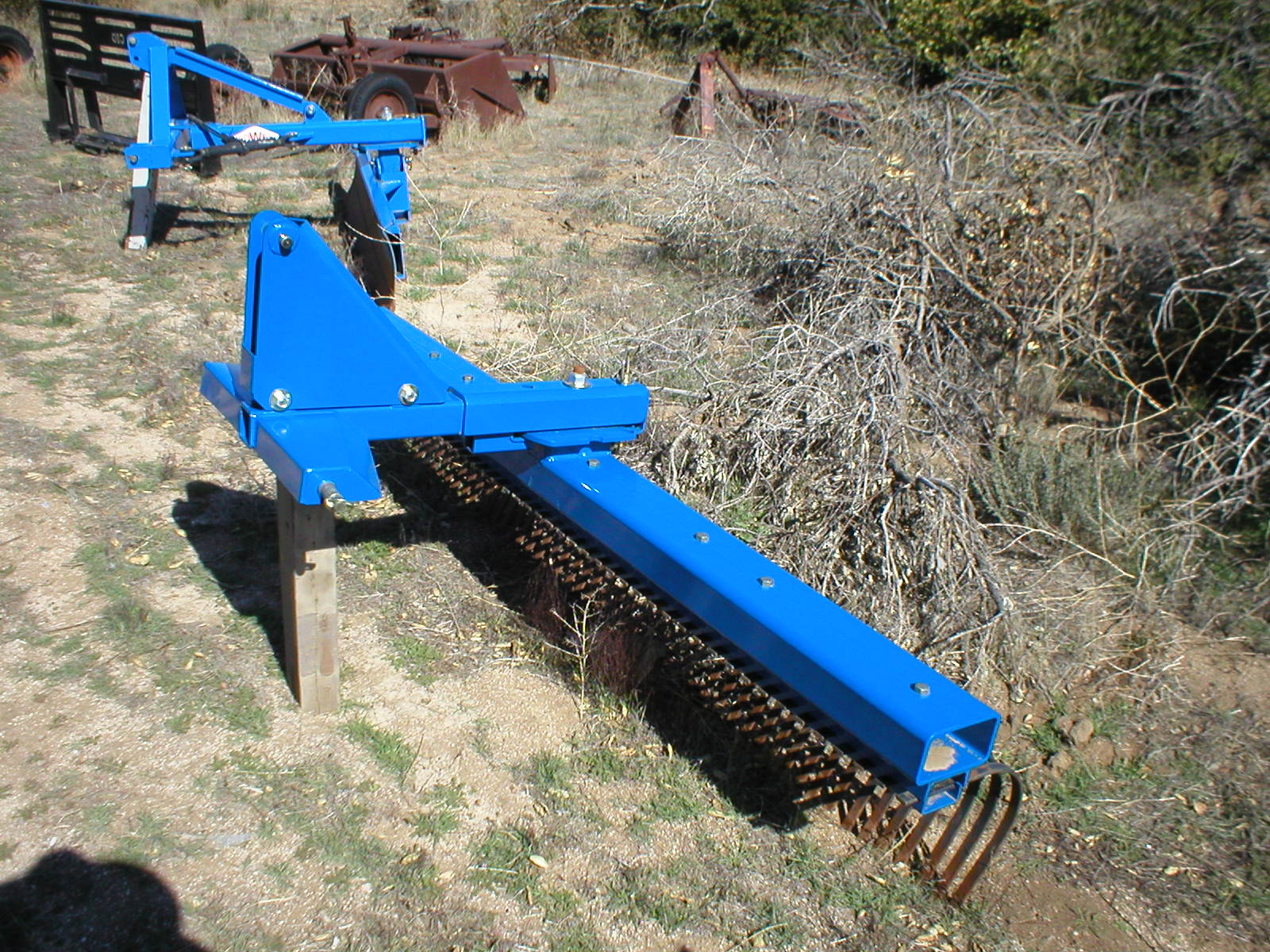

A landscape rake. 8' wide, currently getting rebuilt to have hydraulic angle and offset. When completed it will be up to the quality that I need that was not available 13 years ago. Should end up weighing around 800lbs when completed.

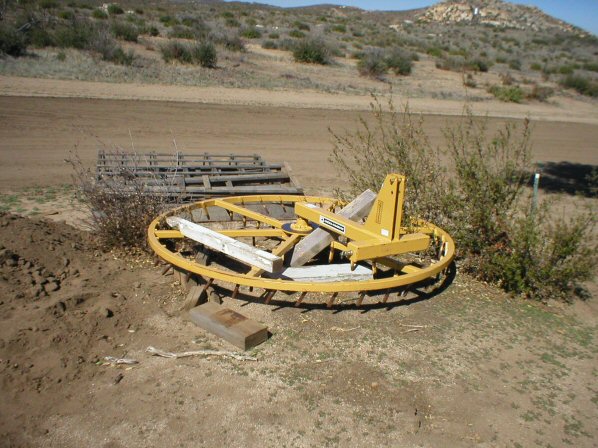

An 8' rotary harrow for fence lines. Technically not really a grading implement though. :eek:
