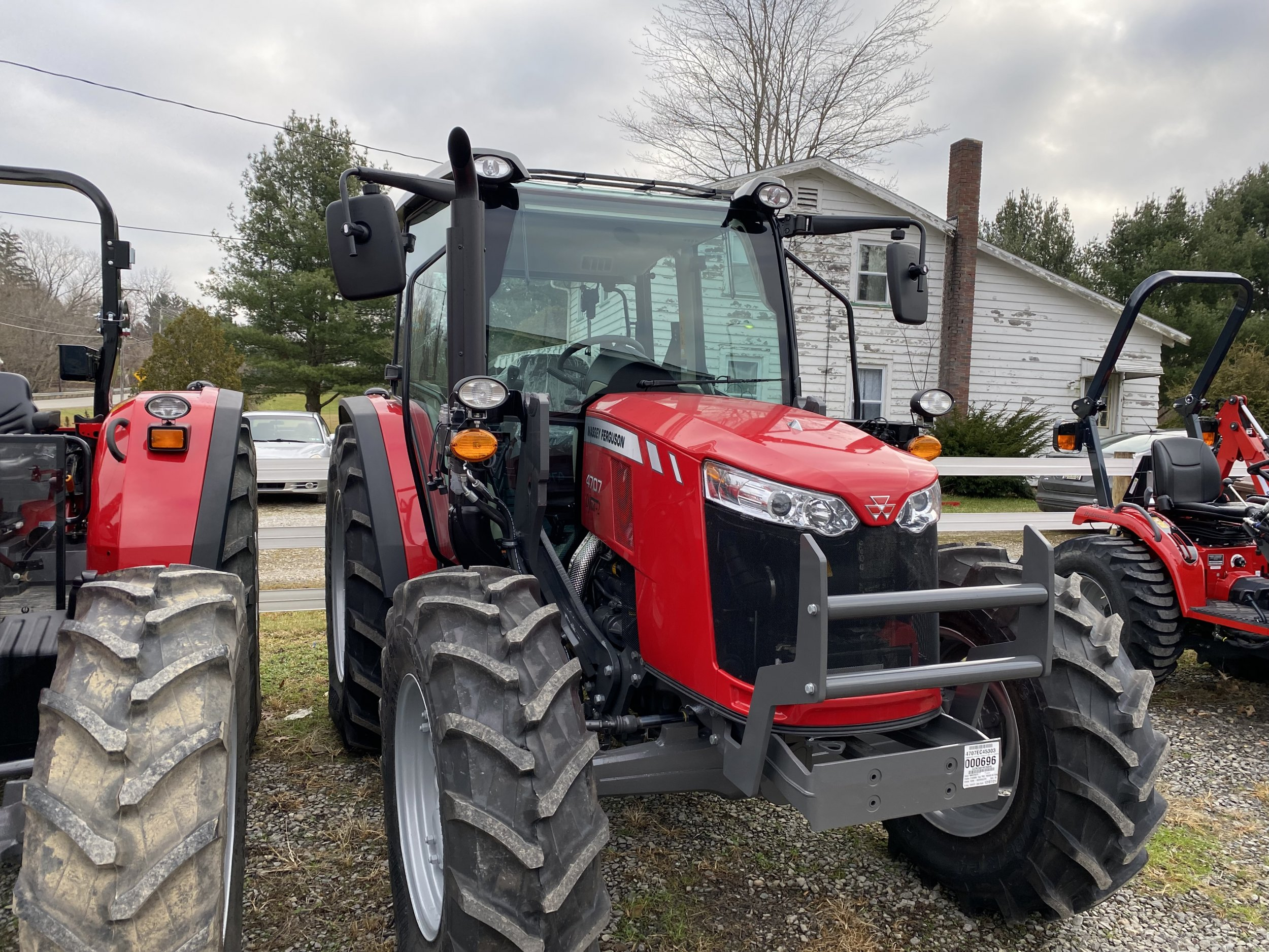

My theory on the jerky clutch. The clutch pedal is just a sensor, just like the forward and reverse shifter(if you pull up on it you can slowly release it like the pedal). The clutch is completely controlled electronically by solenoids. The reverse lever and the clutch pedal just sends a signal to it. Problem is the solenoids only work at their speed. So when you push clutch in to do something like hooking up a bucket or pallet..or whatever, when you go to re-engage it you believe the clutch pedal level is where the clutch is, but every time you push in the pedal the solenoids completely disengage the clutch but as you re-engage slowly the solenoids are catching up to you but you feel you need to let more clutch out, by the time it catches up to you its catching to quick. Clutch by wire is stupid.
It is a very common method on newer large tractors. Some are easily adjusted by the operator, some require the dealers computer. Almost all of these are multi plate wet clutches. Some can handle the temperature change of the hytran fluids better then others.
Yea, I’m sure. But these are slow solenoids imo. If your quickly but delicately pulling up to do something with the loader a traditional clutch will release and engage quickly with pedal movement. These are restricted by the slow solenoids and expecting a traditional clutch.

Four years and a little over 200 hours later, my '21 4707 still has a jerky clutch, but I mitigate it by not using it very much and only when necessary. As a previous poster said, just use the reverser and the button on the shifter.
As far as the 3pt issue, my tractor initially had it pretty bad. The dealer sent a tech out a couple times and could not fix it, so they eventually loaded it up and took back to their shop for a week or so and when I got it back, it worked quite a bit better. Not perfect, but almost.
The hood still won't stay up when lifted, but I guess it's going to be that way as long as I own the tractor.
Having said all that, this is the best tractor I've ever owned or operated and I look forward to every time I hop in it.
Just read your post. The clutch problem sucks. I bought a used 4710 that did the samething. I didn't notice it on the lot because it didn't happen until it warmed up. Anyway, I spoke with a youtuber that got his fixed and the Agco rep in my area. They both said, get a software update and recalibrate the trans and the clutch. My dealer took care of the on this and fixed it because I'd just purchase the tractor not to long ago. Mine clutch is smooth as silk now. Hope this helps you out.
How many hours on your “smooth” clutch now?
   / 4707 #669
Not enough for me to turn cartwheels. Some people would've lived with it but I've operated a lot of equipment during my time on earth and I'm old, picky and few other choice words. Mine had just a little grab when trying to hook up to an implement. Just enough to make it where I have to hold the brake a little when I got about and inch or so away from connecting.
I did speak to a you tuber "DLH Farms" that got his fixed the same way and it's been a few years and he said it fixed it. I can only hope I'm as lucky.
That's good to hear. I'm not going to bother with talking to anyone about it, as it's an issue I can sort work around, but I'm glad there is a fix.
