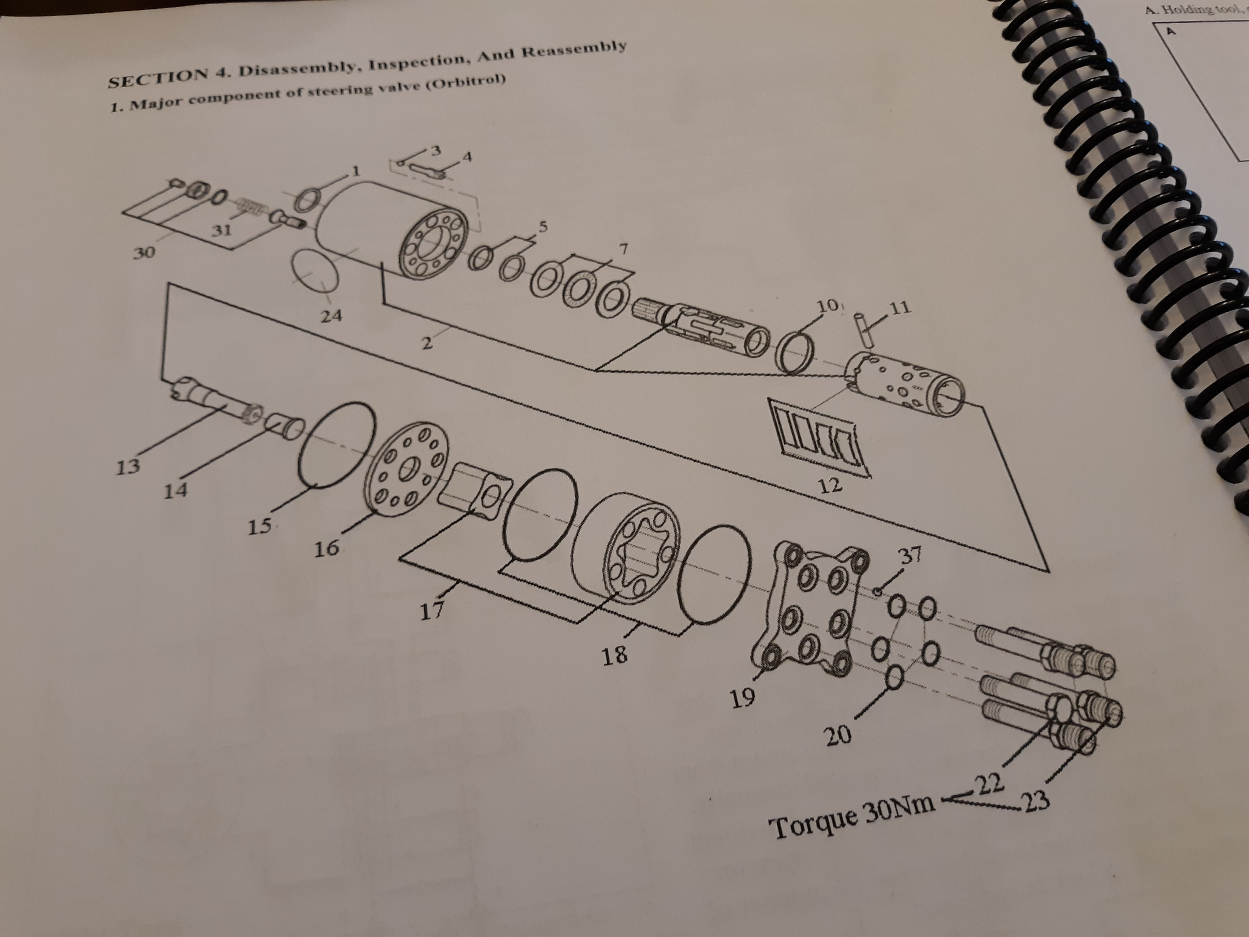

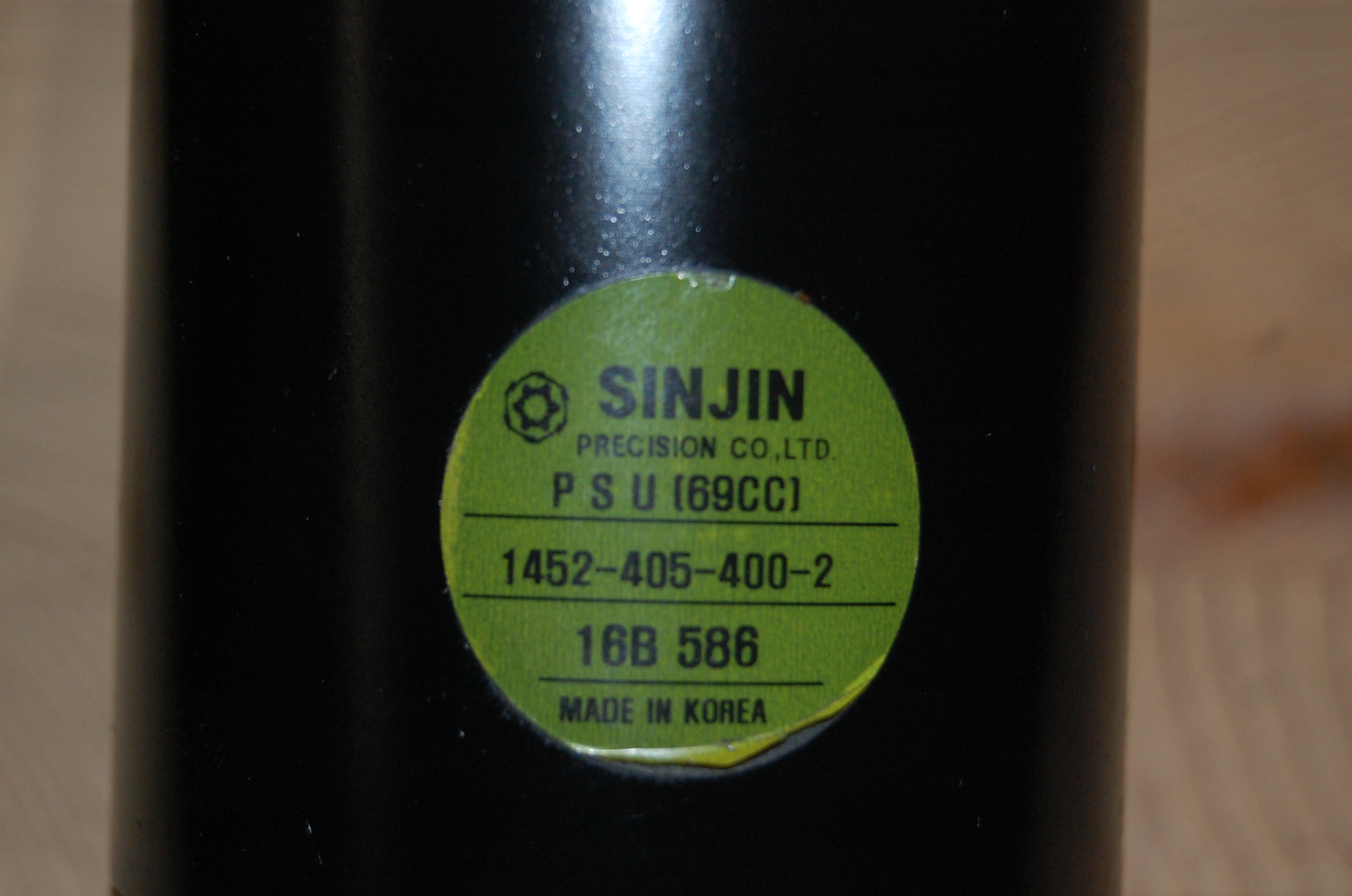

My new one (PSU) has Orings and is really tight. Shaft doesnt turn easily like the one I took out. I hope that means the oil seals are tight!

Hi DirtHauler. I misunderstood you. My mistake. I found several websites that had a quad ring that fit the measurements I came up with. I was hoping to find a better rotary seal than a quad ring. When I worked at the nuclear plant, we had seal training. They actually had seal manufacturer reps teach the classes. These reps had some great info and I just remember them saying, quad rings were not your seal of choice for a rotary shaft. Well so far, I can't find a rotary seal that will fit. I would have to machine the opening inside the case to a larger diameter. That wouldn't be big problem. There's a local machine shop that could do this. I just need to buy the seal. I've been waiting for a guy, who runs a hydraulic business, to call me with some advice, but he seems to have taken a vacation. I saw this website. Quad ring 212 looks close, maybe right on. Standard Size Charts for Quad-Ring(R) Seals and X-Ring Seals Good luck!

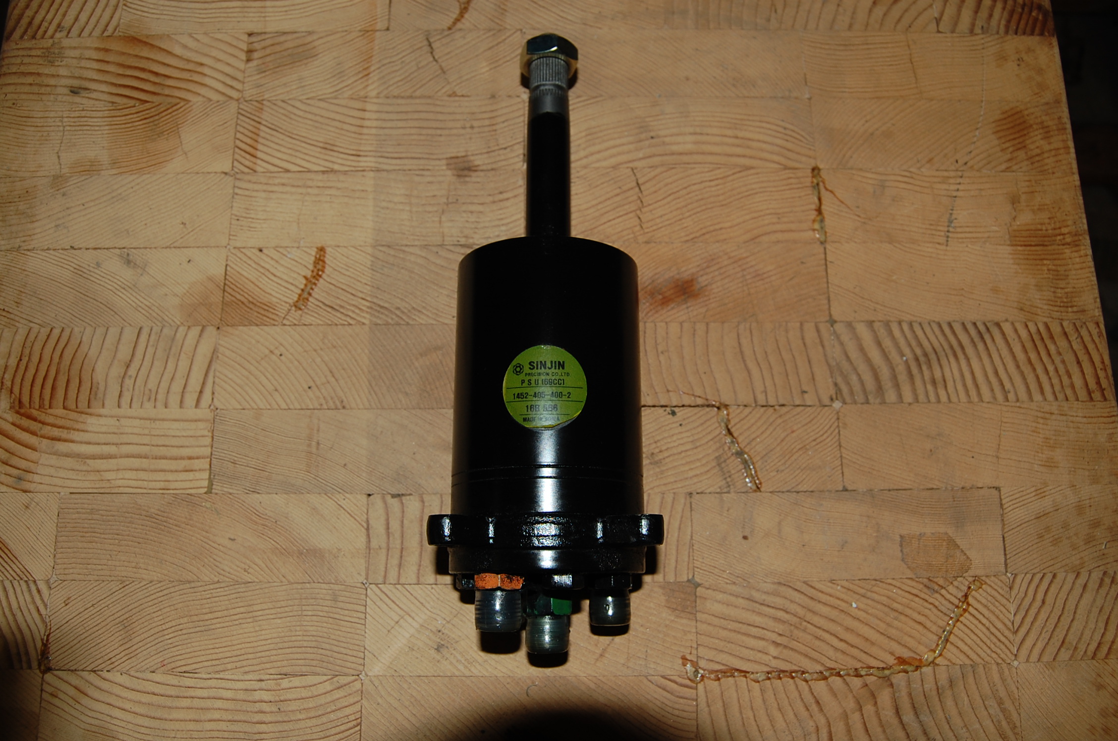

To close this thread out for me, I bought HSU and installed it. No leaks but R and L were reversed. Fixed that. Started another thread to describe HSU replacement

New one certainly feels tighter. I thought about shipping you my old one and the two seals I bought. One of my sons in law is a mechanical engineer and a grandson is pretty mechanically minded. I may see if they want to try putting it back together. Keep us up to date on either thread

Thanks for thinking of me. Don't throw it away, but keep it and try to get it put back together. I'm still looking for a different seal type to replace the quad ring. I have talked to many seal tech people and all of them say a quad ring is not the type of seal for this application. One guy said it was probably used because they are cheap and will just last long enough to get out of the warrantee. I hope your new HSU last. Maybe SINJIN made the quad ring out of better material than the original seal ring. My quad ring was swollen or larger than is should have been. So this I know, is a big problem and hence the leaks. Stay in touch and good luck with the new HSU.
