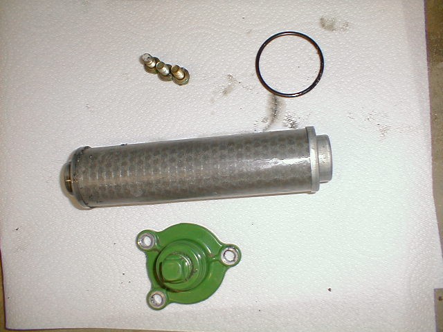

Nice install Mountainman and great photos. I'll be doing my trans fluid change soon, what did you use to catch the fluid? Will a five gallon bucket fit under the tractor?

I have a 15 quart "Blitz" oil drain pan (from Wally World about $6), which was filled to the brim. The power steering filter holds the other quart. Also the oil screen on the right side also needs to be cleaned (mostly fine metal particles). BTW the screen only fits in one direction... Here's a picture.
You're correct about losing the drawbar storage. I do use it frequently for pulling a manure spreader.
I agree it's a great tractor and much easier to work on then most cars (easy access and better ground clearance). However some torque setting are higher (drawbar bolts take 250 ft/lbs!!)
