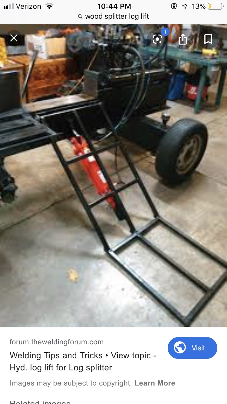

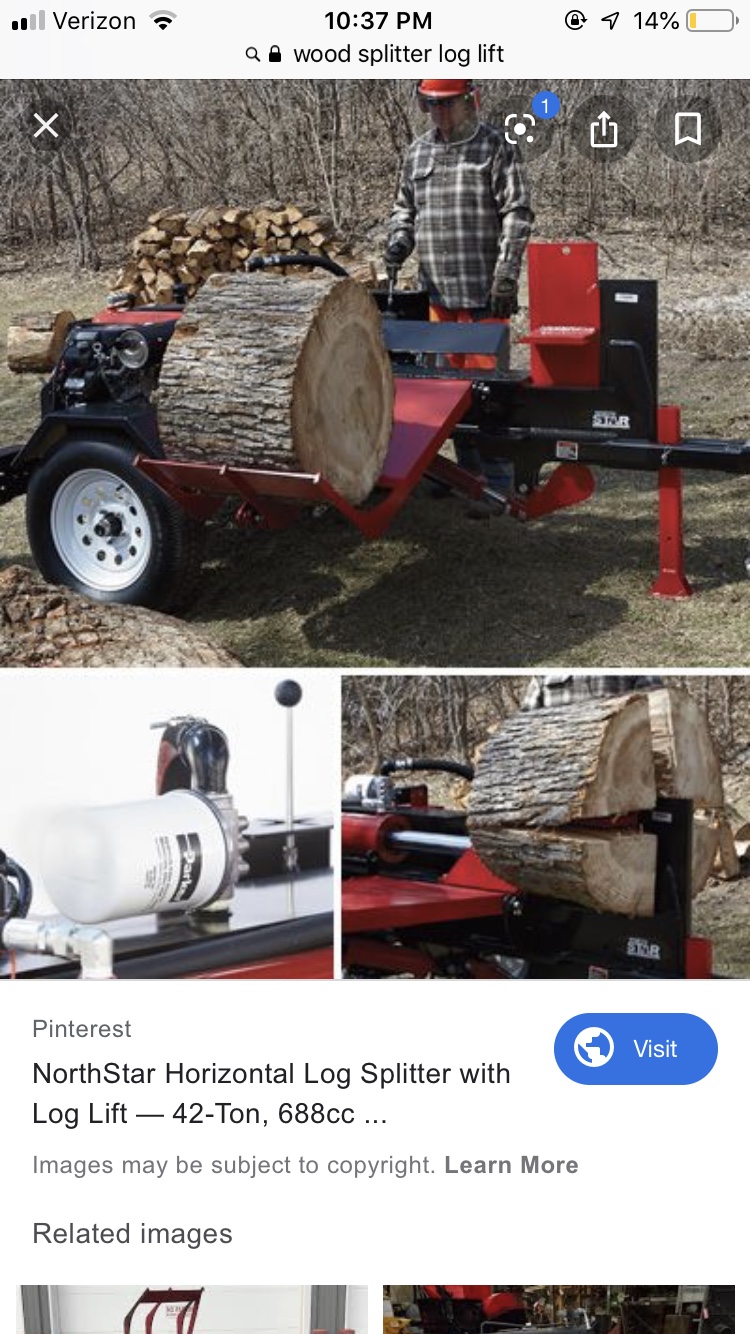

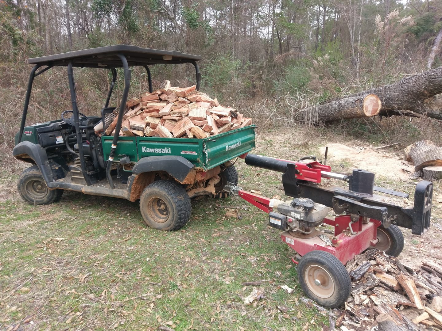

Got a picture? I have been considering making one. I'm better at copying than inventing.
They’re a pretty simple device that saves a lot of work. My advice would be to mount it far enough forward that you can stand between it and the wheel. Because unlike this guy you want to work on the same side as the lift. Having to walk around the splitter every time to load another round would be ridiculous. And unlike a lot of homemade ones I suggest making it with a solid back. You’re going to mash your fingers sliding around pieces otherwise. Build it like the first or third picture not the second.IMG_7523.JPGIMG_7524.JPG
