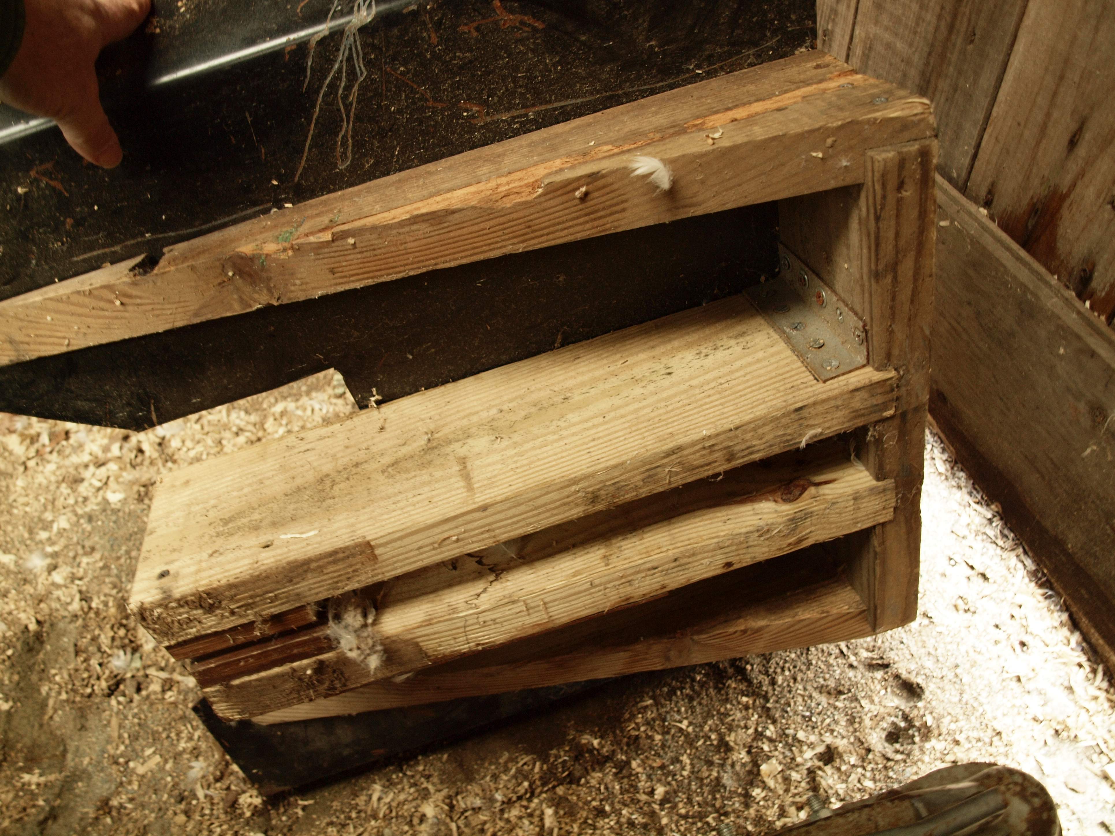

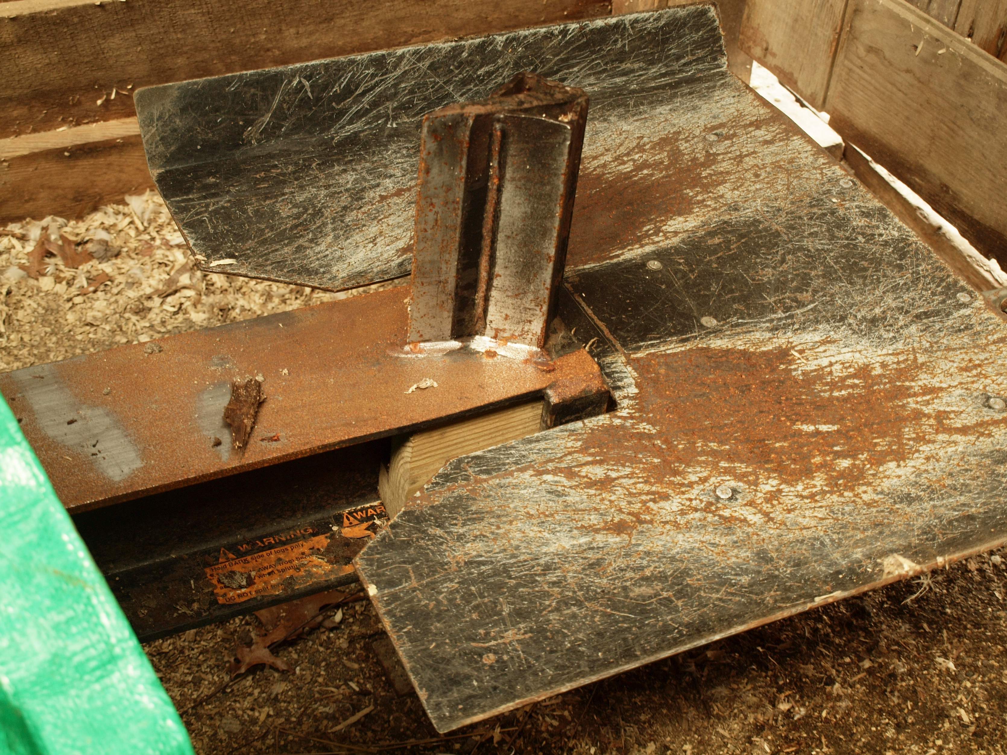

I have a 16 ton plane jane horizontal splitter the uses the 4 way very effectively. 15" round is commonplace to go right through. Built a table using 2x6's and sheet steel.
