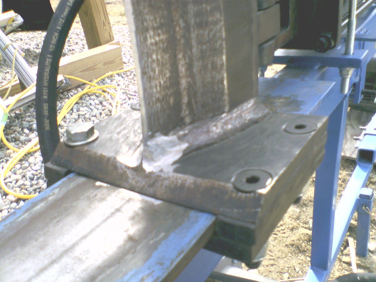

I owned a 16 ton RamSplitter electric splitter for years. At the time, 16 ton was the largest you could get and still run it off of 110V (At the time, their 16 ton came with a 2.0 HP electric motor. They've since redesigned it for a 1.5 HP motor. In a log splitter type application, a 1.5-2.0 HP motor performs about like a 6-7 HP gas engine.) The larger electric splitters ran on 220V.
I had their Horizontal/Vertical model. I purchased that model because I preferred the higher work height. I used it in vertical mode only once (not really a fan of vertical splitting, but I know there are those who do like it). I found their design and quality of construction "good enough". I was satisfied enough with it that I used it for about 6 or 7 years. I did replace the bolts used to hold the slide the wedge was mounted on onto the beam. The originals were regular hex head bolts. I found they hung up on the larger logs, robbing the splitter of of a good bit of its splitting power when they got caught on the log. I had the hole countersunk, and replace the bolts with another design which fit flush in the countersunk hole. You can see the change in this picture. The bolt on the left is the original. The other three are what I changed to. It made quite a difference when splitting larger hardwood logs
I like your countersunk bolt idea, the raised bolt heads on mine have always been problematic.
I have mine wired for 220v
It worked out fairly well. If you ever want to get it back apart again, you might want to put some "Never-Sieze" on the bolts, since they are not galvanized. (I never could find that style in a galvanized bolt, though I must admit, I did not search all that long.) I think I got these from Fastenall.
