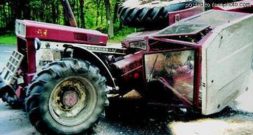

Here are the pics, I thought I had them on the forum but did not.
/forums/images/graemlins/grin.gif

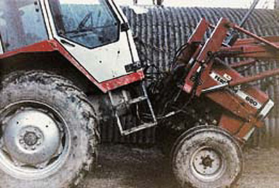

one more
   / a tractor can break in half? #25
First one I've seen but then my world is pretty small.

   / a tractor can break in half? #26
Yes mine is aslo.
As I stated before, I did not take these pictures and they do come from other websites.

   / a tractor can break in half? #28
</font><font color="blue" class="small">( Haven't we seen that repair before Harv?)</font>
Good memory, Egon. I originally posted it right after "the incident" back in January, 2002. /forums/images/graemlins/wink.gif
</font><font color="blue" class="small">( I'm curious about the motive power in your tractor )</font>
The power plant is not shown in the picture, Don. They were all off making fun of Rudolph. /forums/images/graemlins/laugh.gif
   / a tractor can break in half? #29
I sold a fellow a Hinomoto 2304 which is the Japanese cousin of the Massey Ferguson 1030. His tractor had a loader on it and he broke the tractor just behind the bell housing. At one time Massey has a tech bulletin out on their 1030s that stated that you should have counter weight on the rear of the tractor if using a loader to preven possible damage to the front axle but I never heard anything about breaking them in half. Also I had 2 of the 1030s that broke gears in the front axle and both had loaders.
