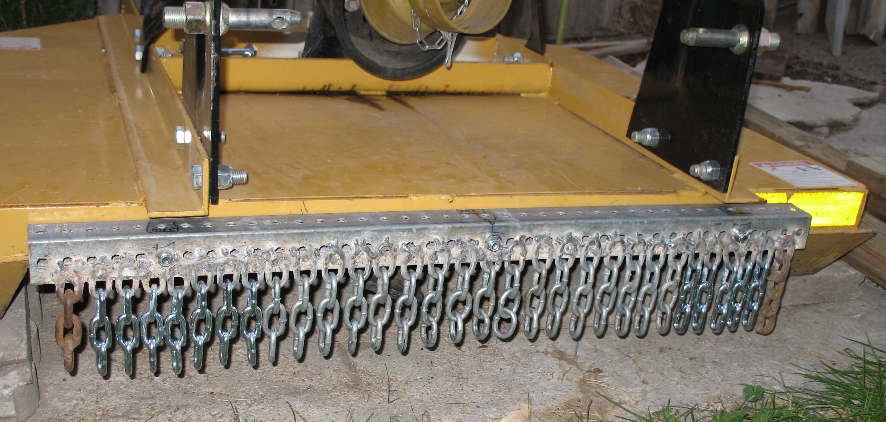

BTW.. did you have any burn thru trouble using that beefy 150a setting on 1/8 6011 rod?? Or did you do that to blow / burn the zinc off/out of the weld at arc strike/ puddle...?

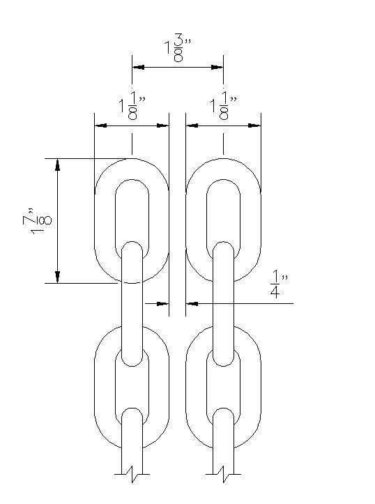

Clamping the cut chain links over the 1/2" bar like I did kept them in position so welding was very easy. I clamped them all on with the spacing I wanted first like you saw in the first photos. Then I started the puddle just short of the link on the 1/2" thick bar and worked my way to the link end, until built up and completely welded. Zinc was no problem at all that way.
No problem burning through the lighter gage metal on the cutter body either. I always start on the thicker material and pool towards the thinner stuff to prevent burn through. Then, cut off the weld at the right time for thick to thin welding. I only had to worry about that on the 4 corner welds anyway. The braces were all welded to the 1/4" thick angle iron going across the bottom of my cutter.

Excellent outcome! I like the tight spacing of chains and especailly like the stand-offs you fabricated. Very nice!

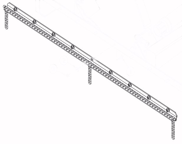

Sorry I was out and about not able to see your thread until now. Best way is to NOT weld (too late, I know!). You slot the metal that attaches to the cutter deck - one slot per chain. A rod runs thru the chain that sticks up thru the slots and the rod is bolted in place. That way when (not if!) you lose a chain, it's a 5 min, hand too only job to replace the missing or messed up chain.

Dave of Dave's tractor said in post #20 that's the way the factory ones are made. Pretty neat, but quite a lot more machine time up front milling all those little slots and then drilling and tapping for the bolts. I figure for all the front, rear and side bars about a good days work of set up and machining, although I agree it's probably the best way to do it.
When I break one off, I figure to grind off the stub, cut a new length and weld it. If it takes me 20 minutes, I'm still way ahead. lol ... That's a lot of chains to repair to get even. It worked out pretty good this way for me and I'm getting lazy in my old age.

So for now I'll just leave it as it is. I had a concern about the gap left by the standoffs and that maybe something would fly out of there. But there is the shroud lip that is lower so it's not a problem. Overall, I'm happy with the simple solution. I need to accidentally run over something though to see how the chains work though.:) For now I'll consider myself lucky.
