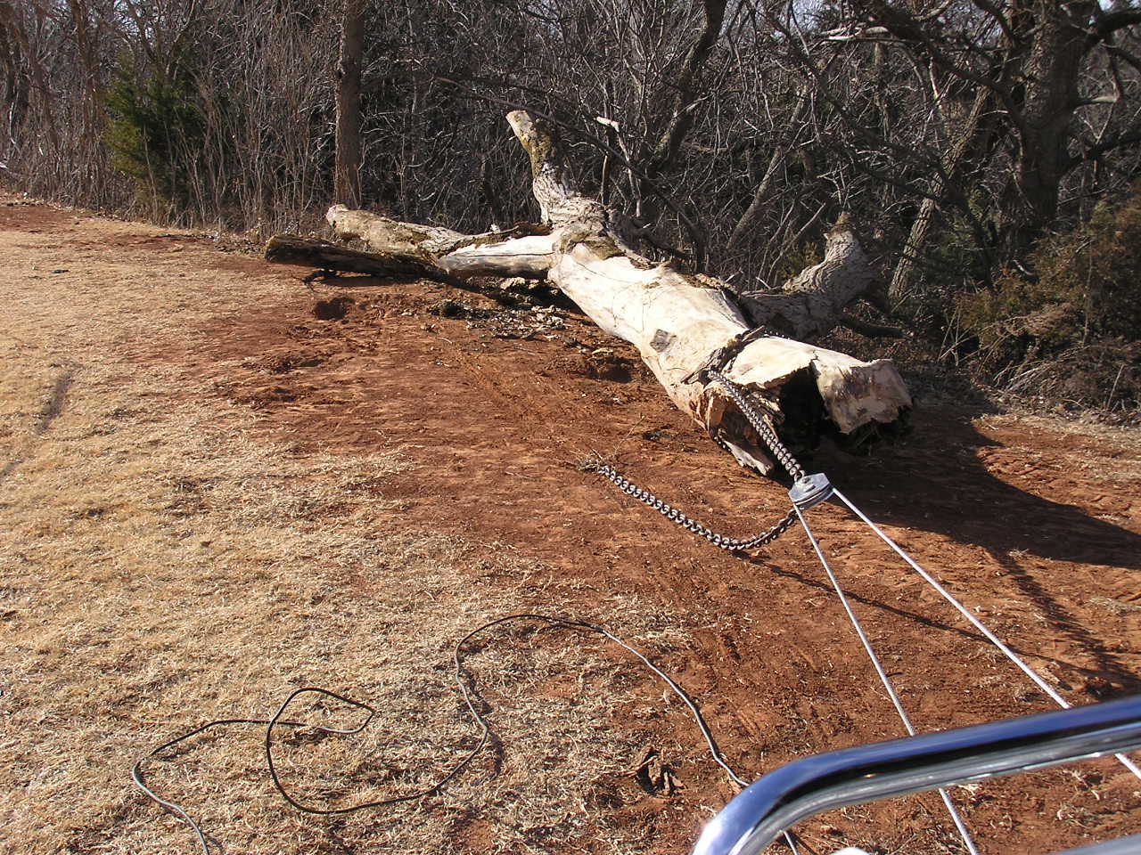

Yes , I have #6 or # 8 welding lead cable (I don't remember which size) from the battery of my truck all the way back.. The connectors that BCP posted are the connectors I used.. Like on XFaxmans receiver type winch
   / Adding a winch to 7 ton trailer #15

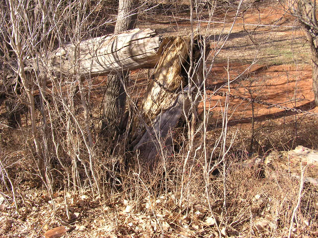

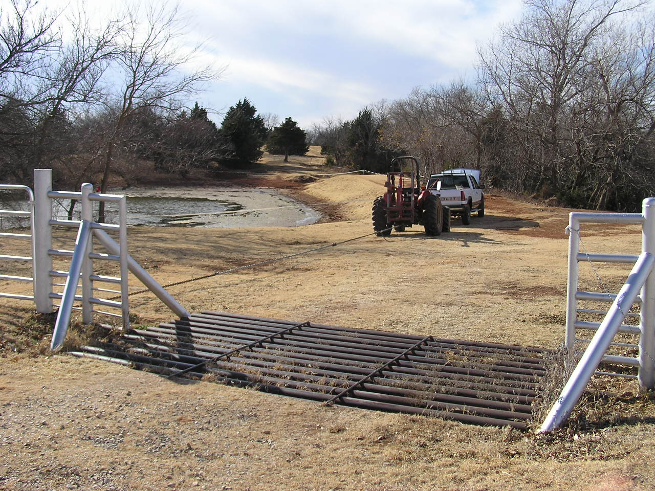

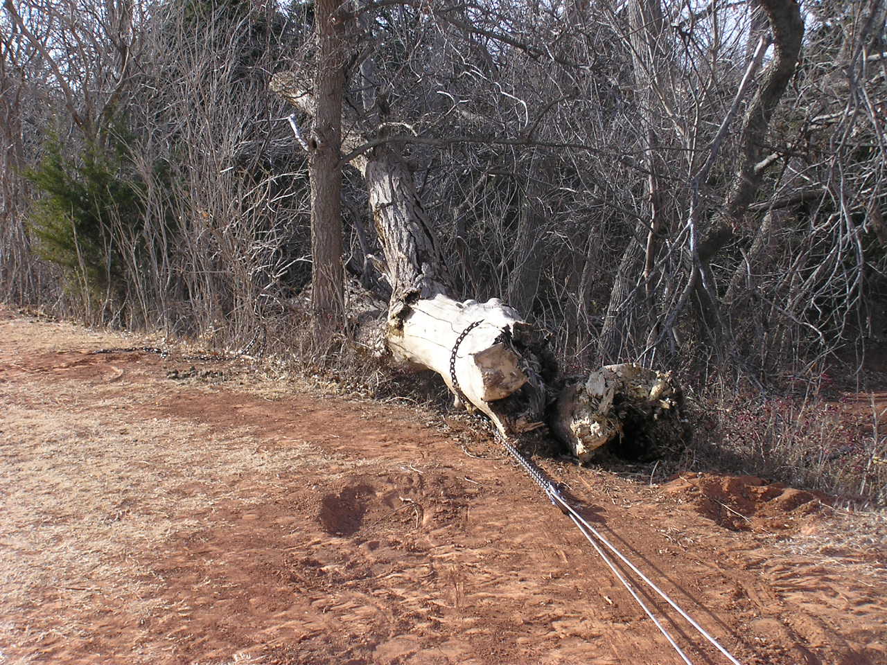

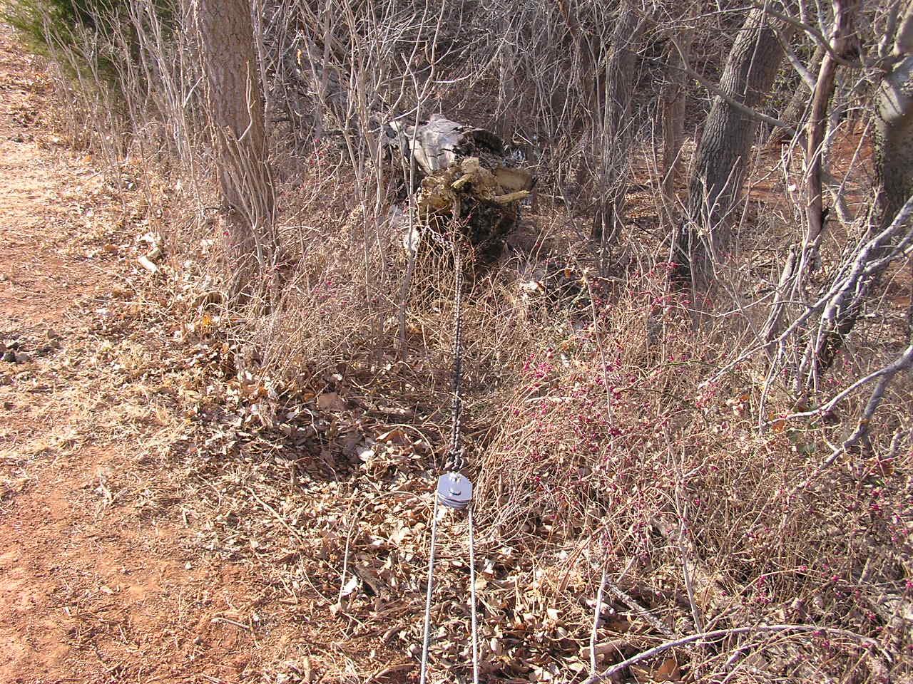

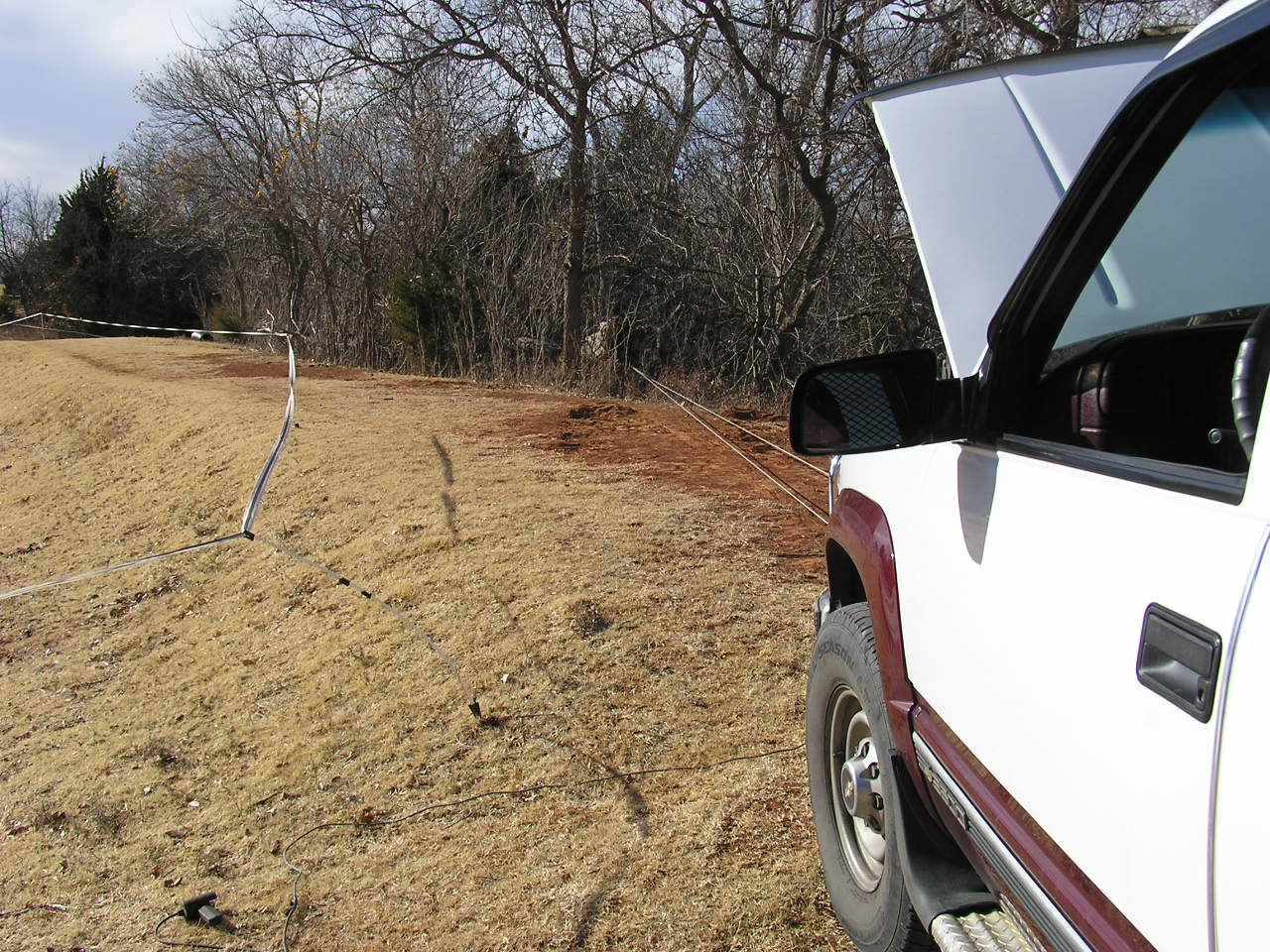

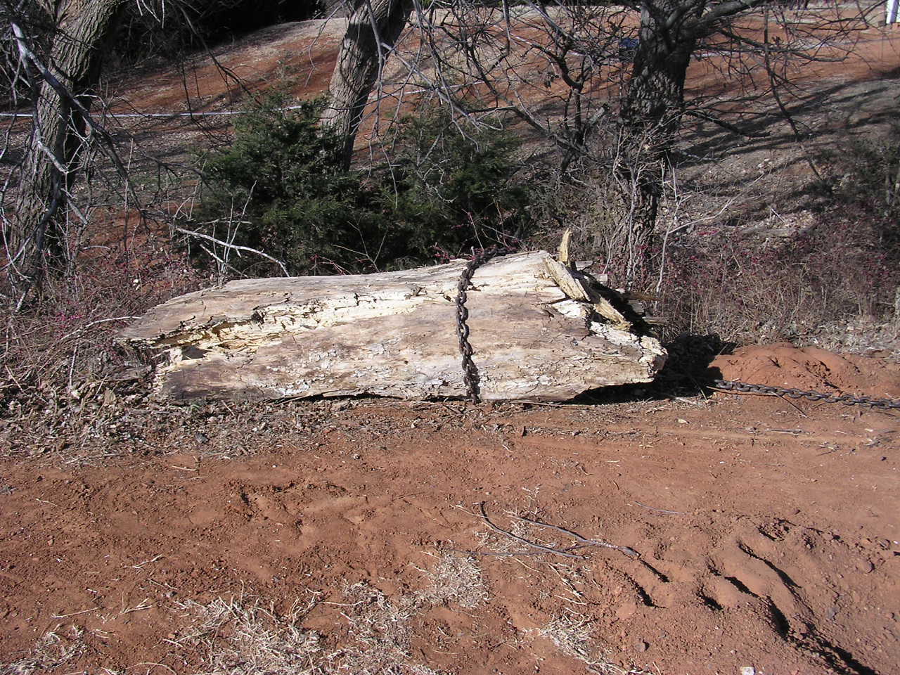

Xfaxman - in the bottom pic. Were you stretching that pickup and making a crew cab - ha,ha. Looks like the Massey must have been connected to the back of the pickup. --------
Almost did. :D
The Massey was chained to the receiver hitch and another chain to the gate post. This was ten years ago and before I put the receiver on the Massey. It was a cottonwood stump that I was going to pull. It broke at ground level which was OK for the back of the dam. Then I hooked onto the tree and drug it out.
