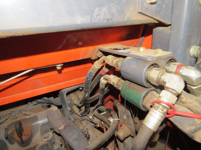

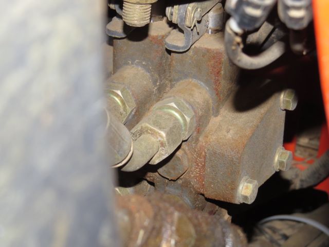

These pics are on a Kubota L5030HST
The first picture shows an open slot for my third rear remote below the PTO to the left of the two levers.
The second picture is the two remote valves below and connected to the levers.
The third picture is the rear hydraulic connections. They are attached by a short hydraulic hose.

The older tractors had flat fenders and no specific slots. If that's your setup, forget the Kubota kit and add your own stackable remotes at a fraction of the price. There are many write ups of people doing it.

I searched both those sites and nothing came up. Then I search this site: http://www.colemanequip.com and the part came up so I could price it. But I still had to call the dealer to get the part number first.
For Kubota Model L5030HST
Regular valve kit Part # L8303 (or you can use floater valve kit part # L8304)
and you also need the lever kit Part # L8307
Part numbers are probably different if not a Lxx30 tractor model. Check with your dealer.

I edited the post above. For a Kubota tractor L5030HST the kit comes in two parts L8307 the lever/hose/connector kit and kit L8303 (Regular valve) OR you can substitute the regular valve with a floating valve that has a detent and that floating valve kit is L8304. The dealer mention a use for float valve kit would be if you had a batwing mower the wings would be on the float valves so they could follow the contour of the land. It was also mentioned in this thread that it could be used for a disc for the same reason. The valve in the float position would have no useful purpose for a grapple because you already have float on your FEL.
These are probably not the same number kits for your particular tractor. I cannot find a link anywhere to show you your part numbers. I had to call the parts supply of the Kubota dealer and he looked it up. Once I had the part numbers for the kits from the dealer I could check prices from Colman Equipment web site. http://www.colemanequip.com The Kubota dealers sites here on TBN did not have these part numbers listed and the searches came up "not found". The dealer did not have the kits in stock and would order them, for about the same price as Colman Equipment.
