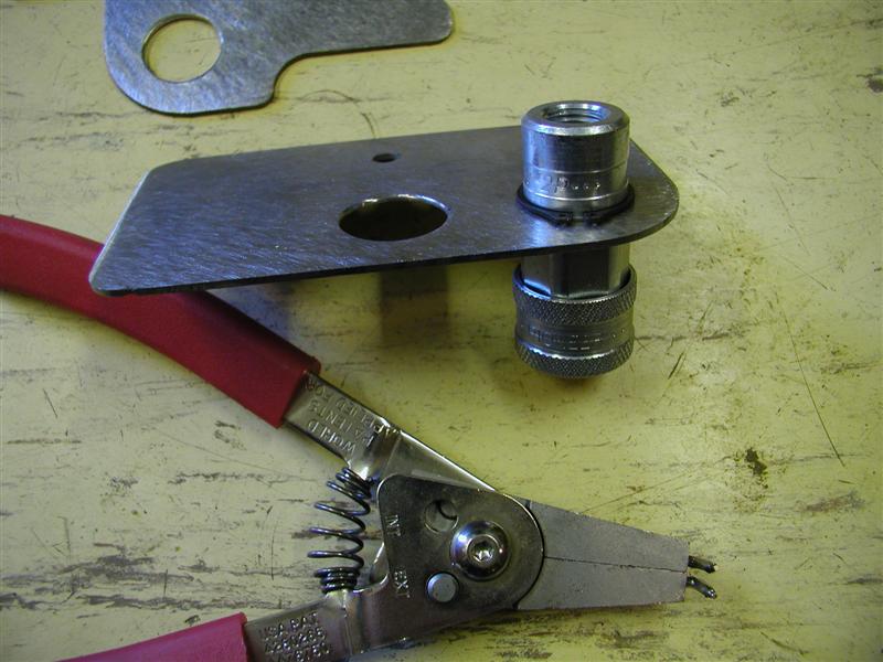

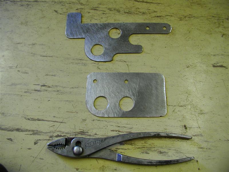

Here are the two coupler mounting panels I cut from stainless, before any bending or anything. The couplers have a snap ring groove on them, which holds them in a hole, if you can get the hole the right size.
Another pic shows one coupler snap ringed in there.

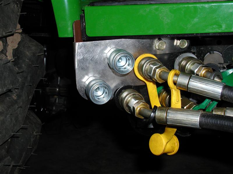

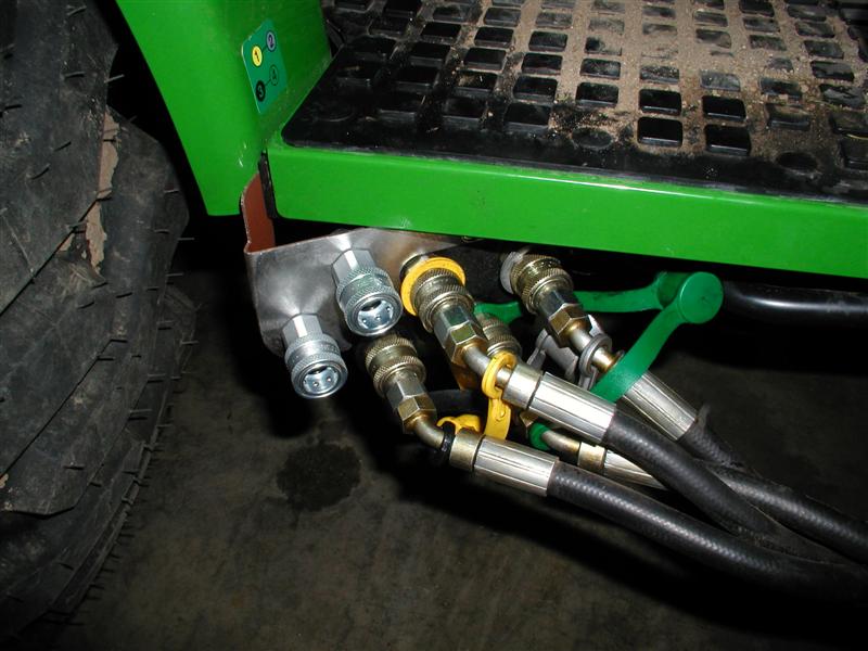

And here a couple pics showing the panels mounted in place.

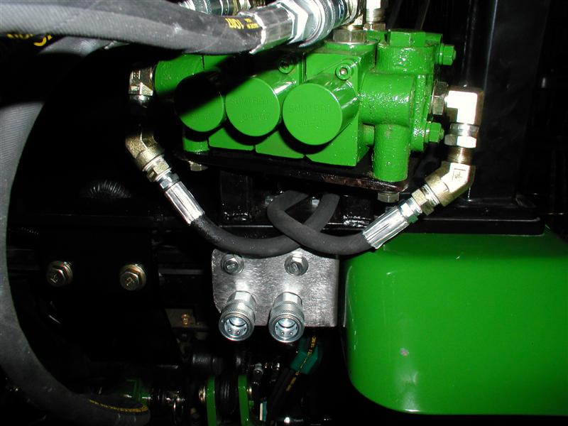

That's about it. I sent for a few more hoses and fittings to try making some routings better. And I still need to plumb to the remote coupler panels with hoses and T fittings, but none of that will be picture-worthy. Later I will plumb on the loader frame too, to carry this circuit to the loader frame cross-member, where I will have two more couplers, to allow powering my grapple cylinder. Thats all pretty boring hose-routing stuff though. So I am calling this project complete. I used the tractor for a bit of loader work this weekend and the auxillary valve location is good I feel. It is not in the way for normal operations, yet it is in nice position when you want to access it. I may add a small orifice restrictor to the sidelink circuit, as it seems too fast now. So, this thread is a wrap. Enjoy. Hopefully it can be found with a quick search when needed in the future.
