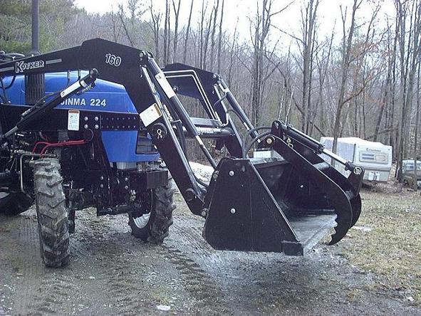

I gotta concur with Pine Ridge, that htatro does some nice work. My buddy Bill /forums/images/graemlins/wink.gif (F100panel) has one of those grapples from htatro and loves it. I'm convinced and going the same route. Here's a pic of Bill's machine with the grapple.

Does he do the bucket/tine part too? I'd like to have open ends and sifting capabilities...
   / All this grapple talk... #8
Andy is the kind of guy that can build anything that you might want him to. He has a CNC Plasma rig and knows how to use it. I sent him some sketches of parts that I needed and they cam back to me exactly as the drawings. Very cool stuff. /forums/images/graemlins/grin.gif

This may sound kinda wierd, but I'm thinking that a skeleton rock bucket with a grapple would be very versatile. The sideplates could be removeable as could the grapple. The only drawback I see would be that the tines are tied together vs a tine bucket/grapple that could penetrate a brush pile easily.
Did he make your entire grapple bucket setup?

If you can draw it Andy can make it. The only thing that he didn't cut for me was the 2 X 2 x 1/4' square tube and that was a cost saving issue since I already had the steel and the chop saw. In our case it was a grapple not a grapple bucket that he made.
