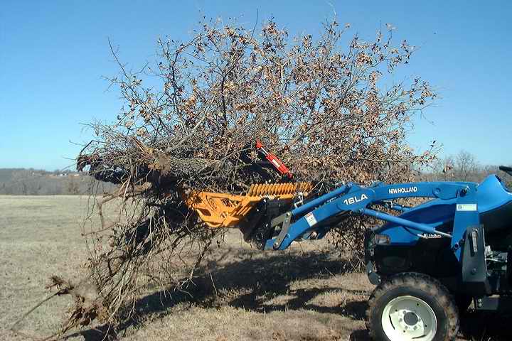

</font><font color="blue" class="small">( Do you have any idea what your grapple weighs, and how much it will lift? )</font>
My grapple and rock bucket combined weigh about 750 lb. In the attached picture, I had all I could lift without rear ballast. My loader was not even really challenged. Unless you try to lift a big, big log, you should not be overweight with any load you would want to carry. In my opinion, you make a mistake by attempting to get a full load every time. Just get the load you can best lift and come back for the next one. I had some huge loads and some small loads, but they were all easier to handle than any load without the grapple. /forums/images/graemlins/cool.gif

</font><font color="blue" class="small">( Which NH model do you have? Is your grapple a production unit? )</font>
My NH is a TC45D hydrostatic tractor with 45hp. The 16LA loader has a lift capacity of about 1 ton at the lift pins and around 3/4 ton at 20" out from the pins. With the extra weight of the grapple and rock bucket, I'm probably looking at a breakout force around a ton and a lift capacity of 1000-1250 lb depending on where the load is centered inside the bucket. In my experience, 1200 lb of loose brush is huge. If you have lots of dirt in it, you can reach that weight really fast, but my rock bucket sifts most of the loose soil out and my loads are almost exclusively brush.
I bought the grapple from Andy Tatro who has been mentioned many times in these forums and particularly by PineRidge who also has had the pleasure of working with Andy. This grapple is simple and less than $500 shipped to your door. You'll have to mount it, paint it (if you want), and plumb your own hoses. If you are the least bit of a DIY kind of person, Andy's grapple will work for you. He has lots of adds on ebay under the name "htatro". Here is a link to the details of my grapple project I posted in the Projects forum here on TBN. See what you think... /forums/images/graemlins/smile.gif

K-D That was my pic HarryGoodwrench ( thanks Harry! I 'm none to computer skilled & have trouble trying to put pic's here..) supplied of Mr. Tatro's standard grapple. As supplied I think it weighs about 100 pounds/I have no trouble carrying it around in my hands... Light enough & rolls far enough back to leave on all the time. I put snap couplers on the hydraulics & with the pins supplied it will on/off in about 2 minutes. As supplied it will latch on securely to a load heavier than my 3000 pound tractor can handle. I've had stumps in it so big on ground that looked reasonably level that when I raised the bucket high enough to put the stump in the 1 ton dump from the side one rear wheel came off the ground & I had to go around behind the truck where it was facing down the unnoticable grade to put it in the truck.. Picked up a whole middle 80's Ford 8 foot pick up box by "biting" into the side wall ( was headed to scrap ) & carried that around/loaded it effortlessly. The thing has an AMAZING ammount of bite..... For its weight the thing is VERY heavy duty/have NO concerns over twisting it up no matter what I bite into & I've had to re-enforce my Koyker bucket so as not to twist that up from the pressure the grapple can generate. Overall, for the $ I don't think you can beat the workmanship quality or the design of Tatro's grapples... Obviously I'm a 100% SATISFIED customer... I've also got one of Andy's backhoe thumbs on my Woods 650 backhoe. NICELY sized unit for a 6.5' or larger hoe.

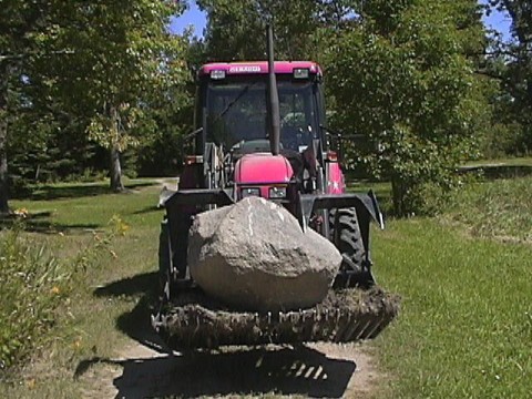

Another option for you to consider:
I looked at Virnig last year but ended up buying from Midsota. Albany MN & I-94. I severely abused it cleaning up a field & didn't fail. If you get one without the tines welded near the front unsupported tines may bend when picking up something round.
Pix is of a smaller gem I picked out of tha field last summer.
http://www.midsotamfg.com/featured.asp

Nice pic!
