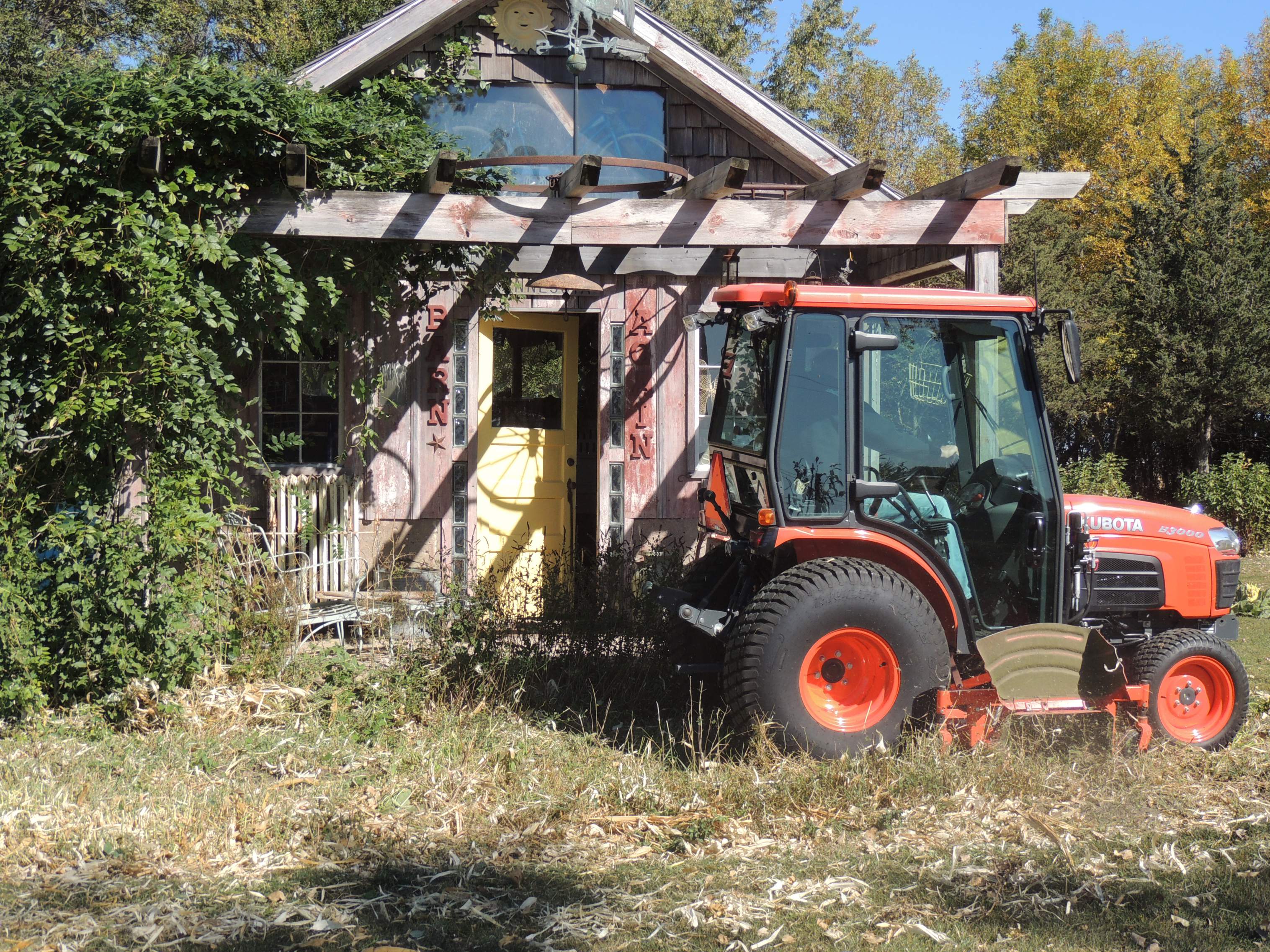

Maybe a steel building with some barnwood accents. I built a new wooden smaller new barn from out the ashes of my100 year old barn .
Just a thought
.<img src="http://www.tractorbynet.com/forums/attachment.php?attachmentid=297727"/>
That is a nice building for sure. I love wood but common sense side of me is driving me crazy saying "metal".
Just a thought
.View attachment 297727
That is pretty but all those vines/trees up against that wood is going to rot the wood.
